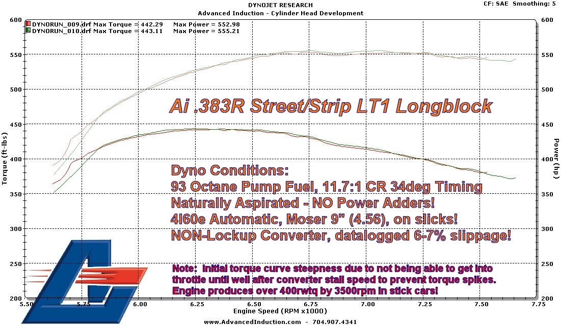

You need to look into things before you make posts like that. You clearly don't even know about the motor he is running. Here is a quote directly from the AI web site
Ai 383R Street/Strip Engine - 9.5's at 142mph NA on 93 octane! - Rick's old 383 was a little long in the tooth after having made thousands of passes under our CNC ported GM LT1's and becoming the fastest NA GM LT1 Head/Intake F-body. To continue to utilize Rick's ability to collect real world data we chose to put a new offering through the wringer as a weekly racer - one of our Ai 383R LT1 longblocks. This is truly a Street/Strip engine. To ensure streetability it is only 11.7:1 static compression. Paired with a moderate cam that exhibits excellent drivability and peaks at only 7000rpm it'll sit in traffic or decimate tires with over 530rwhp on tap. Using our 215cc CNC'd TFS LT1 heads & LT1 Pro-Ram the car has run consistent 9.6's all summer in average 1400-2200ft DA.
However, once the weather dipped below 1000ft DA the additional power has completely upset Rick's finely adjusted setup. On pump fuel with 10deg of timing pulled out the car is out of control - breaking wheelie bars, bending suspension mounts, and being unruly in general.
Nothing that peaks at 7,000 rpm is going to eat valve springs. What suggests that it would overheat? It is a street/strip motor. Not a race motor. Why all the hate? I believe some of you just don't like them because they are fast??
