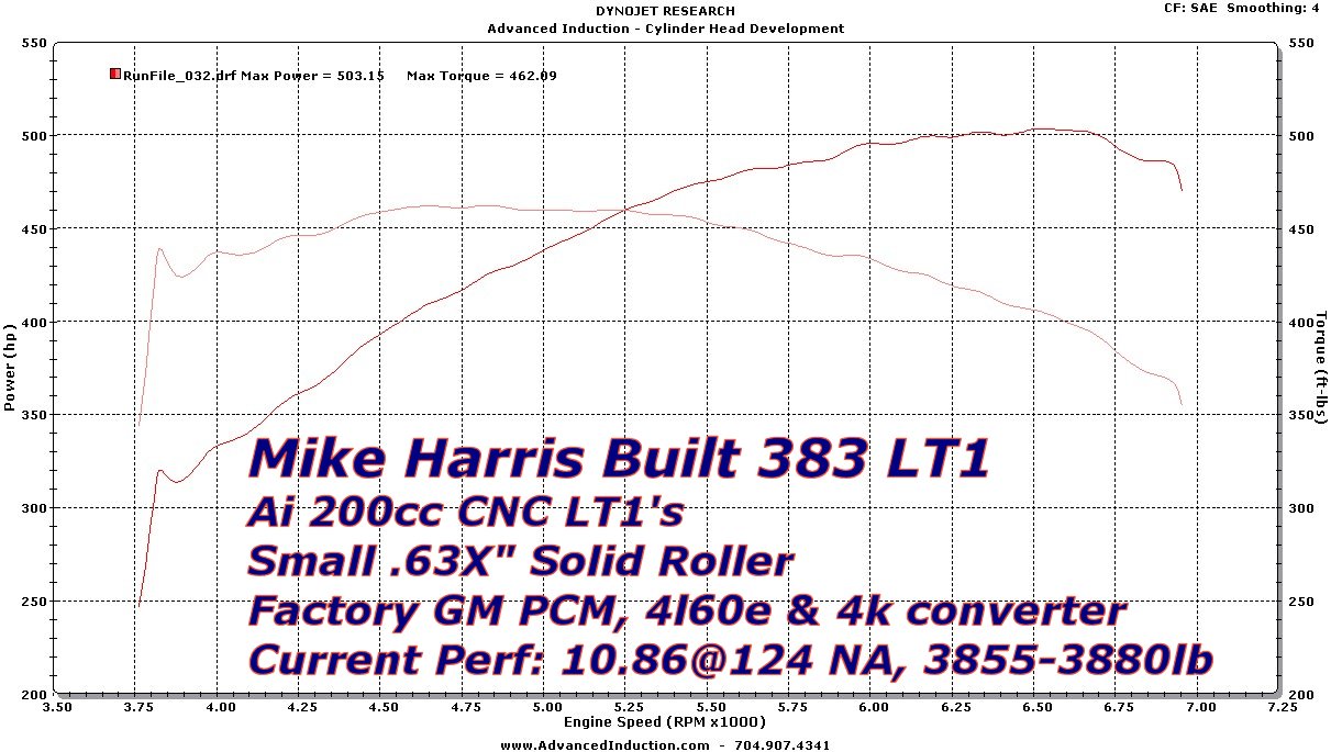

I think your car would compare more favorably to someone like Mike Harris' impala ss. Like you, he refuses to ruin a nice car. He runs the factory PCM, full stock leather interior, near 3900lb scaled raceweight, and approximately the same compression as you. Of course he only runs our 200cc CNC'd GM LT1's, a GM LT1 manifold, and a 245deg .635" lift cam vs. your much larger converted RHS heads, significantly larger cam, and converted super victor manifold. With the impala being more difficult to get down the track, and heavier, he has done very well. Here is his old dyno sheet:
http://www.advancedinduction.com/Dyno/MHImpyDyno.jpg
I believe his current best is also 10.5's @ 125-126mph. Of course it was likely run in average air up in Ohio where he runs. The biggest difference between the fast guys and the average guys, barring budget, is work. You will never compete with the guys who run their cars as often as you post.

The car your comparing yours to in the link weighs 3100 lbs, ITS GUTTED!
SO IS THIS CAR A REAL STREETCAR OR ONE THATS LIKE ABARES?
