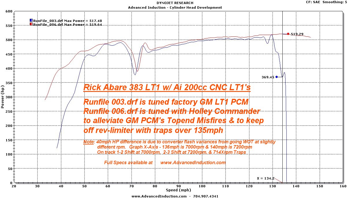

Originally Posted by Puck
I agree.
Stock heads wont get you 500rwhp through a stalled A4 no matter how many cubes or which cam you use.
http://www.advancedinduction.com/dyn...906GMvsHFI.jpg
500rwhp can and has been done with ported stock castings.
The budget to do so is WAY over $3000.
I think the OP needs to know Summit is NOT the endall source for parts, they are the walmart of parts houses, they have a LOT of what you need but sometimes you need something more specialized.
Ricks car does not even remotely fit the description or goal of the OP.
I still am firm that with a stock shortblock like the OP stated, and the rpm limit implied from stock cube/stock computer, there is no way you will see 500rwhp through a stalled auto on ported stockers...period.
A 7.2K rpm 383 with some of the best CNC'd stockers around a huge solid roller? Sure. A 6300rpm 350 and an off the shelf cam? No chance in hell.

i agree, using ricks car as an example of possible results is ridiculous
You KNEW it was coming
