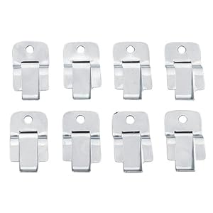

Hi, im trying to adjust my 1.6ratio compcams rocker arms to stop the clattering they are making. I bought a set of mr gasket rocker arm clip oil deflectors and i dont understand how they are supposed to clip on. Has anyone used these? i need to adjust the rocker arms while the car is running.
heres a pic of my rocker arms -
Probably wont work on those rockers. They are much thicker than a stamped steel rocker arm. You really don't need them anyways. Your car WILL NOT shoot oil across the room like you might think it will. At an idle it will just dribble oil. An easy way to do it is to do one side at a time, and to slightly jack up the car on that side so the oil can't pour over the side of the cylinder head and onto the headers. It should only take you 2-3 minutes to do one side anyways.
The usual method is to set them with the engine running. Loosen the adjusting nut until the lifter "clatters, then tighten the nut slowly until the clatter stops. (this is assuming you have hydraulic lifters) Then turn the nut another half a turn. That's what you refer to as the "sound" method, a method that's been employed since the 50s.
However, if that method doesn't appeal to you, then the clips you bought won't do a damned thing for you, as they're desiged to deflect the oil while you're adjusting the valves, while the engine is running, and you're listening for the lifters to clatter, so you can then turn them down a half turn....(see "SOUND METHOD" above)
