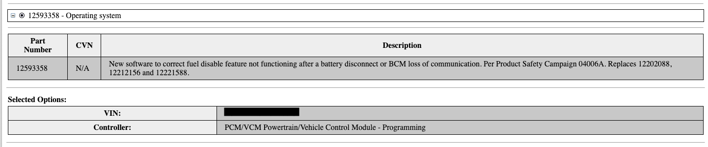

Yes a CVN does show up. You can go on GM website and register for free and see what the stock CVN is supposed to be. https://www.acdelcotds.com/subscriptions
Some of the early cars, they don't have a record of the correct CVN because of the rolling changes. Just because it displays N/A doesn't mean it won't display one. It just means that GM doesn't have a record of the correct CVN. After around 2005 or 2006 they started keeping better records.

Yes. But like the screenshot I posted above the CVN may display N/A on the web site meaning they didn't document it properly. So no way to tell if it's a factory CVN or if it's been modified.
