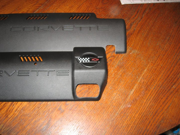

Busted out the dremel and modified my fuel rail covers to fit. Not sure its right, but some random internet guide said these were the spots to grind. I am not completely convinced I am even going to keep them on, but we will see what it looks like down the road.
