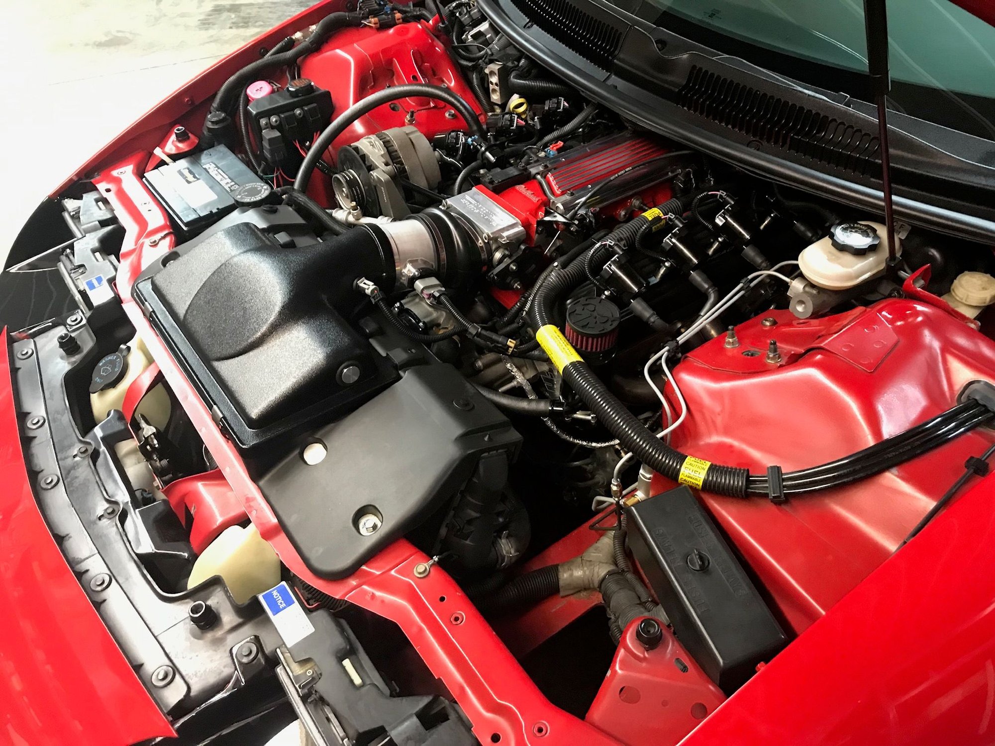

I upgraded to a 85mm Delphi MAF that was only $70 bucks shipped. I figured I would share this in my thread and post a link with pics of the difference between stock and the AF10056 Delphi unit. Here is the link to the post I made in the pcm-diagnostics-tuning section.

How well did the LS1 air lid fit the VFN hood? Was there alot of trimming to get it to fit?
Old Nov 20, 2014 | 11:35 AM
CamOnlyJabroni's Avatar
Joined: Sep 2014
Posts: 321
Likes: 88
From: Fort Wayne, IN
When you order the hood, ask them to do their revised trimming on the hood for the LS1 air lid. When they build the hood, they trim out some of the original mold to "help" the air lid fit. I still had to trim on the under side of the LS1 radiator support to get it to clear the hood. I also made new holes in the radiator support. Doing this allowed me to mount the air lid closer to the engine and help clear the hood. After those steps were done it fit fine and have not had a problem. Very happy with the purchase.

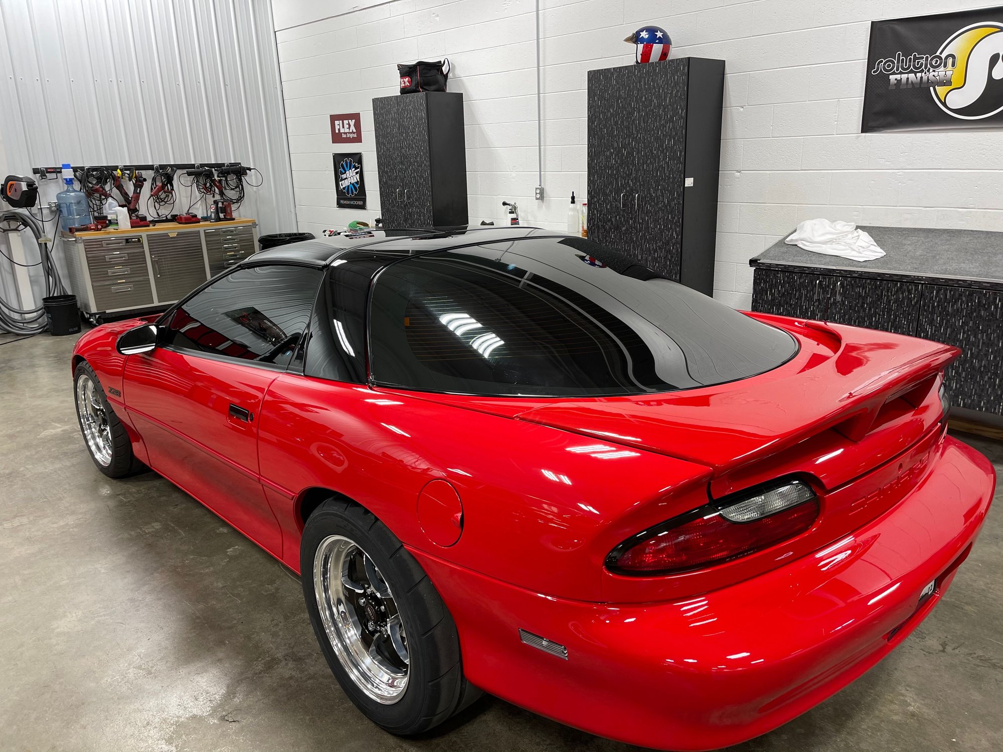

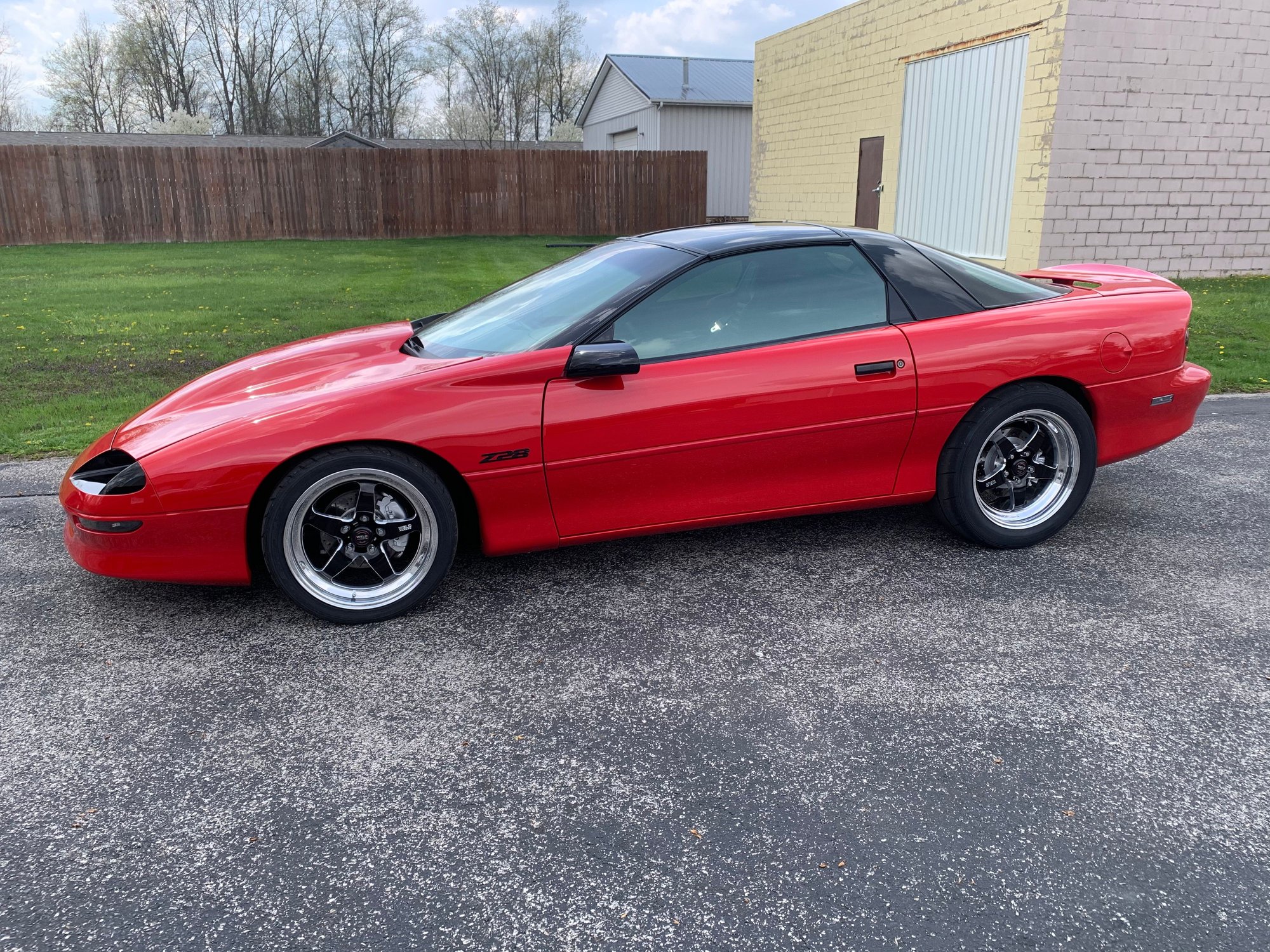

Car has slowly gotten more and more work done over the years. It’s now a Cam Motion LLSR solid roller along with a bunch of other mods.
Old Jan 28, 2020 | 07:05 PM
StealthFormula's Avatar
iTrader: (35)
Joined: Apr 2005
Posts: 4,798
Likes: 54
From: Skippack, PA
Car looks awesome, very clean, well done! Wheels are nice, which are they? I’m a Cam Motion fan, I didn’t realize they could cut a bumpstick for an LT1 so that is very good to know.

Old Feb 1, 2020 | 11:02 AM
Joined: Sep 2014
Posts: 321
Likes: 88
Thanks. They are Forgestar D5’s. 17x5 and 15x10’s.
Originally Posted by OutlawV2
Sooooo clean. I'm not a fan of Red but that car is clean asf...
Thanks.
Originally Posted by Vicious95Z28
Car looks man! How are you liking the solid roller?
It’s nasty. I like it. Rev limiter set at 7500. AFR heads and a 24x conversion changed the cars life.

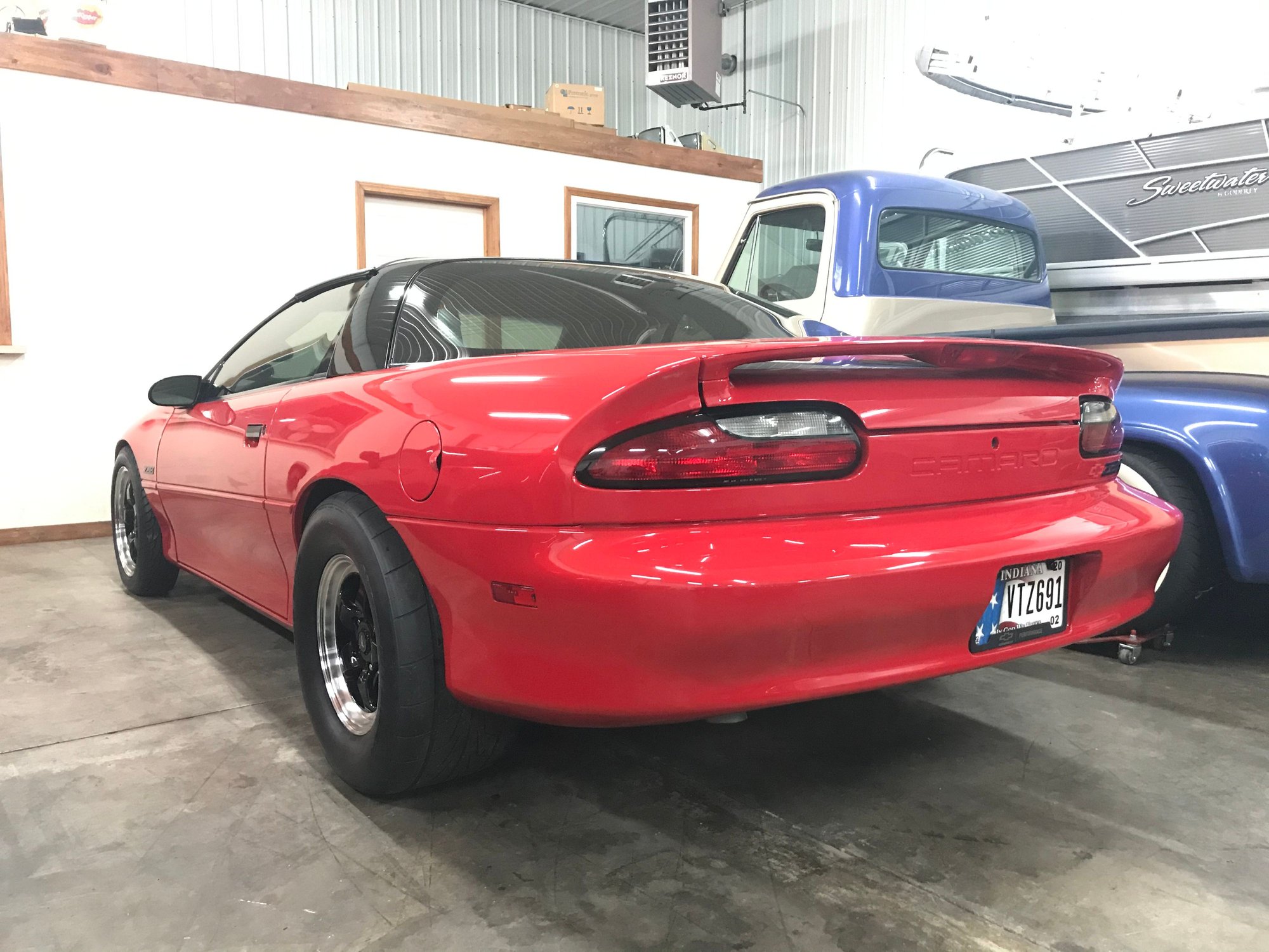

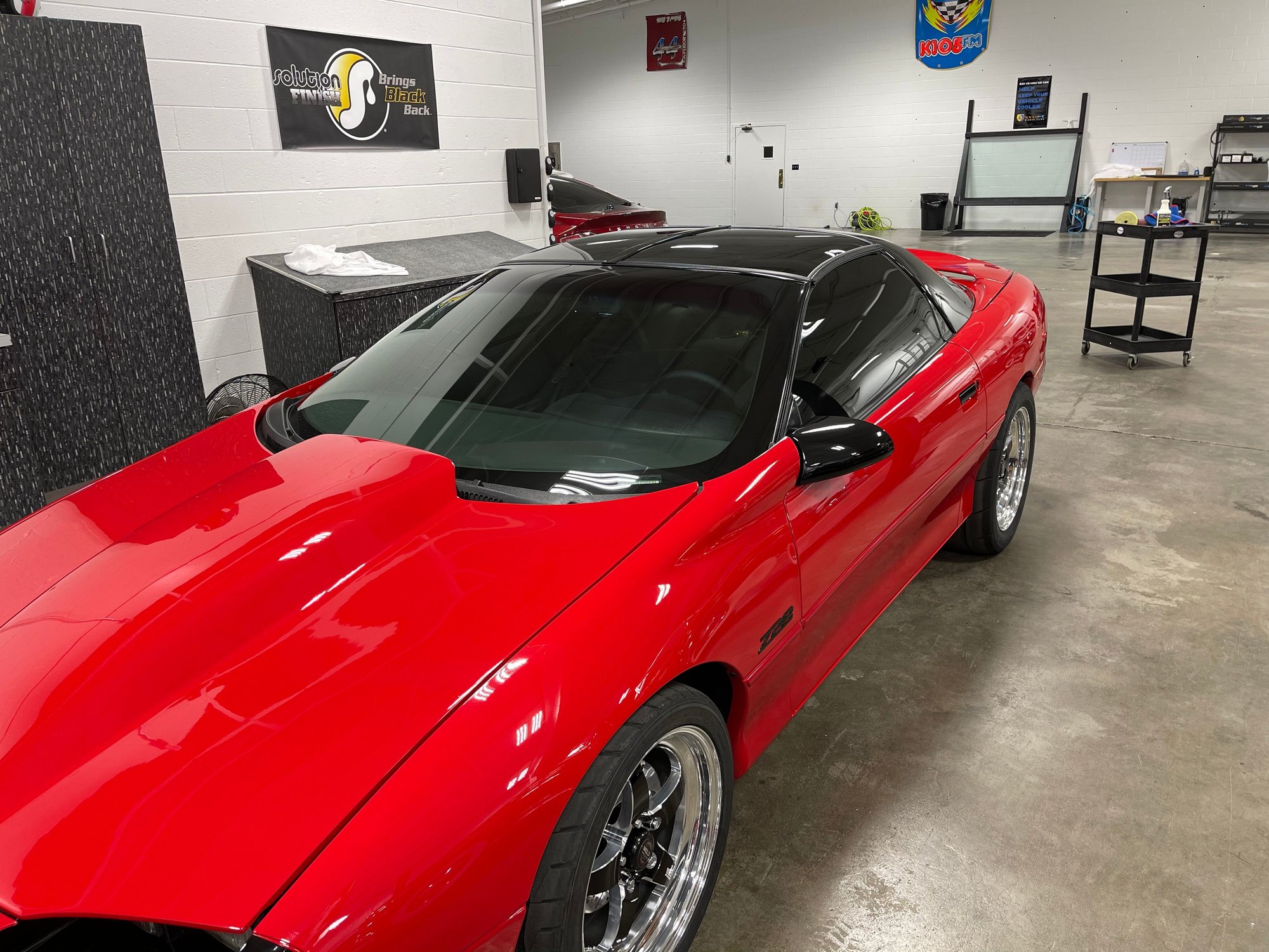

Recently went with some 18x7/18x11 Weld S71’s, put a 98-02 SS spoiler on and also got the car ceramic coated with black window tint. Working on pulling some more weight out of the car then putting a dedicated nitrous setup on.
