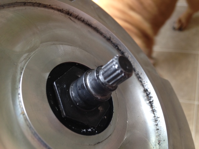

So we completely reset the timing on the cam and the opti. But still won't start it pops out the intake still but I'm not sure y. The little spline that alignes the opti is not there on my mad opti so I can't put it in a million different ways. So I used a multi meter to ohm the cap and find #1 inside the cap to get me close but still won't start. I have spark I have fuel what gives? Call911 or any body and Any ideas?

Uhhh....you sure about that? My MSD opti certainly does have the spline to align the opti in it's one and only position. It's such a PITA to align that damn thing It should slide in nice and easy once you align it just perfect. Take a very close look, it is kinda hard to see the spline on the MSD driveshaft vs the stock opti. Maybe recheck the wire routing? Maybe a couple wires got crossed messing with the opti? You could just have a bad opti...it happens, has this opti ever worked? You may have to test out a different opti to eliminate it.

its not there lol its gone I can put it on in any position. plug wires are right all the harness is right.. and it worked great before I did the motor swap. any one wanna loan me a good opti to test? that's what im afraid of.. I just got laid off too.. so no funds for one. I have a 96 intake if anyone want to trade.

the shaft has to be keyed. its a tiny spline but it has to be there unless it was chiseled off?

If you know that opti works, I'd call MSD and ask about a replacement driveshaft for the opti, it can't be more than a few dollars.

Its not there lol dont look like it was chiseled off. I've been on the phone with msd and they want 113 $ to test it and repair it but it will take 2-3 weeks to get it back,

Pics?

FWIW....this is what the MSD spline SHOULD look like, it pretty much just looks like two of the teeth that have some extra material between them, somebody must have manhandled yours in the hole or something and stripped it!

The good news is it sounds like we found the problem. If you aren't able to align the opti, there's no way it would start or run properly. At first I thought you were saying there was no pin on the end of the cam to go into the back of the opti. The 93 LT1's had these with the non vented style opti's. In 94 they did away with the alignment pin on the cam and the vented opti style became available. But this doesn't sound like what you are talking about. First make sure you have the proper style opti for the motor, then figure out if yours needs repair. You may not have the cash right now, but at least knowing what you need is really more than half the battle.
