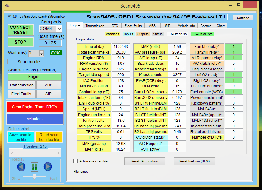

Quick update, i've only had a bit of time to inspect wiring (broke a tranny mount, which took precedence), but it so far all looks good. Just on a long shot, here's some screenshots of the car hot and cold, does anyone see anything in all this that could explain the fans going on? I'm under the impression that coolant temp is the single variable that should control it...
Engine Cold
Engine Warm

so the PCM is telling the fans to be on all the time. I am kinda stumped here. All the signals would say no fans, but the fans are ON...did you try just swapping the relays?
Shbox would know, but I am confident that the ECU looks at the same sensor that displays the temp on the gauge/ecu for fan operation right? I always forget.
In this case, maybe the ECU is shot? Probably not a relay issue, because if it was a bad relay, the ECU would say NO FANS and fans would be on anyway

First thing i tried was putting new relays in, i can even switch the fans on and off from the pictured software, so the PCM correctly controls them...but also thinks they need to be on. I'm starting to lean towards the PCM as well, but don't really want to replace it unless absolutely necessary.
It seems strange though that everything else runs as it should, but just the fans are messed up. If the PCM went bad, i would think it would cause a whole mess of problems...

Looking at the Scan 9495 screen shots i posted above, my A/C refrigerant pressure is pretty much always above 180 psi...This looks like it could be a possible root cause, can someone please confirm that this switches the fans on? It'd be nice to not have to swap my PCM...perhaps i just need a new pressure sensor or to bleed off some A/C pressure. Anyone chime in on what my A/C pressure should be?

Yeah, the sensor is ok i'm pretty sure, the temp the PCM and gauge are showing agree, and it seems like ~185 would be spot on for where the temp would be with the t-stat open and the fans going all the time.
I have another thought though, my outside air blows curiously cold (like as cold as when i have A/C turned on) so i never use the A/C. There's a bit of noise that comes from the area of the compressor that could be the clutch...if the clutch isn't fully disengaging and the A/C is running all the time (hence the weirdly cool vent temps) would that raise the A/C pressure possibly resulting in fans always running?...I posted just above about the possibility of excessive A/C pressure switching fans on...let me know what you think guys, i should be getting a PCM to swap in soon, so that'll be another thing to strike from the possible cause list.
