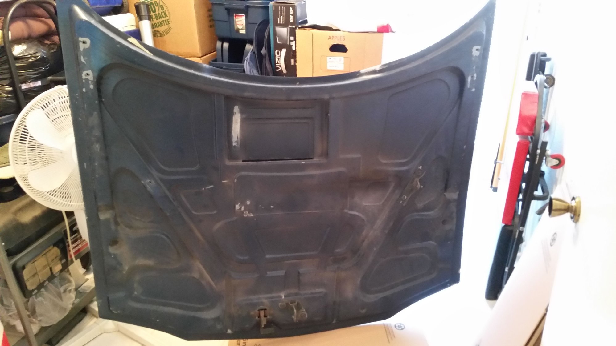

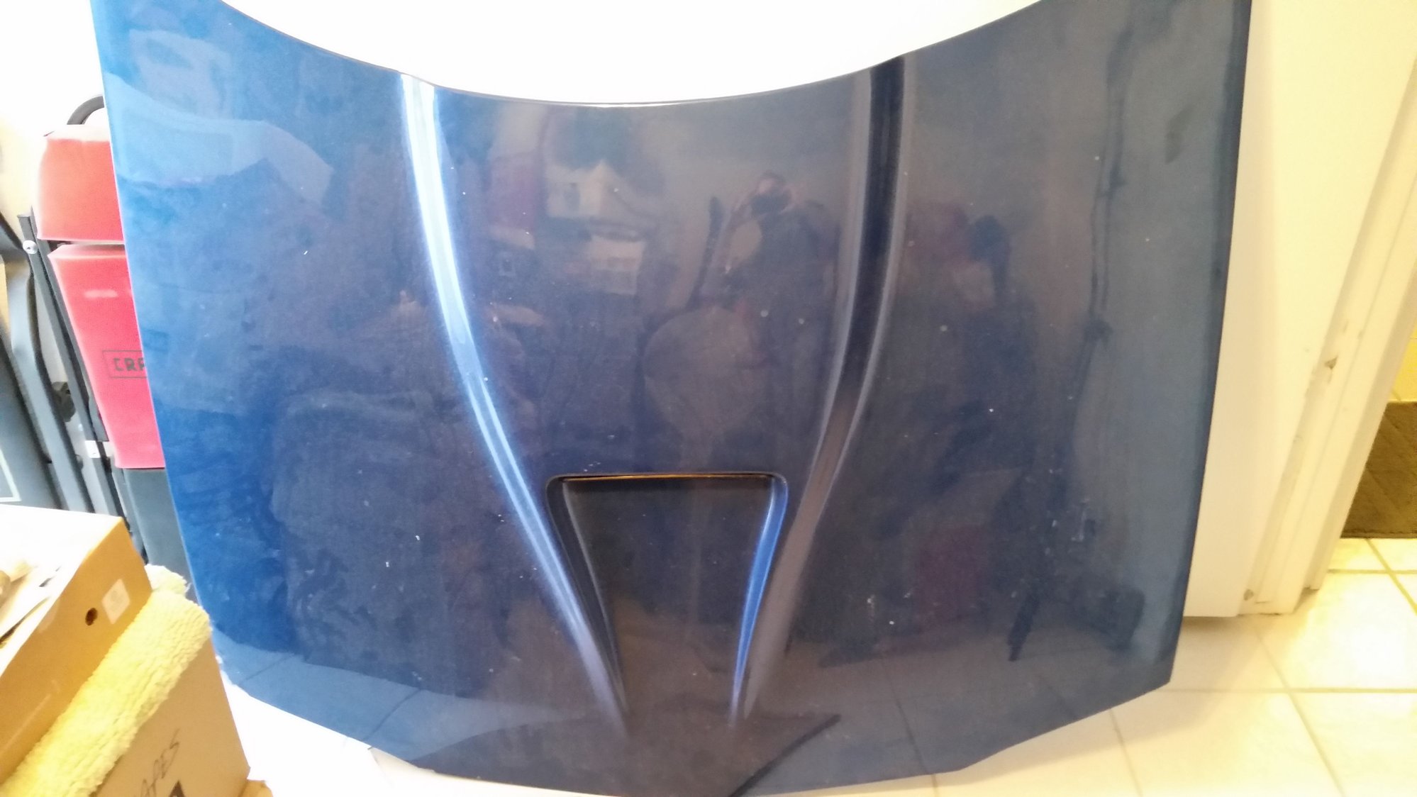

I came across a 96 Camaro SS hood and I'm trying to determine if it's an original SLP/GM hood. I can't find a part number on it or "made in canada" but it has crush points so I'm not sure. Does anyone have any pics of the bottom and a close up of the scoop opening on a confirmed original hood?

Pic of the hood you looked at?

I'll look at my hood tomorrow to see if there's anything that stands out. The aftermarket hoods I've seen the cowl is taller and wider than a true SS hood.

The air box it came with is obviously not a gm/slp. I just really hope the hood is

Here's the bottom side of mine:
I'd say yours is a close replica. Is it a steel hood or composite?

It's fiberglass. I thought the slp hoods were heavier than aftermarket ones so I was surprised at how light it is

You have any pics of the scoop opening without the grill in it?

If it is fiberglass, it isn't authentic. They were all SMC.
