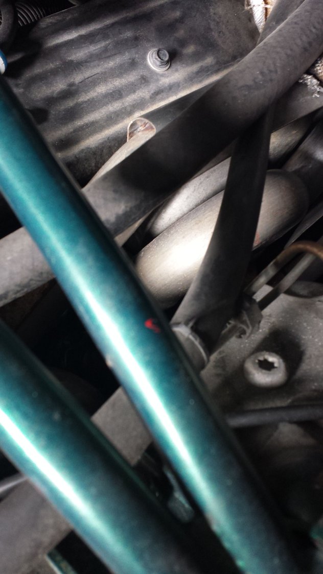

Originally Posted by 3Whips
No, Iowa lol. And I'm not a chevy guy i couldn't tell you if they're stock manifolds.
Wat. 99.9999999% of manifolds are cast. This has nothing to do with Chevy.
Do they look like this?
Nope they do not, and I never thought the headers were stock until you guys kept going on about them. I'll post a pic of them soon.

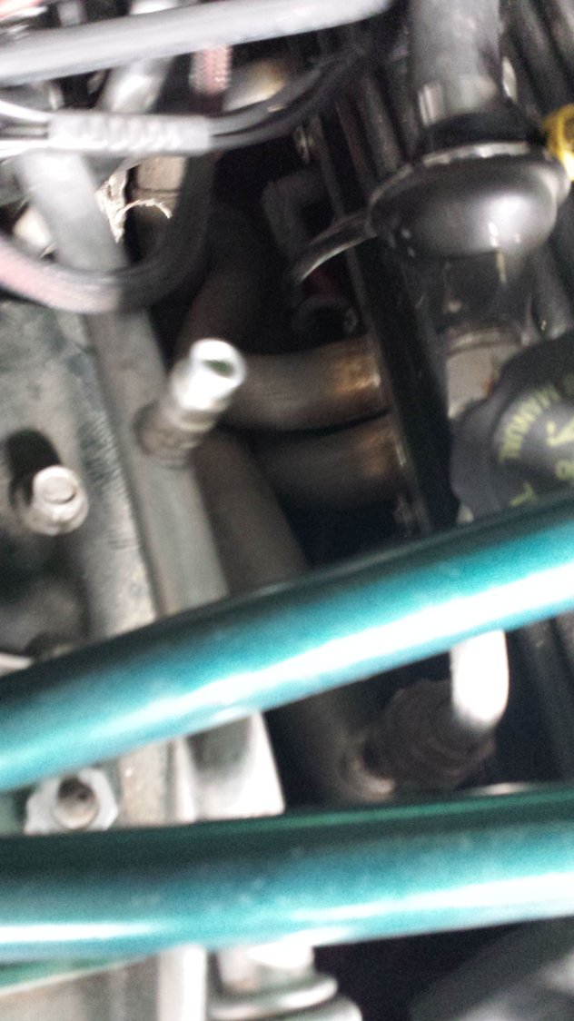

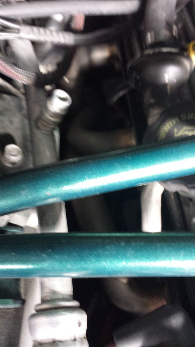

From: Iowa
Ya don't think they're stock
Sorry bad picture doesn't show all of it

It wouldn't make sense for this guy to build this all up and not change out the headers.
Old Oct 17, 2014 | 01:27 PM
  #37
ahritchie's Avatar
Joined: May 2010
Posts: 2,241
From: Charlotte NC
You are correct...those ARE headers, not manifolds upon closer inspection. You would be surprised at some of the things people do that don't make any sense at all around here....Like a Mustang/Mopar lover buying a LT1 Camaro of all things! Or this one time some crazy dude started posting on a GM based forum claiming "Ford is better".

Alex94TAGT's Avatar
Joined: Feb 2005
Posts: 384
Those are indeed aftermarket headers -- not stock exhaust manifolds. They just happen to retain the factory emissions equipment (secondary air injection at least), which isn't surprising on a California-based car. They should be fine.
Can you see any model numbers on the Paxton head unit? 8~9psi on a 383 isn't shabby for an older Paxton. If I knew the pulley sizes and step-up ratio, we could calculate the impeller speed to see if you're overspinning it at all, but it's probably not a terrible idea to rebuild it with fresh bearings either way.
Despite not knowing all of the specifics, I'd run 91 (premium) at minimum, preferably higher if available. Don't want to run cheap fuel, being non-intercooled. Your compression, final ignition timing and IATs will have a large effect on when detonation hits.
