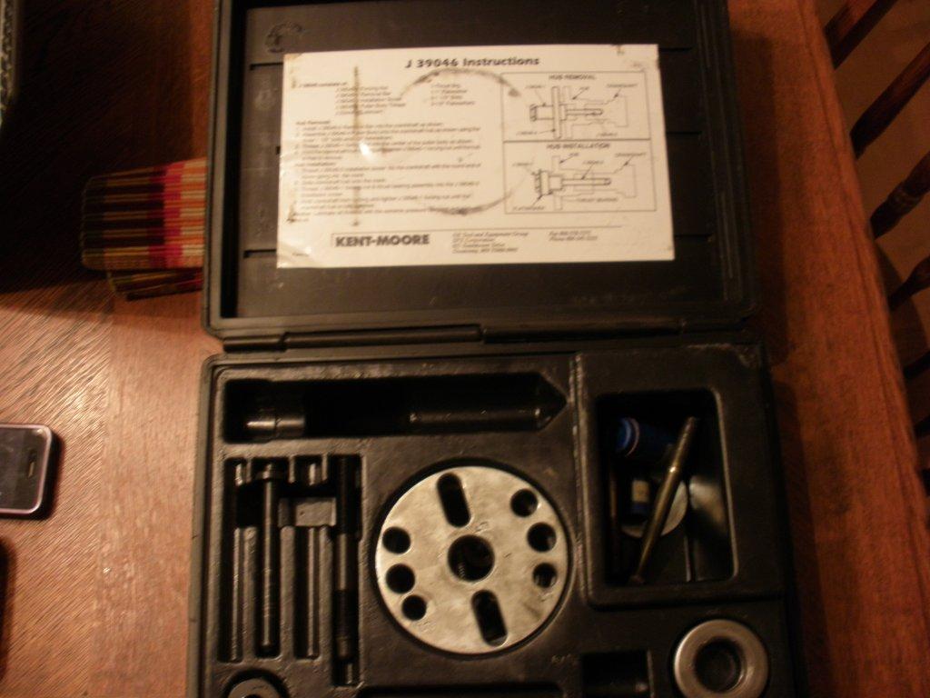

if you can find one of these KM tools on ebay....plug & play on R&R of hub
Attached Thumbnails Crank hub puller-km-lt1-puller.jpg   Crank hub puller-km-puller.jpg

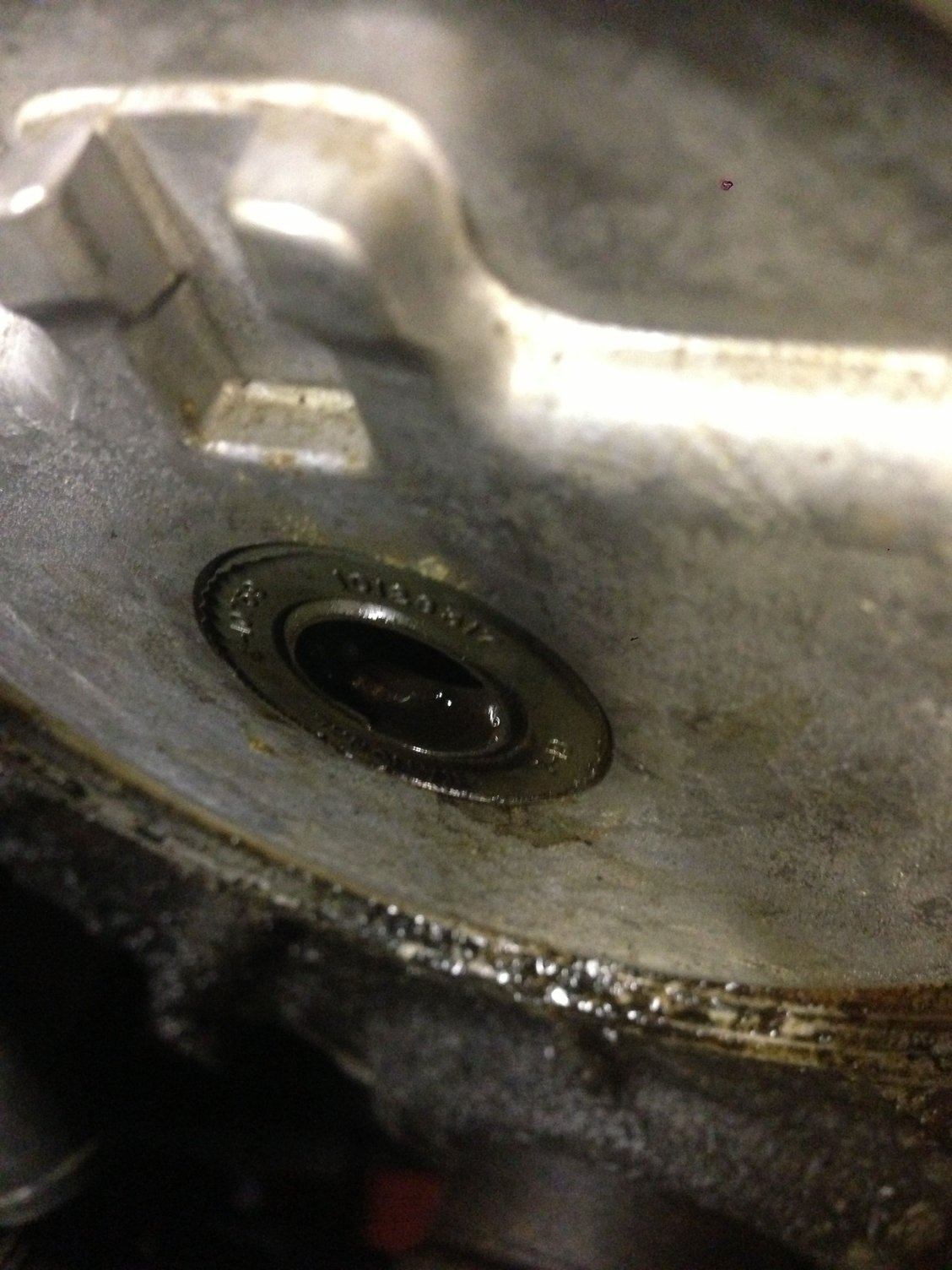

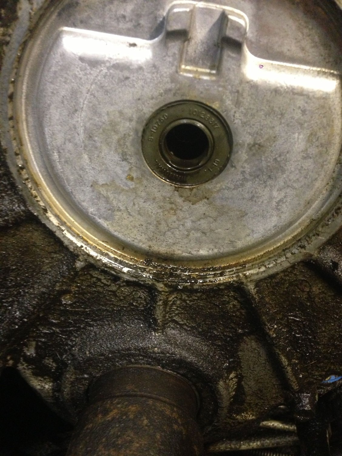

I've now broken 3 pullers.
First was Advance Auto lifetime warranty hub puller, stripped the puller screw twice.
Second was advance auto 3 jaw puller. Had a grade 8 bolt in the hub, and it managed to crush the puller tip into the puller screw.
Tried another but removed the tip, got the pulley off, but mushroomed the tip of the puller trying to get the hub off.
Good news is I think it was the opti seal the whole time. The lip is bent down and there's oil below it, looks like it dripped from the opti to the crank hub then got whipped everywhere.
I think I am going to try 1 more puller, and if I break that one I'm going to just do the opti and WP seals and put it back together until I put in the new motor.
