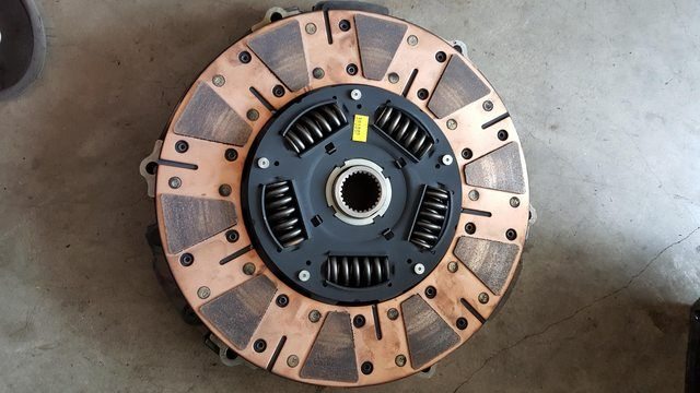

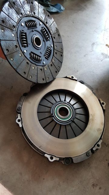

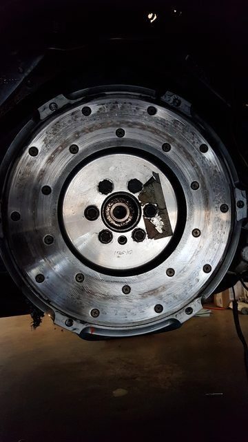

Flywheel looks like ****..
heres some pics of the assembly.
Old Aug 17, 2015 | 11:37 PM
ACE1252's Avatar
Joined: Jun 2013
Posts: 853
Likes: 32
From: Kernersville, NC
Bearing looks fine to me too.
My flywheel looks worse, but I've got quite a few more miles on my setup. Interesting that is the "puck" side of the clutch disk shows the most heat on the surfaces.
Any indications the clutch is slipping?
Are you grinding gears when shifting?
Where/When are you feeling the vibrations?
Do the vibrations get worse as rpm increases?
Can you be more specific on the clunking noise?
Does the clutch pedal engage like stock(how high off the floor when it grabs/disengages)?

from this side of the internet you clutch, TO bearing, PP, FW look fine. Can't "see" the inside part of pilot bearing but if the roller needles are not compromised and the tip of input shaft look fine all should be good to go regarding the clutch part
yeah it is weird TO bearing has that "off center" rotation deal but they are all that way
Just take some emery cloth if you want and clean up FW & disc surfaces or just put it all back in
if you have vibration or clunking I would look closer at tranny & motor mount...and possible grounding at some point as a result of engine/tranny movement
