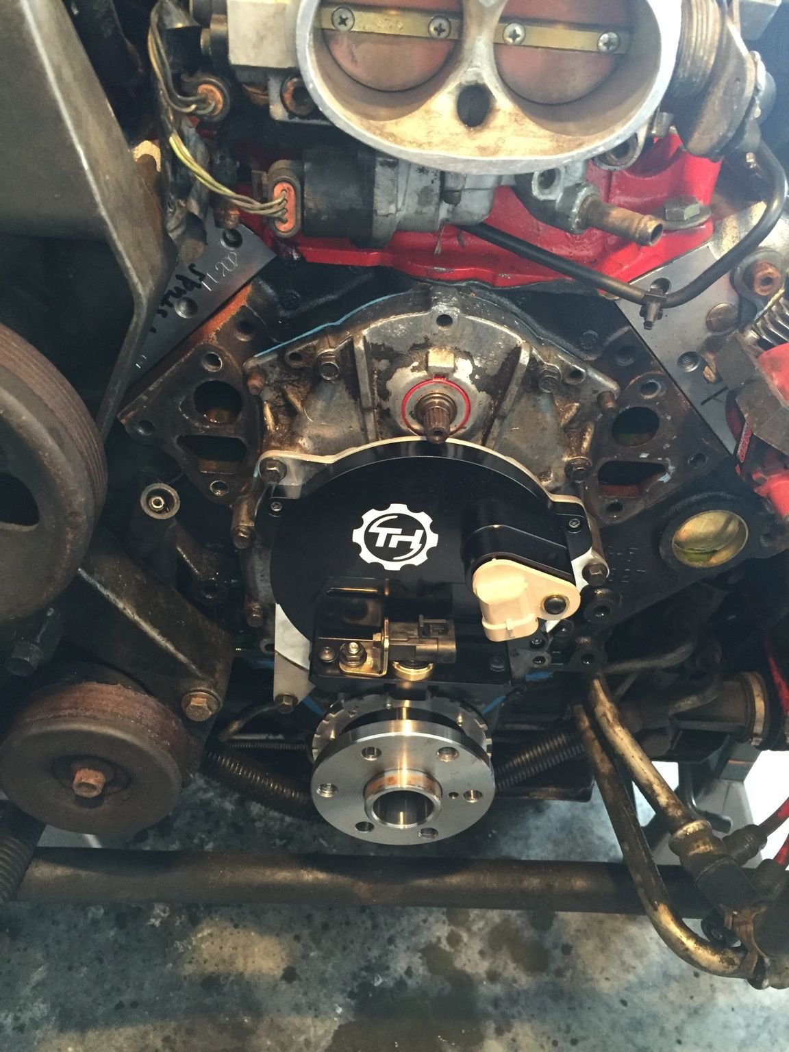

Originally Posted by Chopstix
Took delivery of my Torqhead 24x Link Essentials kit today..all I can say is Wow, very impressed with the components.
The Essential kit ships with the following:
24xLink Sensing unit with adjustable crank sensor mount
Crank hub Assy wih 24x External Reluctor
24xLink PCM (Gen 3 411' PCM, plug and play for LTx Engines). Comes with C3 Add-on Harness.
AC Delco OEM 24x Crank Sensor
AC Delco OEM 1x Cam Sensor
Installation Instructions
OBD2 Port (Supplied if choosing '94-95' Only)
Water pump gaskets
I added the Torqhead coil brackets for a cleaner installation.
I will be supplying:
Ignition Coils
Spark plug wires
An Engine Tune
Please visit torqhead.com for more details.
Can someone please tell me how to tune this system or who to take it to. I've been emailing places and there anwser is..." We only tune ls1s". I say "I know....it is an LS1 computer, but they don't bother reading about the Torqhead system!!!!. What did you all do? Any good place in Virginia? Do I get a lab top and try to tune myself?

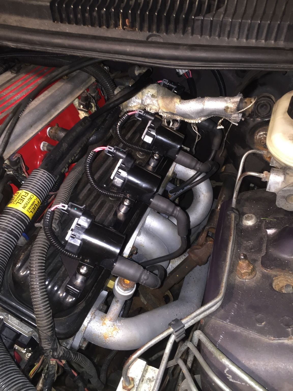

Originally Posted by 9t4zee28
Here is mine in its current state...
I
Did you custom make the ignition coil brackets? They look nice! If you did not make them, did they come with the kit?

Originally Posted by Alex-chevy
I
That's the TorqHead Kit..... http://www.torqhead.com/index.html
