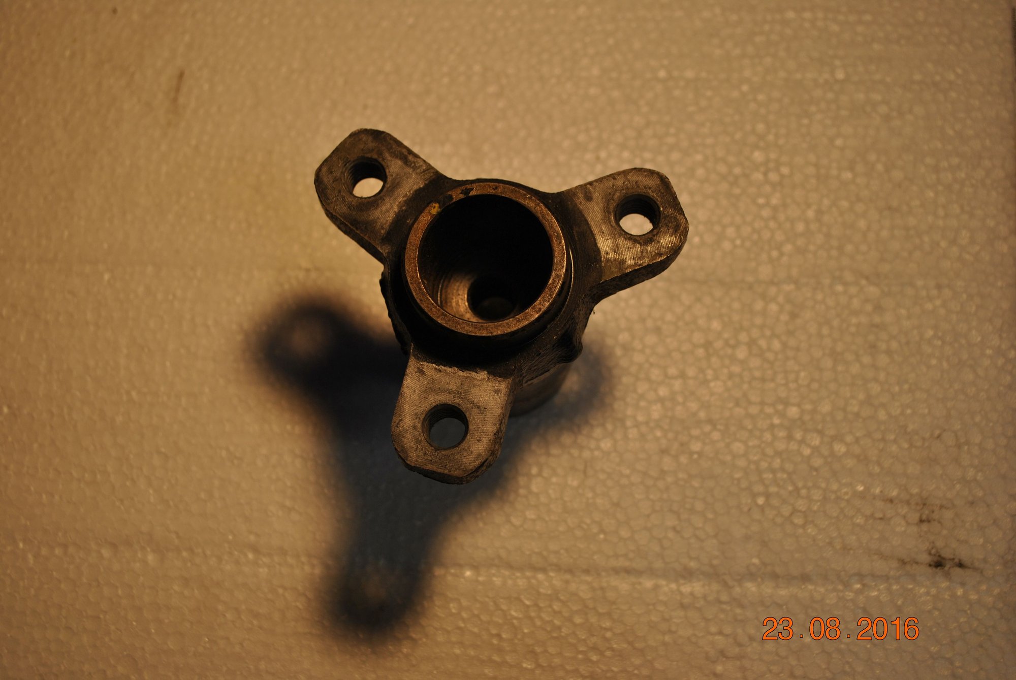

The "trick" to removing an LT1 balancer hub, is that you need to understand it's not like an older style balancer, where the center hub area was "wide open", and a conventional puller could press against the crank. The LT1 hub has only a small hole in it's center, for the retaining bolt to pass through.
What I did, was use a piece of threaded rod, like I was going to press the hub on, BUT slid a "3 jaw" puller over the rod, locked it in with a hex nut, and threaded 3 bolts through the puller, into the hub. I then used the hex nut that I had threaded on to the rod first, to draw the pulled back, which, in turn, drew the hub off the crank.
Note the small hole in the hub, below.
