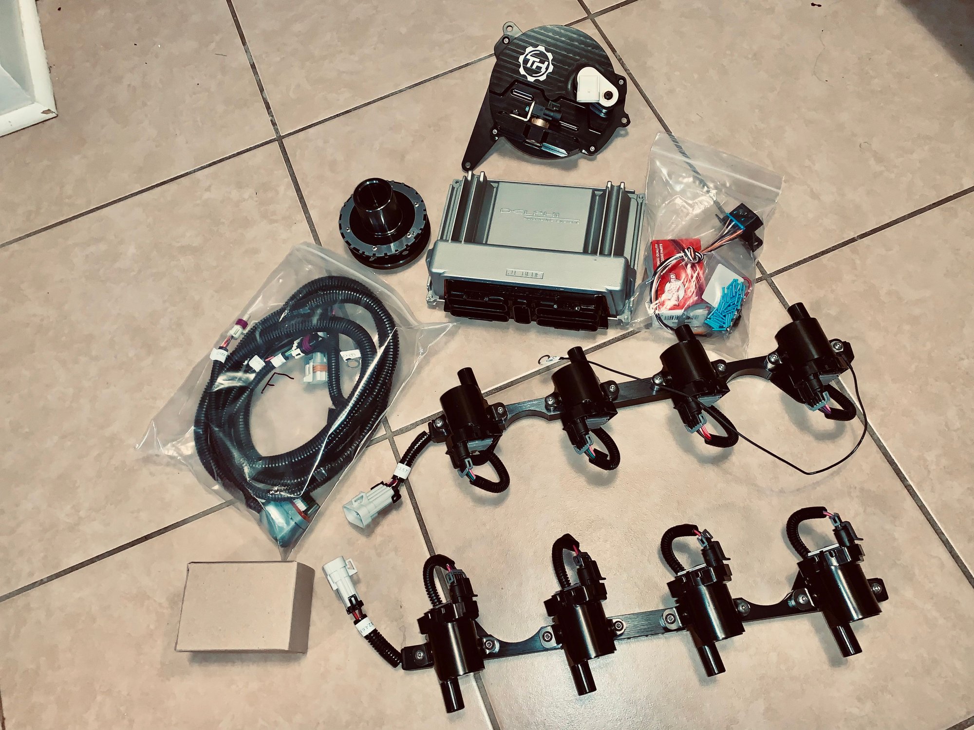

Five and a half years later I FINALLY decided to get a kit lol. Going to put it on my 383 that’s been sitting on the engine stand for 5 years lol
