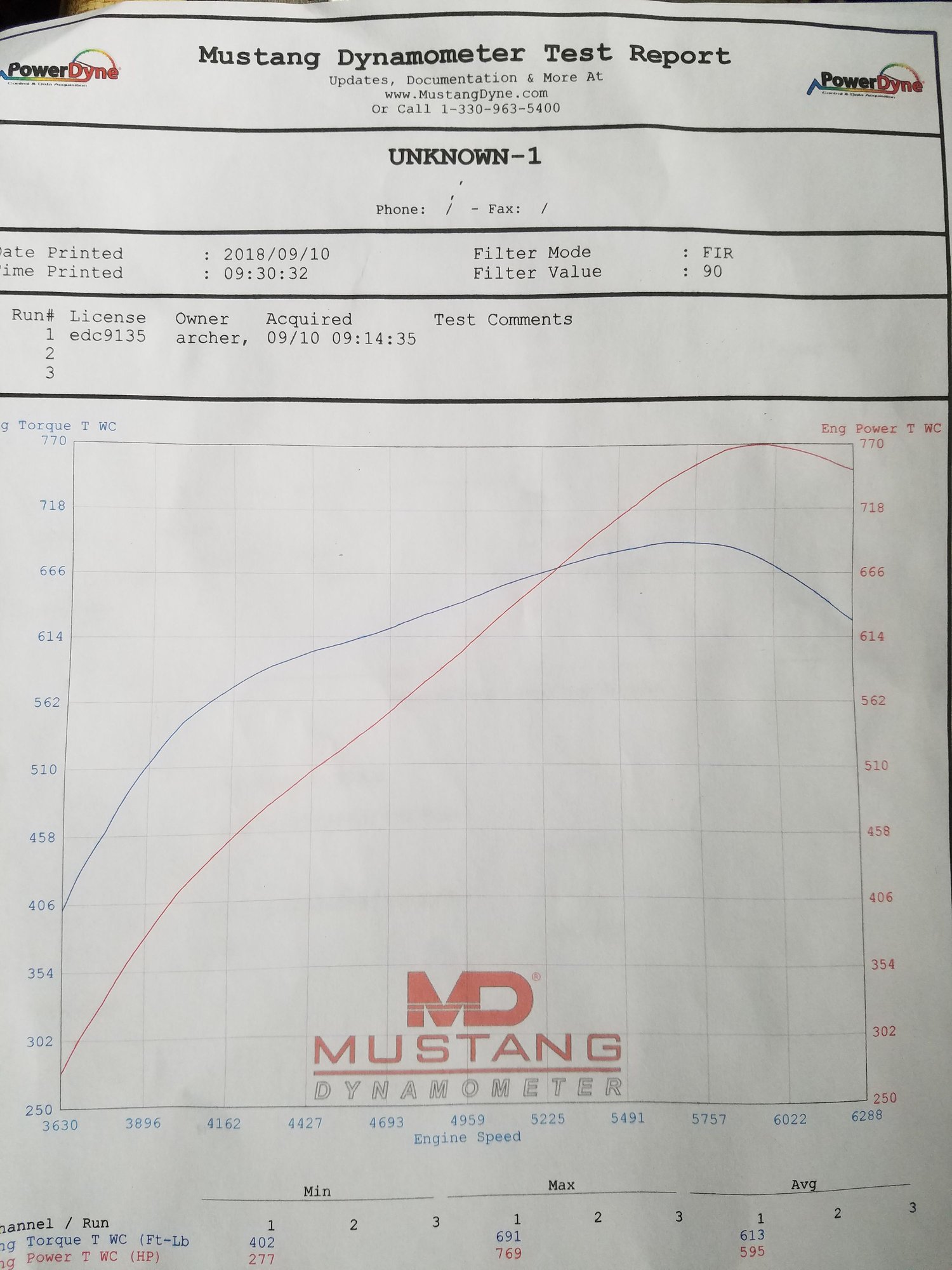

he kept the same setup, opened up the exhaust to 4" and dumped the wastegate to atmosphere...
769rwhp/691rwtq @ 15psi on 93 on a mustang dyno!!!
10.4 @ 137mph
Shows what a well sorted combo can do.

Great stuff RQ, it looks like he maxed out the stock fuel lines at that rwhp/rwtq, good to know so I will just start off with -8 feed and -6 return lines on my setup once my engine is done.
It's also encouraging that he's running a T56 as I will be also.
