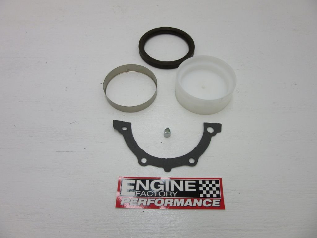

Since I'm pulling the motor, even though it's pretty new, it's leaking out of the front and the rear, so I figure I might as well reseal the whole thing while I've got it on the stand. I know the rear main seal can be tempermental, so I want to install it right the first time. However, I saw these simple tools were crazy expensive. I found this setup from a company:
Anyone have experience with this? At $95 including the Fel-pro seal, it's a way better deal. The metal ring is just an optional sleeve it comes with in case you have grooves on your crank, which I shouldn't.

The newer felpro teflon rms comes with a plastic ring to get it onto the crank. I then tap it on with a thick punch while going in a star pattern

you can use the sleeve that comes with the Teflon seal
I always use the rubber one....but I have the "tool". Bought it on ebay about 17 years ago for $40 used
otherwise...
The Teflon one you use the plastic sleeve and use a wide punch and or small hammer to tap it in, no oil on install
The rubber one you oil and just use a wide punch like previous post said to drive it in
