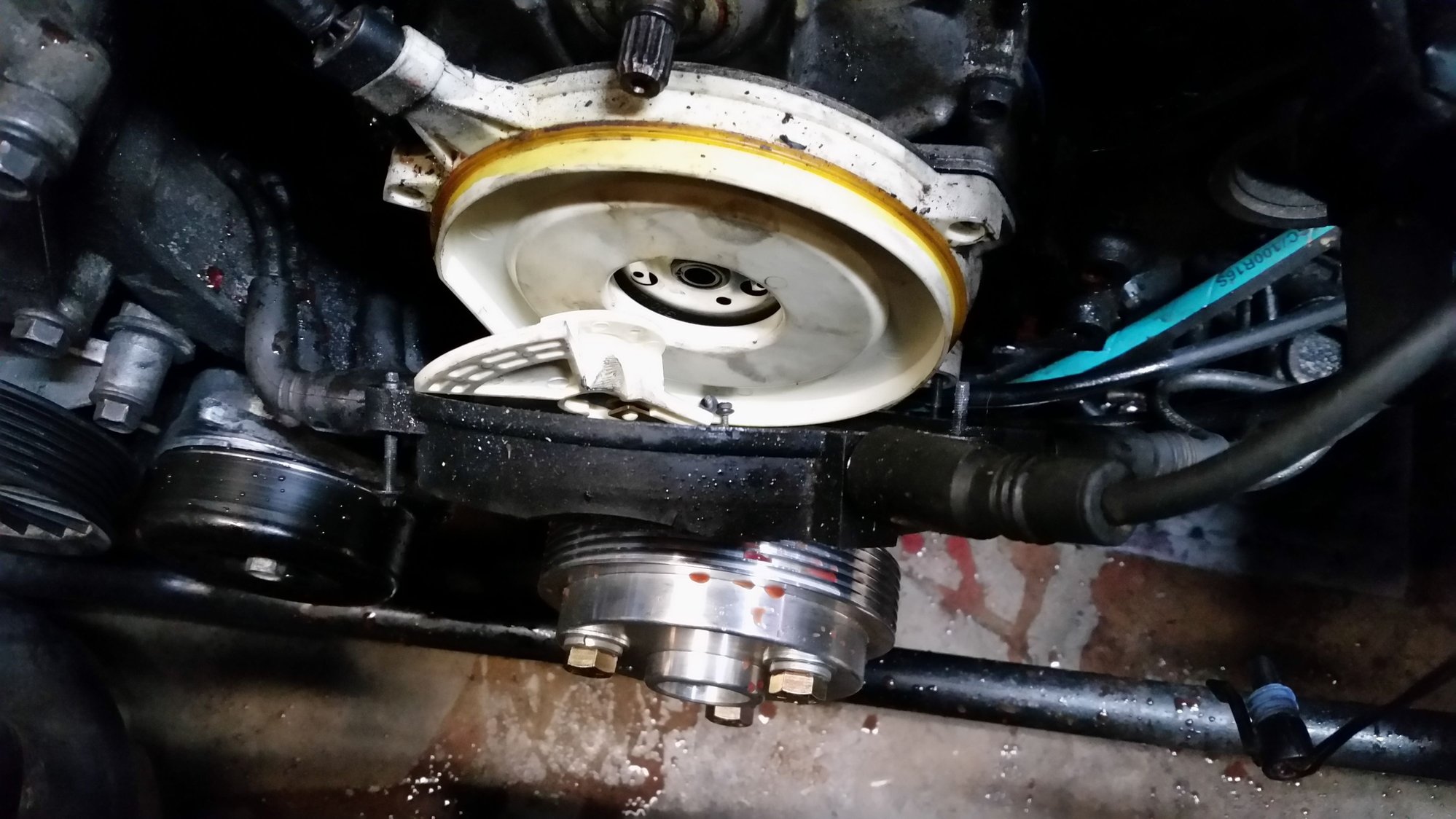

Update: pulled the waterpump and had two pleasant surprises. First surprise was that i can pull the cap off without removing the crank pulley due to the underdrive pulley. Lol. Next, found the rotor just floating around.
I went ahead and ordered the MSD cap and rotor while i have it apart.. Figured i'll just hold off on any major ignition upgrades for now and stick with the opti.
