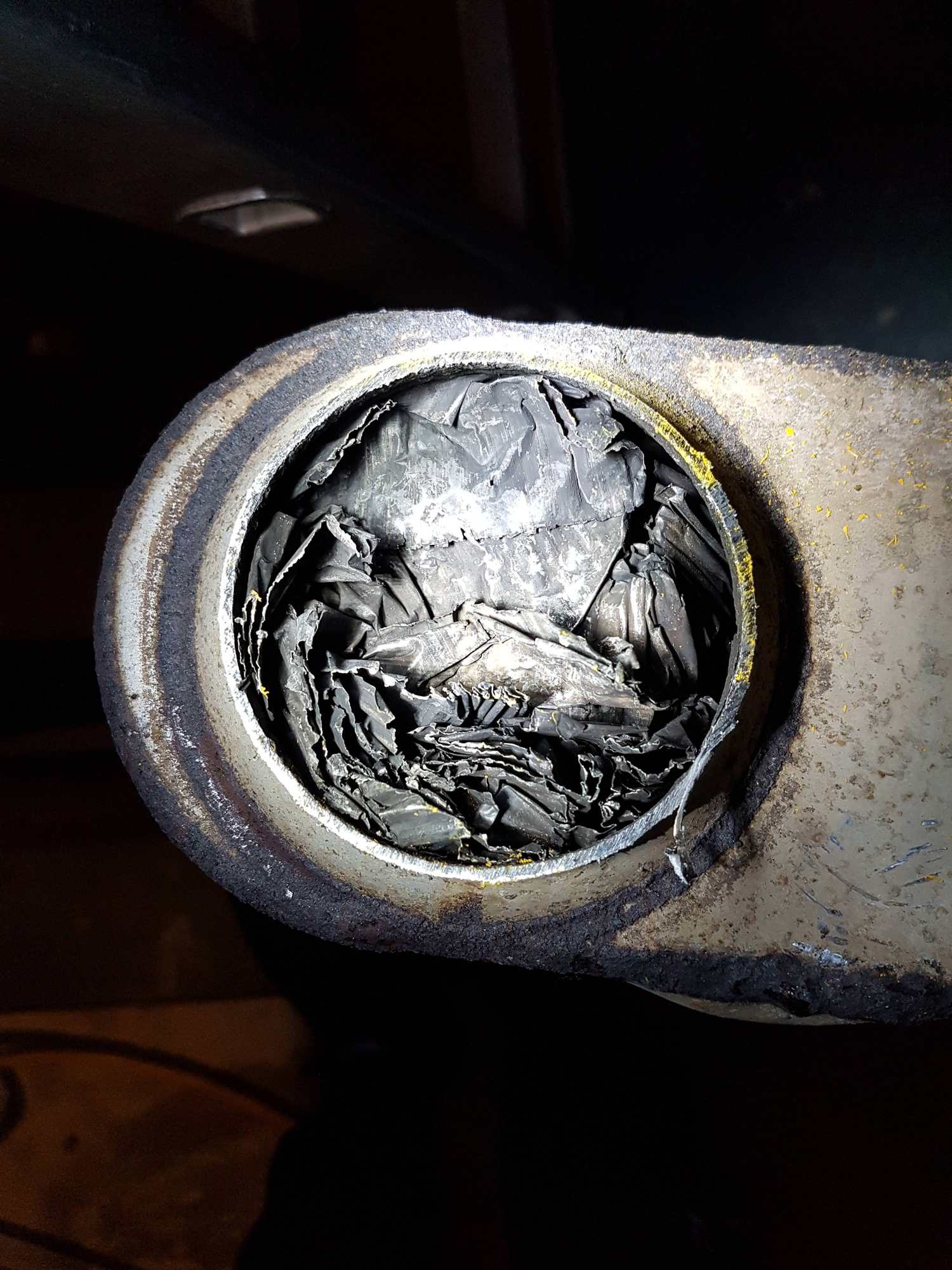

I hack the muffler off and below is what I find - the inlet of the muffler is completely clogged, with what I'm assuming is old cat guts. And I mean clogged - you press on it with your fingers and it's packed in there tight! I was expecting to have to cut the muffler in half, and maybe find some small blockage that was restricting it somewhat, but nothing this conclusive and plugged tight. I'm surprised it could even make 200 whp like this, as I can't even see how any exhaust would get past this blockage. I drove the car and it was a night and day difference - that 3rd gear pull I couldn't even measure a time because the car was going sideways at even half throttle (summer tires and it's winter here in Canada now, no grip!). I've yet to get it back to the dyno, but I'm expecting nearly double the WHP gain from this.
Just goes to show you that a muffler can get very clogged up without glowing red or blowing up - maybe the exhaust shop I went to the guy wasn't the most experienced, but he seemed very adamant that wouldn't happen, and if there was stuff inside that you could shake it and hear it. In this case, the muffler was so tightly packed there was no loose bits to rattle or shake.
Muffler Inlet:

I wouldn't worry too much about your cat. With the reduced mass flow through it, I would argue that it got no hotter than it gets at max airflow / max power.

looks like previous owner used Metallic substrate cat that blew apart.

I had that happen but with straight through absorption mufflers the cat guts came out like tapeworm.

Happy ending to this story:
Ended up replacing that clogged muffler with a Borla, took it back to the tuner and saw a huge difference instantly - first pull was up over 325 whp from barely 200 with the clogged muffler. After all was said and done, made a max of 358 WHP at 6300 RPM (power curve was just leveling off at this point). This was on a Mustang dyno as well, which reads a little low (not that I'm super caught up in the magnitude of the numbers anyway).
