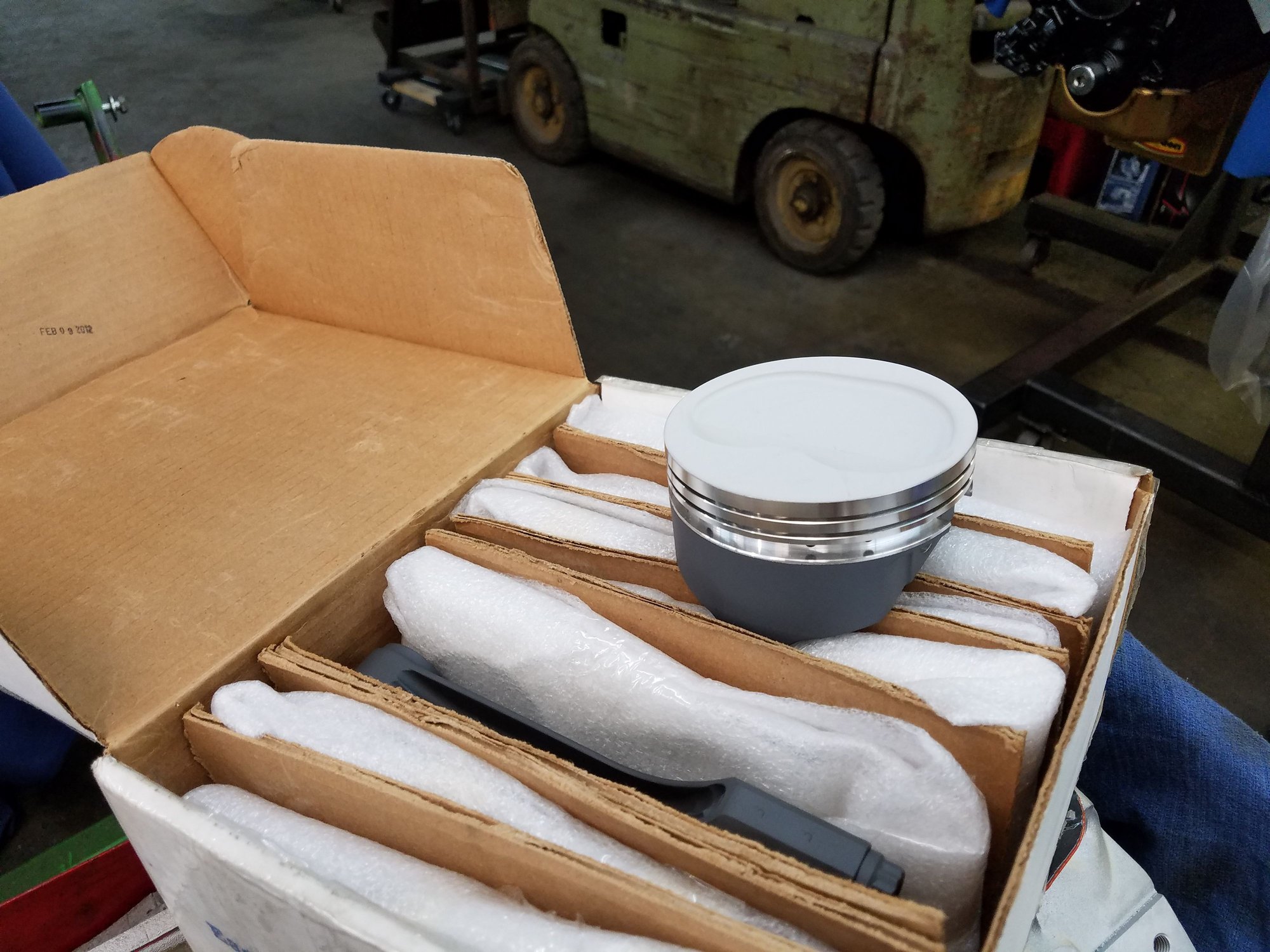

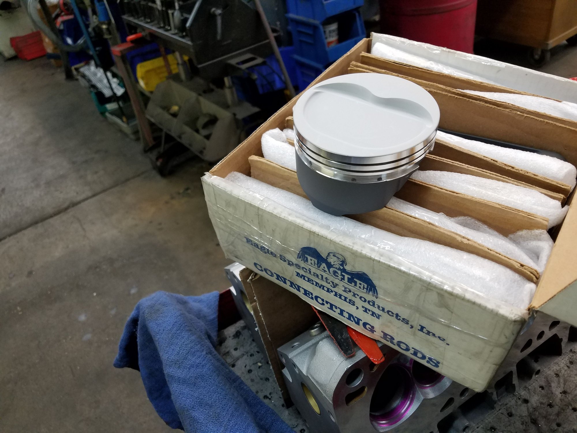

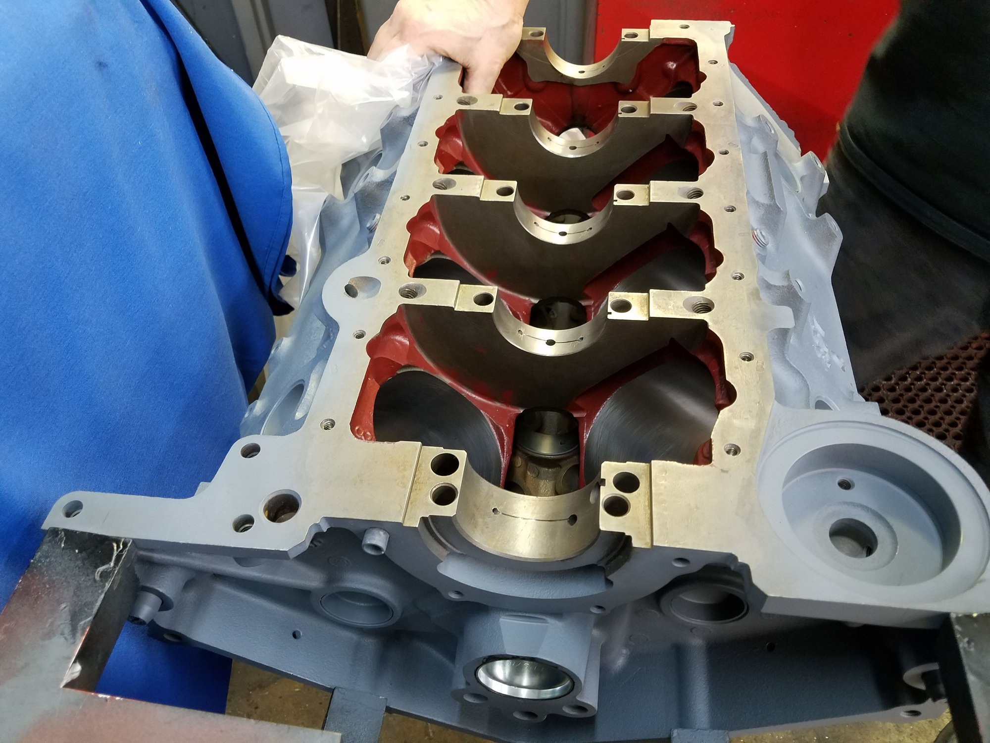

Posts: 1,290
Update the engine is at the machine shop, the block work is completed, bored .040 over, deck plugs, forced pin oilers, decked block, half filled with hard blok, splayed billet main caps, align honed, plate honed ARP head & main studs, block o-ringed. Callies Dragonslayer 4340 crank, Eagle 6" 4340 H beam rods with ARP L-19 cap screws and SRP forged -16 cc dished pistons all coated with appropriate thermal barrier, dry film lubricated or oil shedding coatings, internally balanced, with Fluidampr and McLeod Street twin clutch.
I have AFR 210 Eliminator heads and I will have additional porting done to maximize them further and the combustion chambers and exhaust ports will also be thermal barrier coated, shaft rockers Supervictor EFI intake and a yet to be determined custom cam with Comp Cams short travel Hr lifters or possible a TL solid roller cam.
Kevko 7 qt road race oil pan with baffles and trap doors with a Melling hv/hp pump and a B&M oil cooler with built in cooling fan.
Here are some pics from the machine shop.

I loved every thing I read until the SRP piston. It sounds like you are going for big power. If it was me I would go with a 2618 alloy JE or equivalent piston. Don't know if it is too late for you to switch?

I was the one who asked about boost by gear as my car has a faceplated T56 and as far as running the SRP forged pistons, I trust my engine builder when he says they will be fine with the coatings and forced piston oilers.
