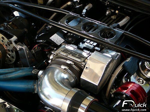

You need a boost reference regulator. No bones about that. As for ECU switch when you can to 24x efi. You build that turbo setup yourself on fquick? I've actually saved a pic or 2 of that car years ago. lol

The turbo setup is a Forced Induction Gen 2 system. Yeah, it should have been tearing up the street and tracks all these years, but the installers messed up everything inside and outside the motor. I'm doing everything over myself.
Definitely looking to switch over when life permits. Did you partial fill your block? Are you driving on the street too?
