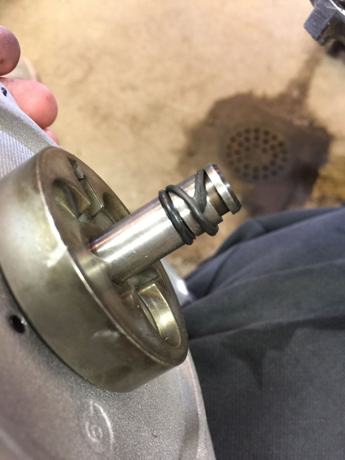

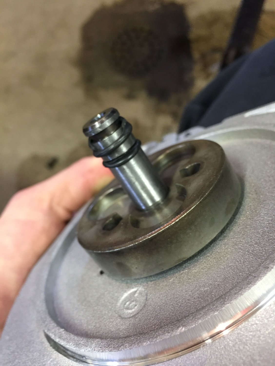

i got some pics here of it when I took it off. I couldnt tell if any actual damage was done other then the O rings being broken.. so idk right now. I hope i dont have to buy another optispark. Im hoping i can just get some o rings and try it again

Just spin the shaft. If it moves freely and no noise from inside the Opti it should be fine
good you pulled it. It may have been on right in terms of pin lining up with the Opti hole....but that O ring is dead. If it was not lined up right it would not have started
The O rings that come in the $12 front timing cover gasket kit "can" be used....although they are intended for the WP drive spline and WP gear drive spline
You want to use Viton O rings if you try and find other ones
Use some oil on them next time
The O rings don't seal oil, they "stabilize" the Opti shaft in the cam
