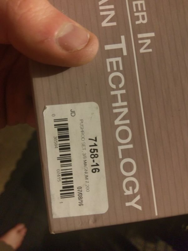

PR length determines the front to back placement of the RR tip on valve...adjustable guide plates let you get dead nuts center on valve tip L-R.

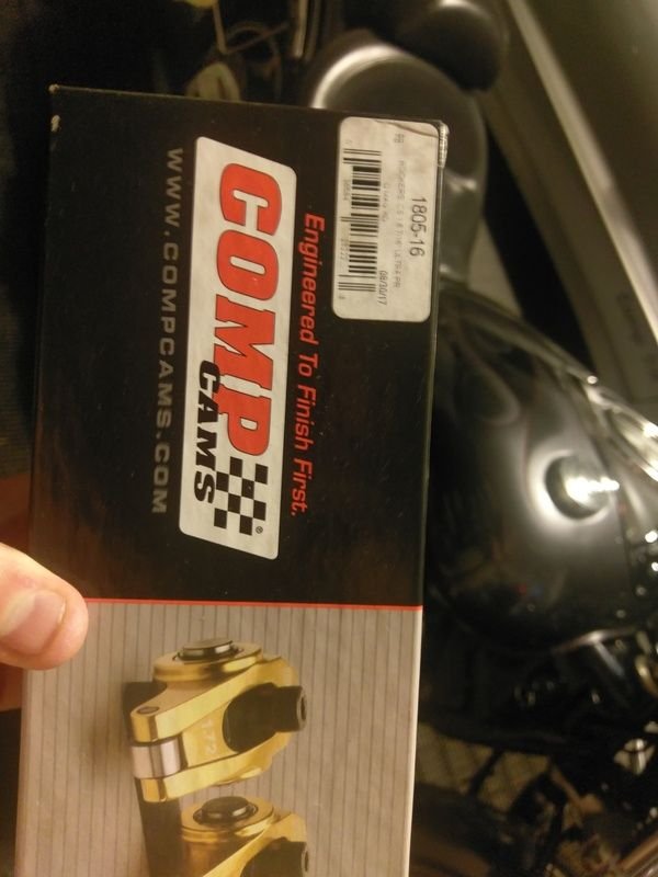

I understand, I was generalizing the term "Valve Train Geometry" to include the RR tip spot on L-R. I've already measured my PR Length when I did the CAM Swap with the old SA RR but I'm going to check them again as I'm upgrading to 3/8 stud and new NSA RR instead of SA just to ensure everything is still dead on as far as PR Length is concerned. I doubt it will be an issue but I've seen weirder things happen. I'm just glad that when I did my CAM Swap I zeroed my cam and marked True TDC as that's one lesson I learned the hard way on one of my previous vehicles. If its there, might as well mark it and make life easier on yourself in the future.

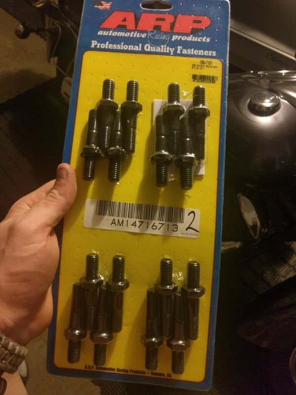

good time to go 7/16 RR studs and RR if you are buying new RR

Damn it, I meant 7/16....running on very little sleep. I meant to say replacing my 3/8 with 7/16. How can I expect people to answer me correctly if I cant even relay the proper information! LoL
