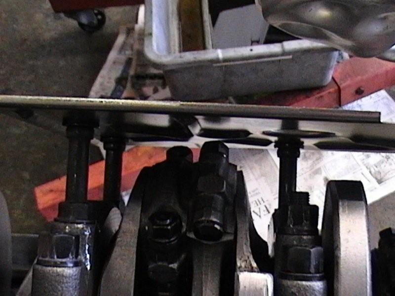

your OP "tanking" when you slam on the brakes...should not happen. Just confirm the oil pick up is on and you should have a windage tray.
I have a stock pan and use the stock windage tray but had to stand it off 1/8" so it would clear rods. Just used washers on the 3 longer crank studs to space it off
