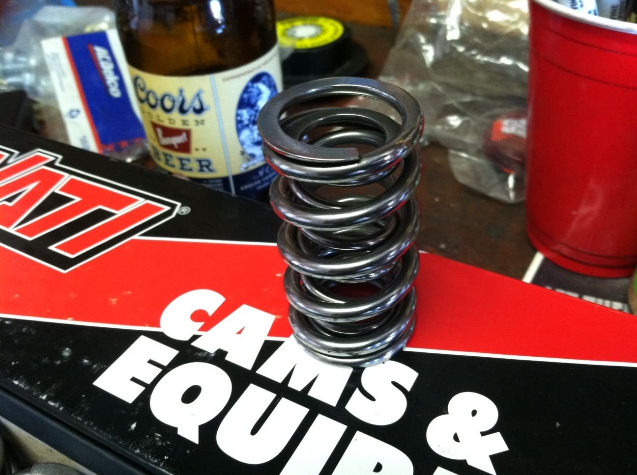

The XFI has quick ramps. Don't use the Comp 918 Bee Hives as the cam card notes or you could become a member of the 2 piece spring club...ask me how I know.
Lloyd recommended, and sold me, the Lunati kit. Very nice spring and works very well with my XFI

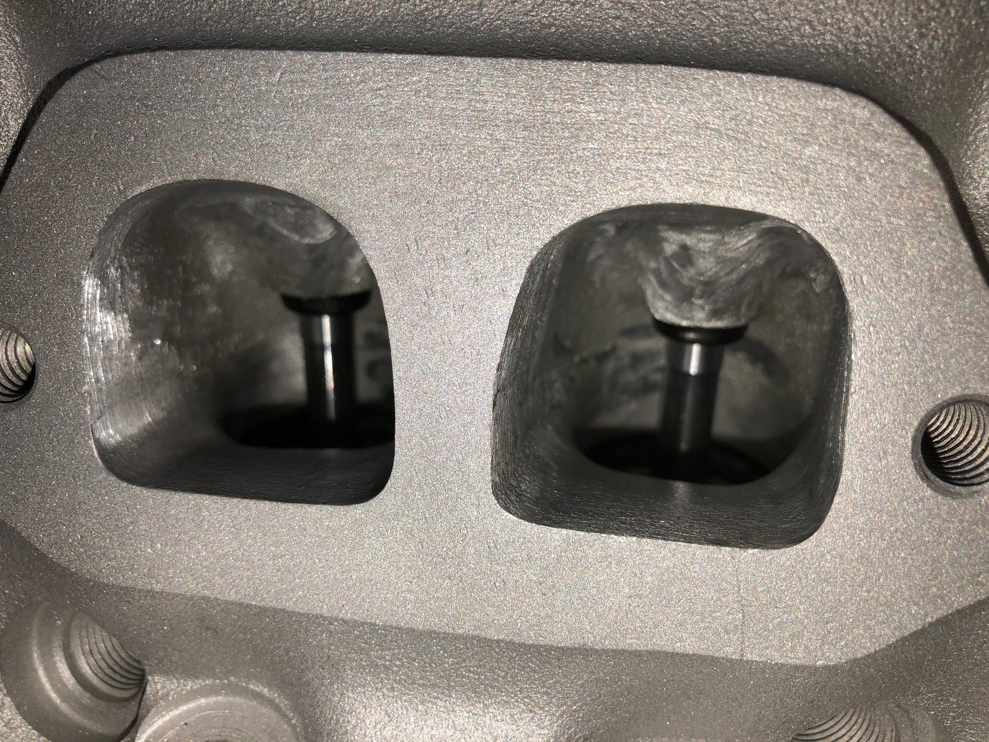

The only problem I see is that his heads AREN'T ported they just have bigger valves so the seats were changed but no bowl blending or porting was done.

Yeah i wasnt too happy with the ports themselves.. and I know Lloyd could've ported them but i decided to just use nitrous for more hp. But the heads were ported a little bit..

this was the only porting done.. makes me a little mad that there wasnt much of anything ported but at least its better than stock. I know i wont make 400 rwhp with this but i guess ill just get to where i wanna be with nitrous haha
