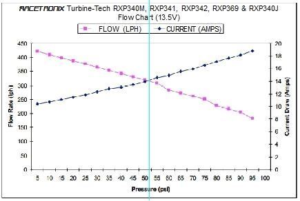

If the alternator and wiring are doing their job and the pump is in good condition there should be a correlation between pressure and amps.
To rule out completely the electrical you need amps (you can measure this anywhere in the line feeding the pump) and volts directly at the pump (this is not possible due to the pump being inside the tank) but you should measure voltage as close as possible to the pump. There could be a voltage drop along the hotwire kit due to a loose connector or bad relay.

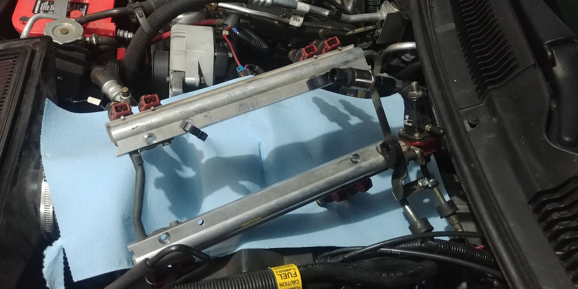

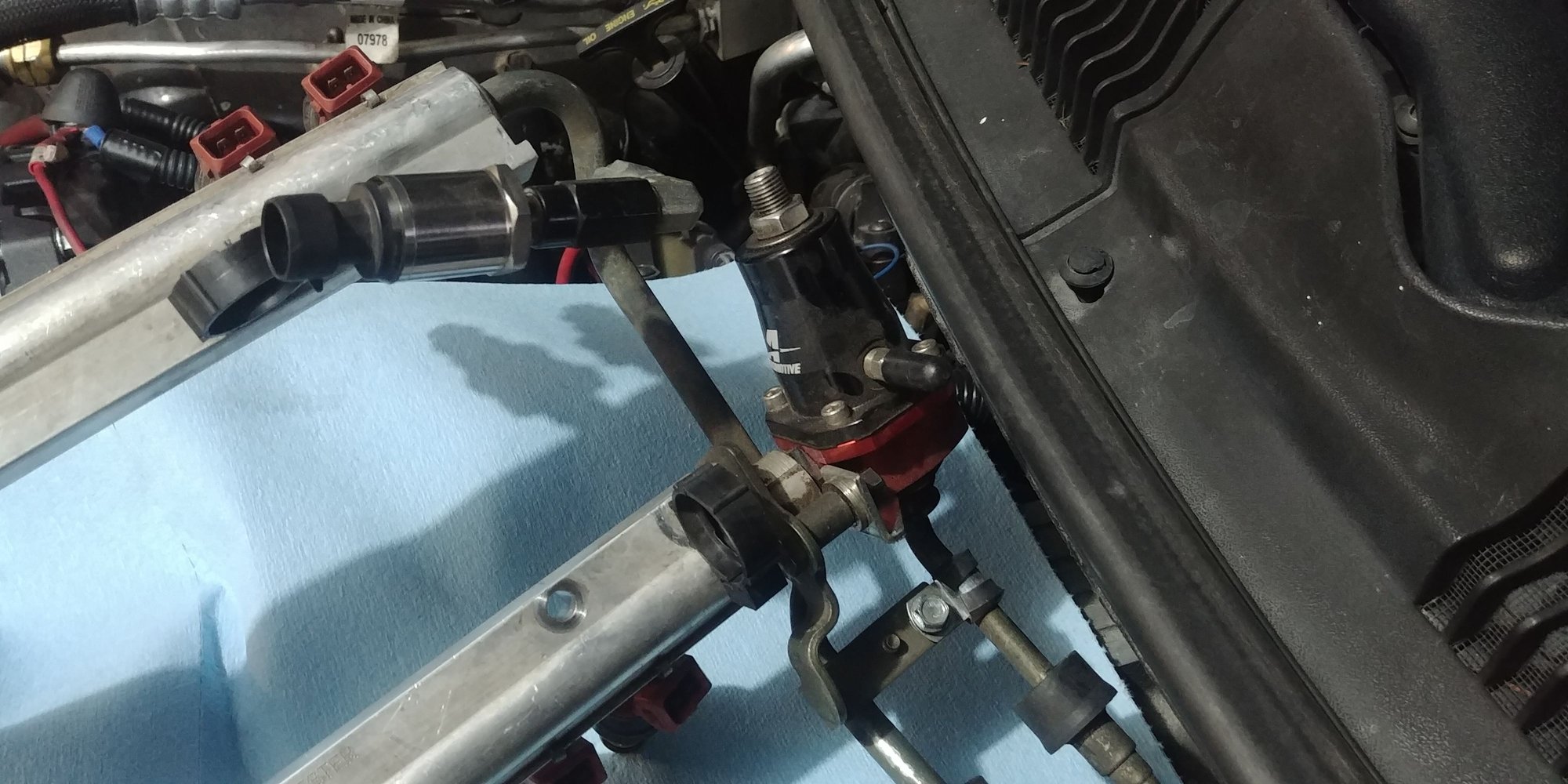

Went ahead and swapped out the FPR. I'll adjust the tune and go for a test drive tomorrow.
Here's the fuel rail with the Aeromotive FPR:
And here it is back to being a filthy casual. (Got in the zone and forgot to take a pic with the rail pulled out)
Already primed the pump and there are no leaks, holds pressure at 34psi after priming.

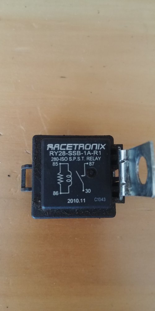

I can't find this relay anywhere. I sent Racetronix a detailed email about all this, hopefully they respond. Anyone know where I can get a replacement for this relay? It's not even on Racetronix's site. I got under the car and eyeballed the power wire for the fuel pump and it looks good. Not resting on exhaust or damaged or anything.

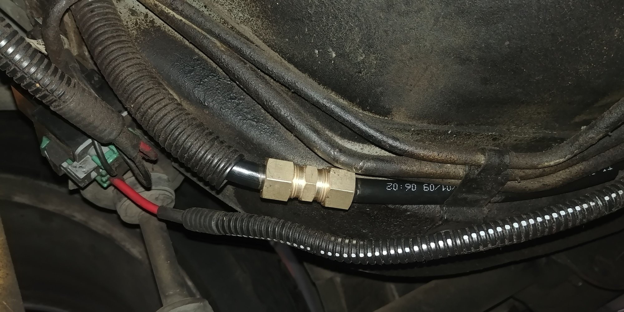

Went ahead and replaced the jacked up portion of the fuel line. I know the union isn't in the most aesthetically pleasing area of the line right there on the bend but I primed it a couple times and there are no leaks so it's functional.
I would not trust that at all. Most autoparts stores carry the correct hose barb repair fitting in the Motormite/Dorman "HELP" section to repair that. It looks like a PEX plumbing connector. They offer them for the 3/8" and 5/16" lines. Much safer and reliable repair insert.

Its this:
the hose repair kit was also Dorman and it came with a barbed union but this one has a slightly larger inner diameter.

https://www.racetronix.biz/p/relay-2...ry28-61f14-s01
