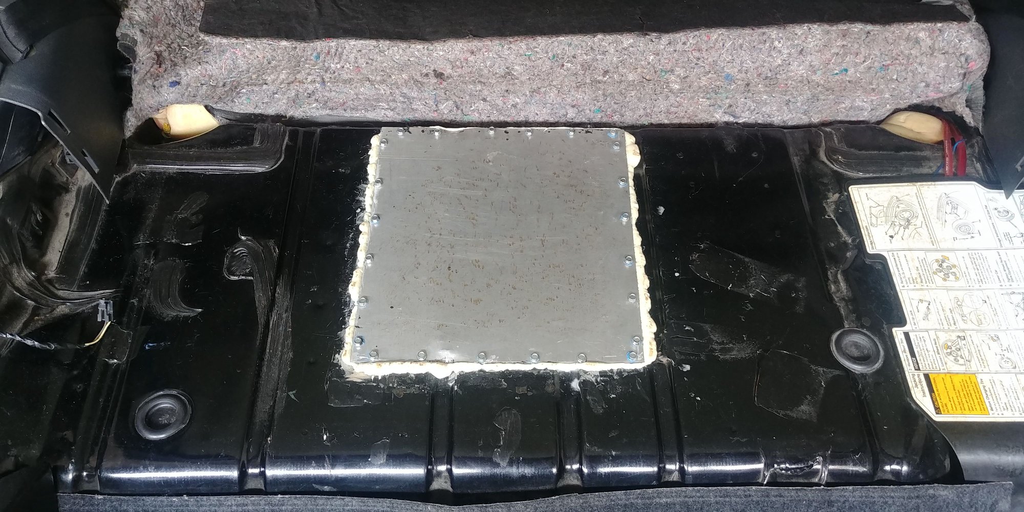

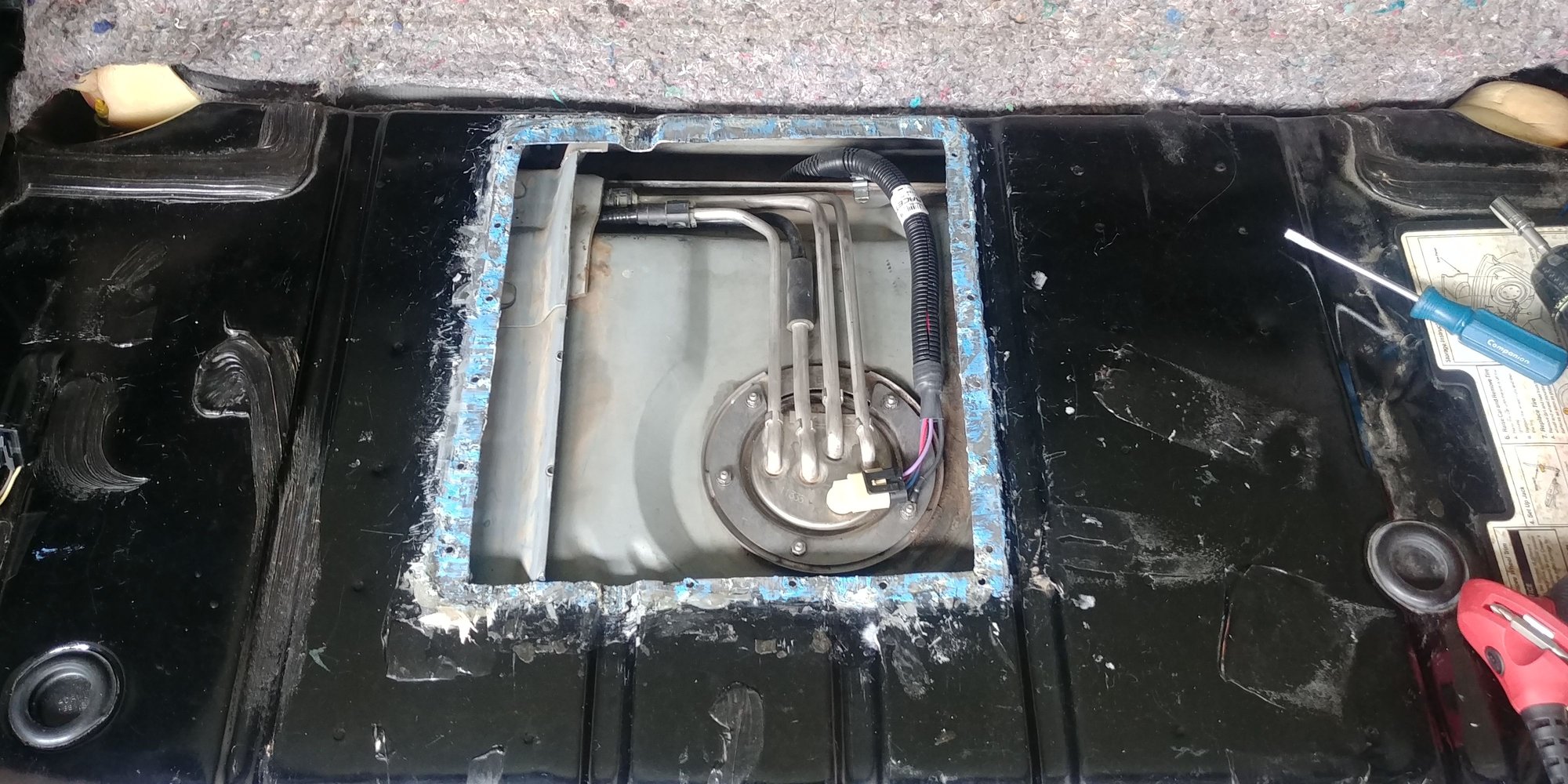

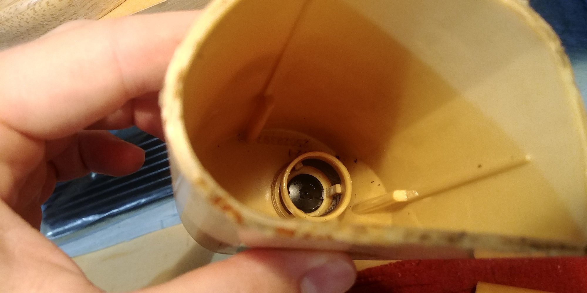

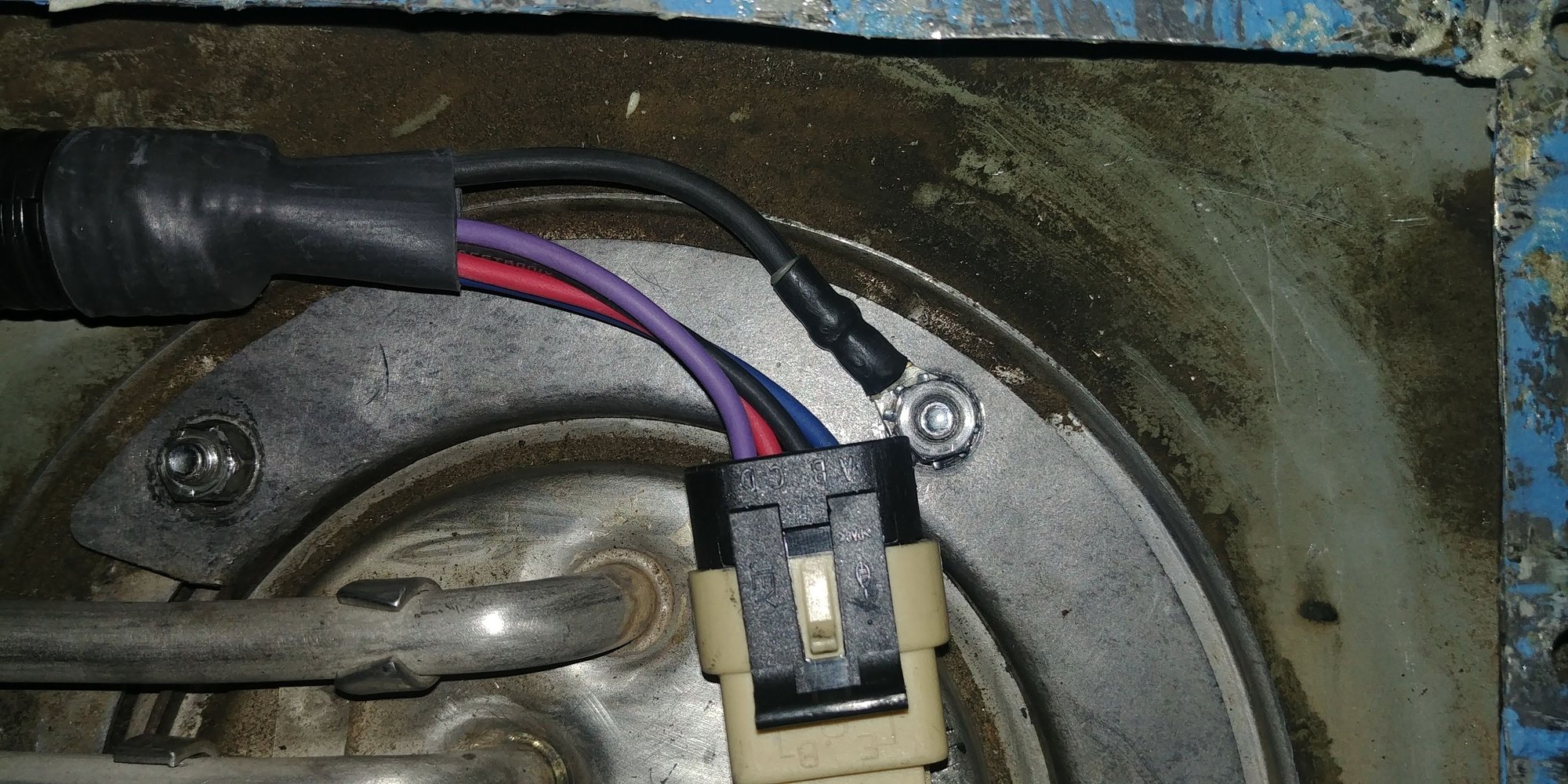

I spent the day removing the bucket. Here's the trap door:
Here's the door removed:
Disassembled a bit:
Inside of the bucket looks pretty unremarkable.

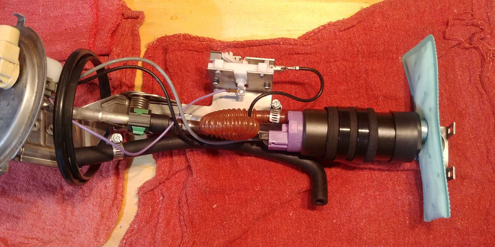

The 28 amp fuel pump harness I modified and was using before (pics higher up in this thread) was getting dissolved so I went back to using the old (but still upgraded 12 gauge) fuel pump harness that can handle 20 amps. I also used the old bucket overflow tube as the new return tube so I could point the return fuel away from the pump in case there are bubbles coming in through the return line. Not sure if that's possible but I don't want to risk it.
Since the pump harness has 1 power wire instead of 2 now, the blue wire isn't being used anymore. The pump is now getting electricity from the red wire only. It looks like 14 gauge, good for 15 amps according to google.
Tomorrow I'll throw the Aeromotive adjustable FPR back in and if the forest fire smoke is below hazardous levels I'll take it for a rip.

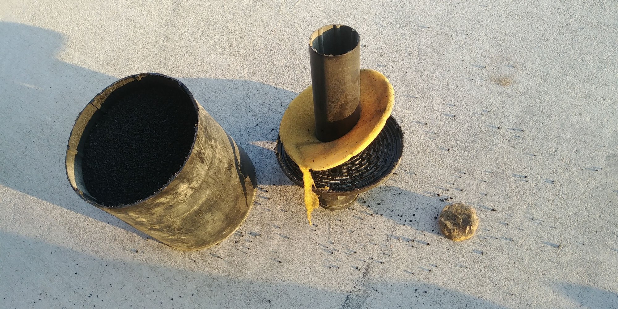

Ever wonder what the inside of the evap canister looks like?
The canister is full of what looks like black cat litter (charcoal obviously). Mine smelled like a mixture of pure gasoline and super glue.
What I did today:
Changed that evap canister
Made sure the all the evap lines were patent
Checked the evap solenoid for functionality
Check gas tank vent line + valve
Leak tested fuel pump sending unit with flex tube attached
Inspected tank interior as best I could.

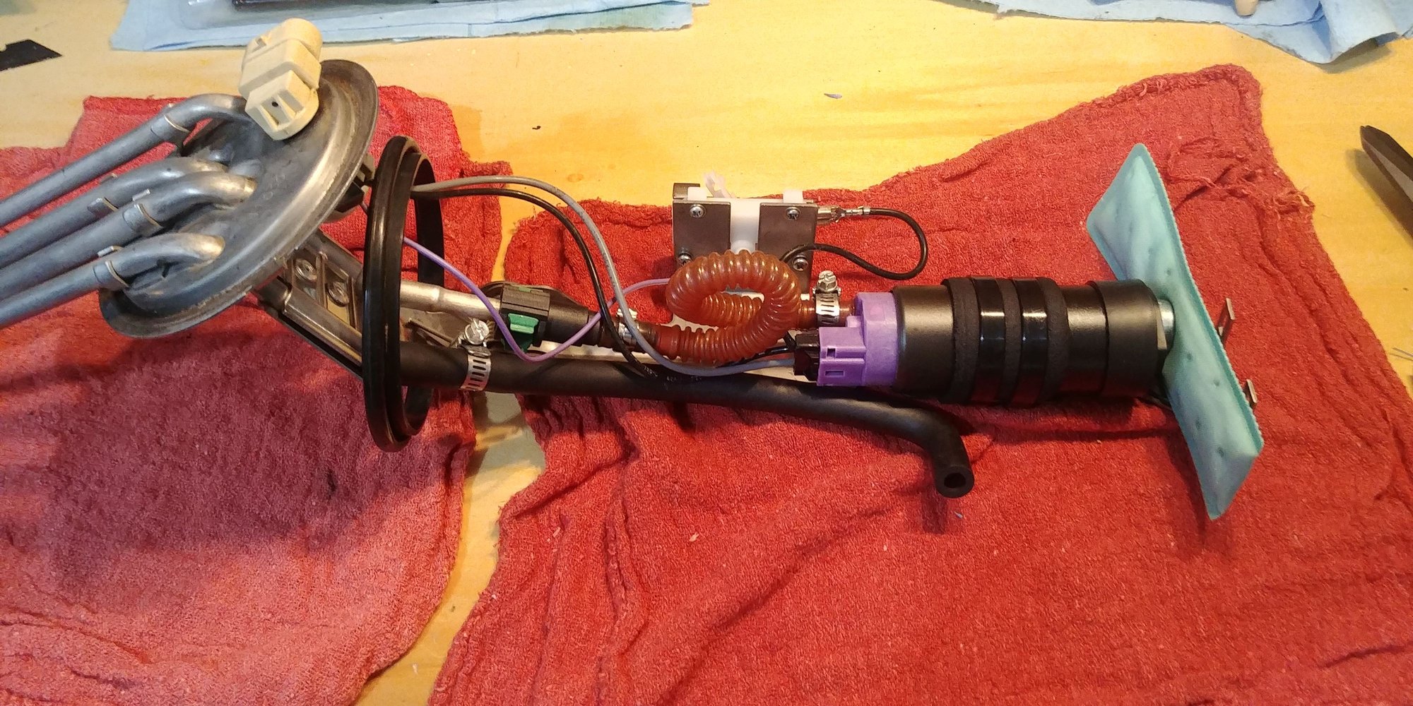

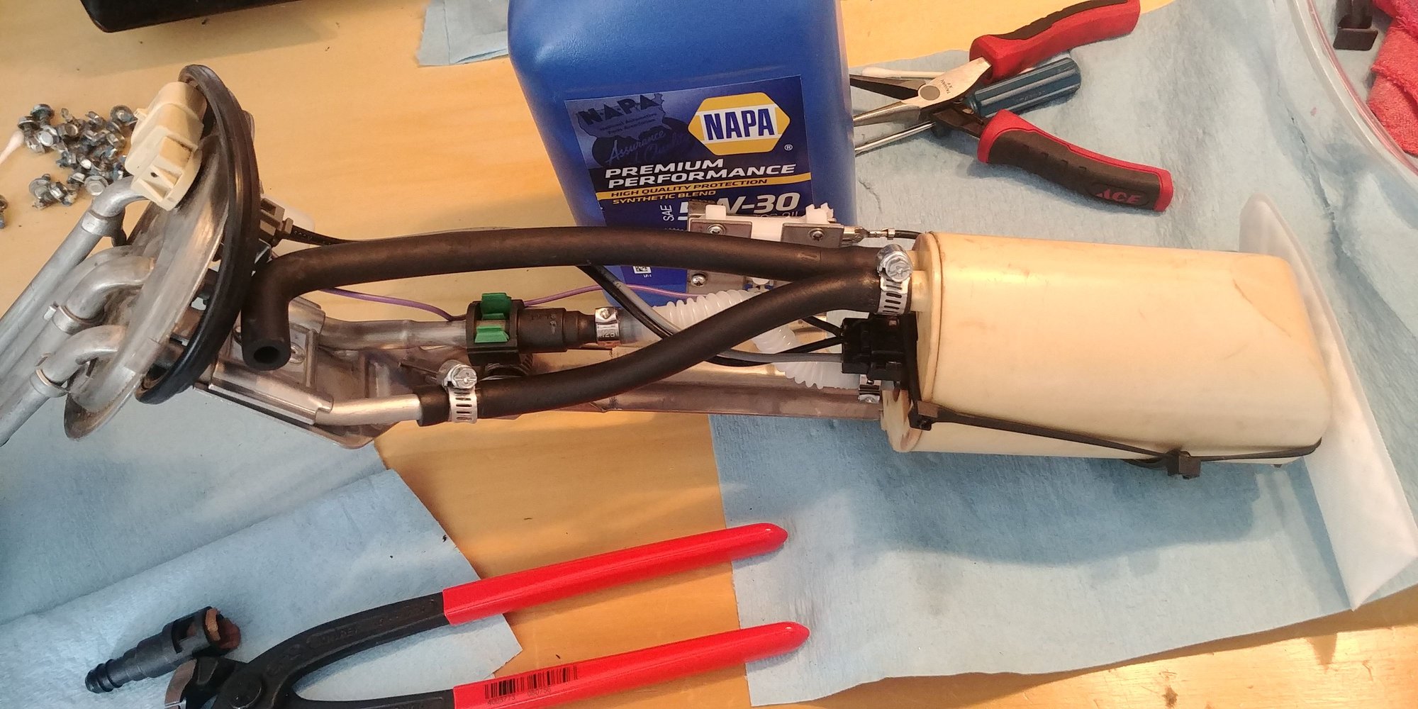

Everything passed with flying colors. I swapped the Walbro back in with the bucket and a new strainer. I also used a new flex tube that I've had in a box. It's much shorter than the last one so there's no loop. I'm also using two crimp clamps instead of the screw clamps. It's cooling down like crazy here so I probably won't know if this works til next year.

Here's how it looks now:

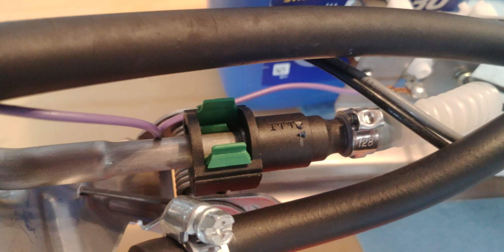

I used the prime connector to run the pump and check for leaks under the hood. Is the fuel supposed to be this noisy?
