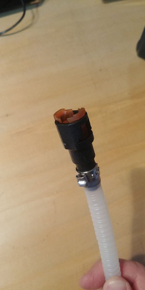

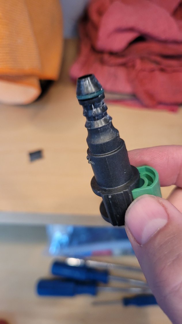

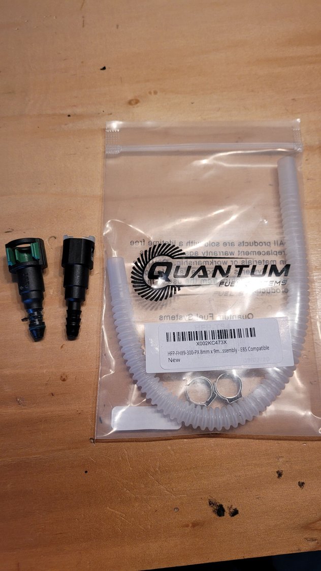

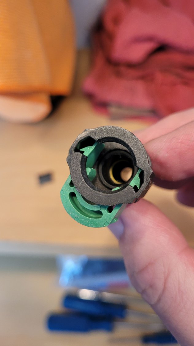

The fuel pressure will be fine for the next 7-8 months as the temps stay cool enough here in Oregon but I wanted to post my final idea. I still have the original flex tube to hard line fitting from the factory sending unit/ flex tube. I used a heat gun to get a new flex tube on it and if I'm still having problems next year, I'll throw this tube in.
My idea is that the current black and green fitting might not have any o-rings in it. I remember looking inside for one but don't remember seeing one. It does have an external o-ring on the barbed end but that's it *if I remember correctly*. This original fitting has 2 internal o-rings although they are a bit flattened. Worth a shot.

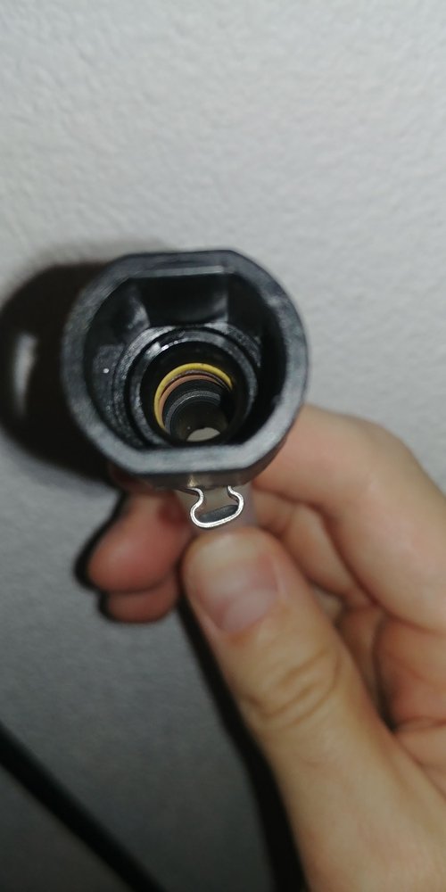

It's heating up where I live so I'm back at it. The vent valve works fine. There's never any pressure or vacuum built up in the tank and I smell vapor whenever it gets hot enough.
Went for an hour long drive yesterday while it was around 90 outside and the pressure was slowly dropping right on cue. I planned on driving more but once it hit 55 psi I had seen enough.
I swapped in the quick connector and flex tube that I posted above and went for another hour+ drive today. Although not quite as hot, my elevation was pretty high at 5-6000 feet and it's dropped in cooler temps before. It was anywhere from 75-90 degrees during the drive and pressure held steady except for the very end it had fallen to 56 psi. I'm gonna need to drive it more before declaring victory because even though the pressure held nicely, I want to see how it does on a truly piping hot day.
Here's what the old quick connector looked like. I guess it did have an o-ring internally. It didn't feel like it was loose at all...
