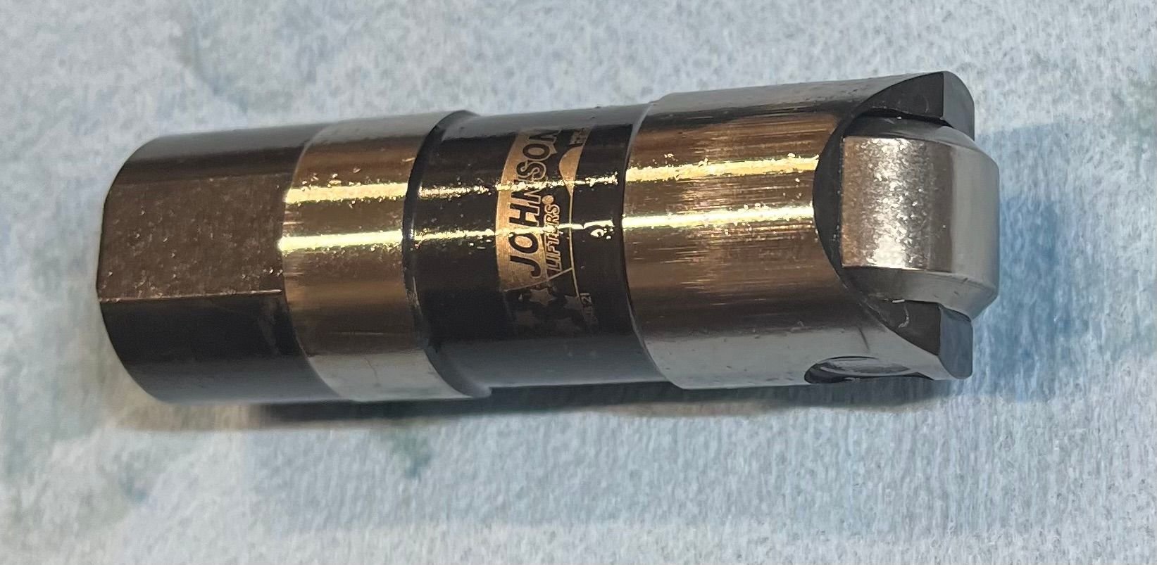

Old Apr 28, 2023 | 11:01 PM
  #120
SS RRR's Avatar
Village Troll
Joined: Oct 2002
Posts: 11,111
Likes: 598
From: Jackstandican
Originally Posted by 350 groundpounder
Im thinking Morel or Johnson lifters on my next build that will be more aggressive.
I decided to go with Johnsons a few years ago. Took the intake off tonight and looked at four different lifters. They were all in pristine condition.
**** those flakey piece of CHI-NA sacks of ****.
The dimples on the roller is oil coating. These things looked brand new.
