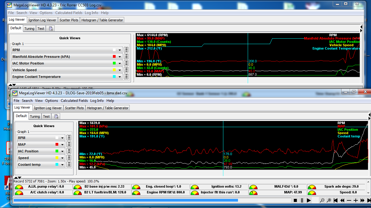

I can see in the log the unstable idle. Comparing it to one of my CC503 logs you can see my idle is much more consistent(flat line). The min/max difference on your idle for the displayed section is 358 while mine is 69.
Your fuel trims look decent. I don't see out of control fueling. ST's are cycling around 128, B1LT showed some elevation around 140, but it's not railed.
My MAP is fairly flat too...compared to your MAP pulsing up and down. My initial question would be.....are you sure you don't have the valves adjusted too tight?
Compression and leakdown testing would be my next suggestions....and maybe double checking the dot to dot between the cam and crank.
As a side note...I envy the scanner update rate on that OBDI PCM. You get way more samples a second than I do on OBDII.
