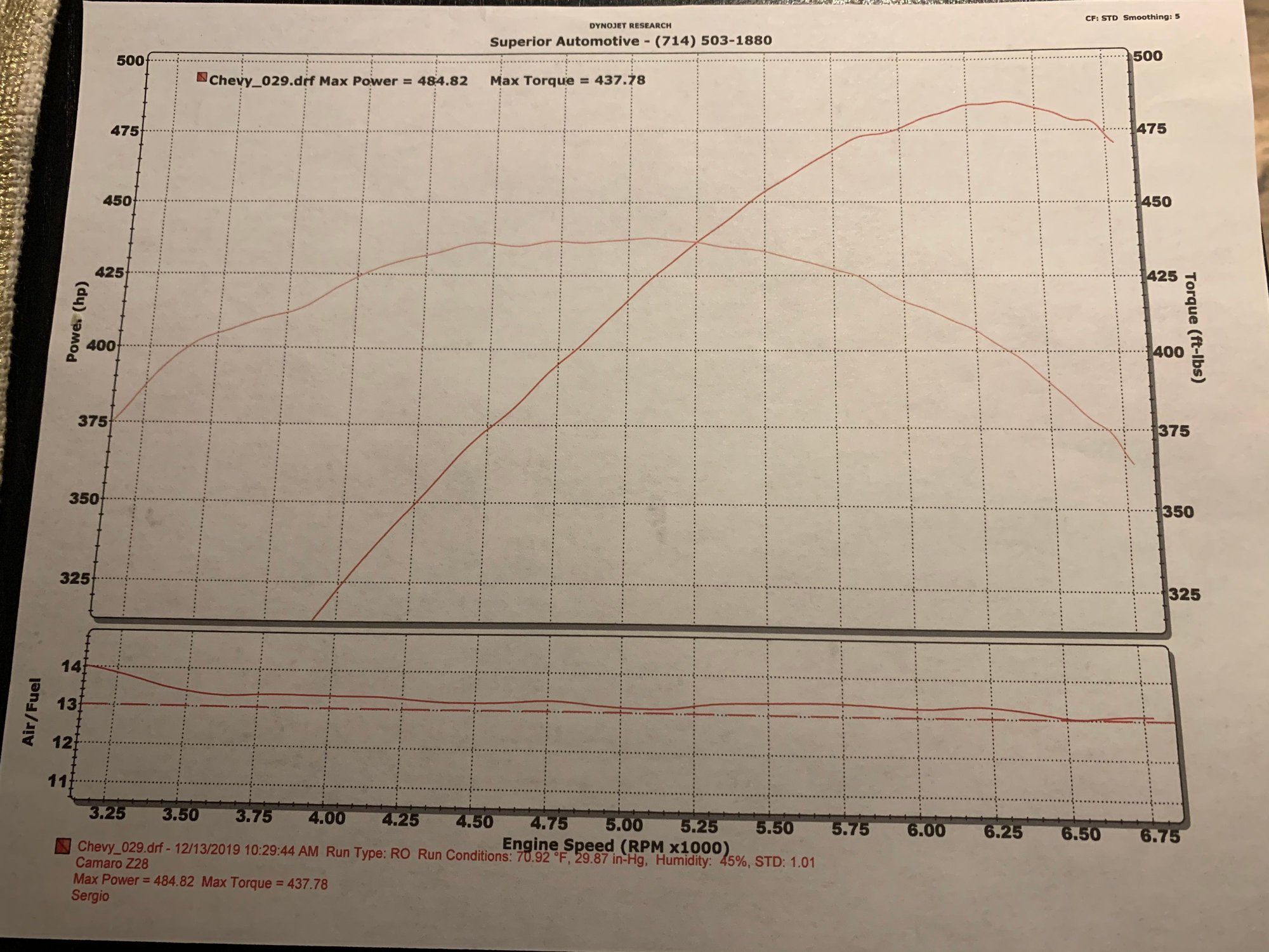

484hp 437tq
Not much gain but the extreme wheel spin was killing the torque numbers. My fault tho....went to the dyno with dry rotted tires. Lead plates and cast iron big block heads still didn’t fix it. All the gains were past 5200 RPM where the monoblade could flow more than the 58mm

Would love to see the dyno sheet. Planning on taking it to the track?

The power your car makes is impressive especially given the 10.5:1 compression and 91 pump gas limitation.
