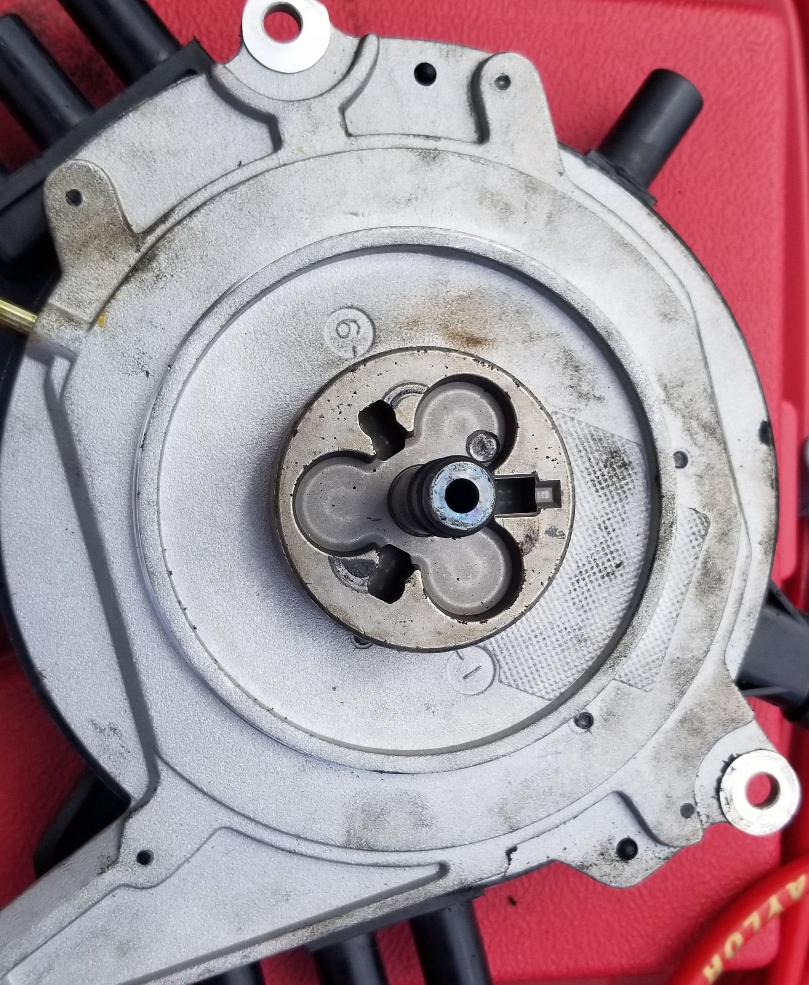

Opti was installed wrong. Dowel pin was in circle and not the slot.

After 9hrs of taking everything ack apart and then putting it back together lol, yeah fired up first crank. Without a few searches on here I never would of known it was possible to install it wrong

Yeah, that stupid clover leaf throws some people off but as you found out the one relief is different from the rest.

Yeah. You can see where it slipped into the clover leaf. It went on easy and looked flush but I'm guessing the bottom bolt wasnt. It wrecked the bearing in the new opti which sucked but I took all the internals and cap and rotor from the new one and used the backplate from the old one and worked all good.
