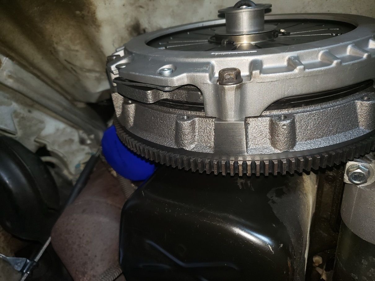

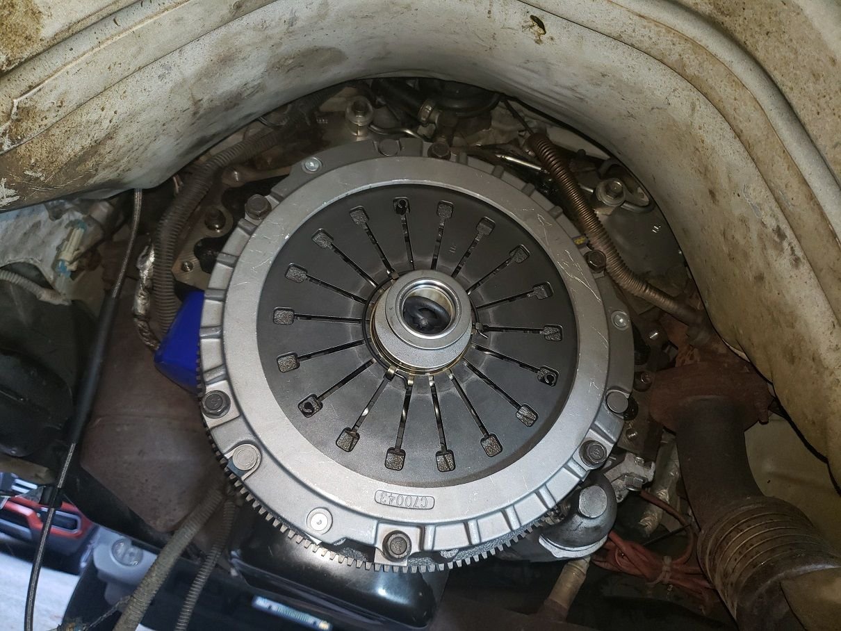

when installing pressure plate to the flywheel, is it normal that PP does not contact the flywheel and is 1/4" off when you first hand tighten the bolts?PP is touching flywheel once I tighten the bolts, but it didn't quite feel right at first. Also the forks which used to be concave are pretty much flat now that the PP is torqued down which I suppose makes sense and without the throwout bearing engaged the whole force is squishing clutch plate as intended. Does that make sense? sorry for the dumb question, the youtube guide I Followed said 15lbs for the PP bolts + another 30* but I wonder how accurate that is with the PP pushing against the bolts because of the forks, close enough I guess.
I'm just looking for reassurance before I bolt the trans up and get mad that I have to pull it off again.

The way it is installed now the clutch is supposed to be in full contact of the PP and FW. It is in an engaged state. The clutch is a pull style so when you depress the clutch the clutch fork will pull back on the throwout bearing to release the pressure. What torque value did you use to tighten the PP bolts?

PP bolts should be TQ to 22 ft lbs
FW bolts to 76 ft lbs
OP, your PP looks right. The diaphragm is compressed as you TQ the PP down, normal. You want to tighten PP bolts in a "star" pattern

What clutch kit did you get? Any balance holes drilled in any of the three spots around pressure plate in this area?
https://ls1tech.com/forums/lt1-lt4-m...l#post20122321
If not and you end up with a serious vibration up above 3000 rpms, it could be that the plate is not balanced correctly. Just keep that in the back of your mind. I pulled my trans 3 or 4 times trying to fix an out of balance Autozone kit pressure plate.

assuming your TQ wrench is accurate, 25 ft lbs is "likely" OK but spec is 22 ft lbs. If you tighten the PP bolts to much though you will have disengagement issues
Also the note about balance holes drilled in one or more of the 3 "ears" of the PP mating surface is true. Unfortunately many of these replacement clutch kits do not have them which can cause engine vibrations at x RPM's...which is a problem that must be resolved. The China clone PP's are basically the only ones now regardless of clutch brands but some do still have balance holes drilled in them

BTW, it is possible the clutch fork will not have enough clearance when the clutch is depressed and will come into contact with the pressure plate. Unfortunately the only way to know this is by bolting up the trans and either depressing the pedal and knowing if it's at full travel or by starting, depressing and feeling vibration/hearing noise. I would suggest mounting the trans only with a few bolts top/bottom/side, mounting the slave and starting the engine in neutral and depressing the clutch. If it does make contact you will have to remove the trans and make some clearance on the fork. Good new is the fork will be marked up so you'll know exactly where you have to clearance it.
Here's mine:

SS RRR

I think you are the 2nd person I read about having the fork buzz the PP on a single disc clutch using a stock MC (non adjustable). The notch mod would work if that happened or cut a washer thickness of the base of the "T" stud the fork is on.
It is more common on twin disc clutches to see this. Happened when I installed my McLeod twin. Tech said cut the T stud which for me worked well. To get full disengagement I had to adjust the MC (adjustable was included in the twin kit) out and the fork hit PP before complete disengagement so I had to make the T bolt cut
