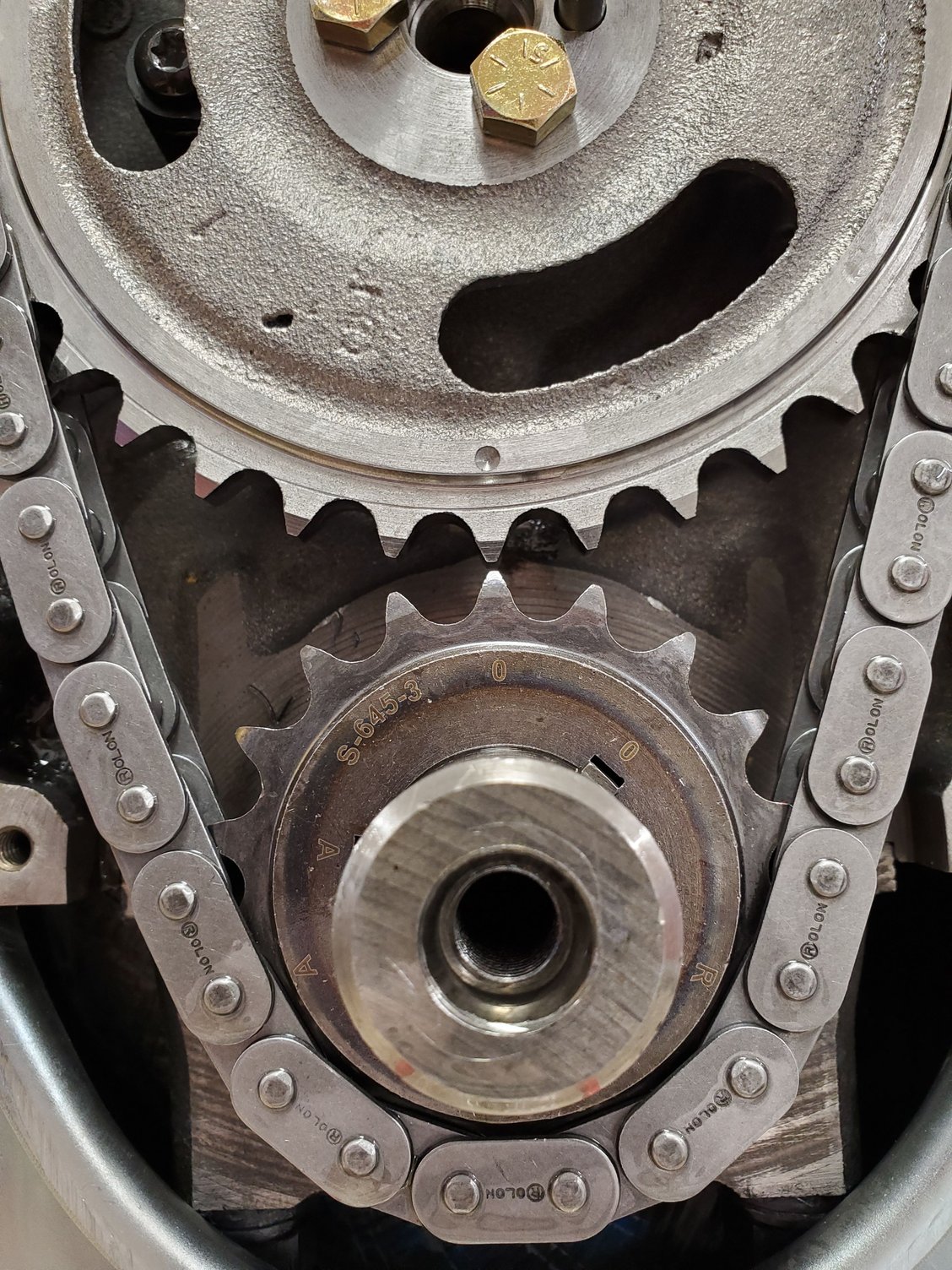

Ok im stumped, how are any of you running a double roller? It leaves no room for the crank reluctor!
I tried the L-98 TPI single roller everyone said would work but only have 0.042 clearance tooth to tooth:
I also have a Cloyes single roller designed for the LT-1 and the tooth clearance is the same!
I'd hate to reuse the OEM set (56k miles) but I'm at a loss, please help! I need to get this motor back in ASAP! I don't even know what other options there are?

I think .030 is acceptable. I ran a LT4 HD with oversized crank sprocket and only had the thickness of my fingernail for clearance.
You can’t run the reluctor wheel with a double roller. You also need the hub off a ‘95 because it’s longer and will make up for the space of the absent reluctor wheel. It will trigger an SES light so that needs to be tuned out.

I'd have to shim it as I already have the ATI super damper. Not sure I like the idea either.
I'll call Cloyes in the morning I guess...

After looking over all 3 Timing sets with the machine shop. We decided the L-98 TPI single roller was the best idea. We couldn't find any issues that would cause fitment problems with the timing cover or opti.

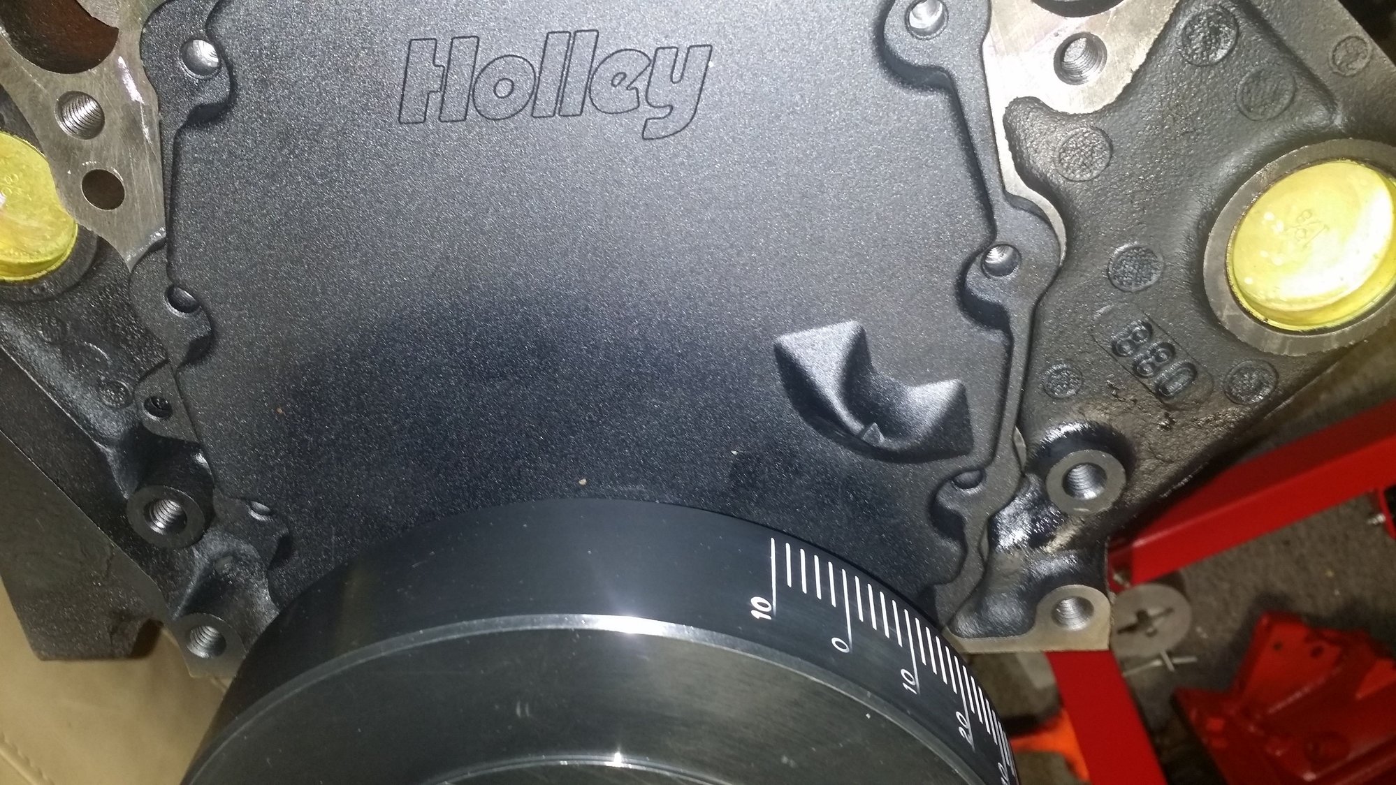

My current 383 Vortec has a GMPP Single roller behind a Holley Aluminum timing cover with a Fluidamper that was machined by Fluidamper to compensate for the EFI Connection 24x reluctor.

Block is align bored. Have about 0.040" clearance.

That makes me feel better, lol. 42 thou here... looks SCARY!

That's fine. As stated I had a fingernail width on mine when running the LT4 ED set. This way the chain will stay nice and snug.

My chain definitely isn't, "snug". Not as loose as my L-76, but not far off!
