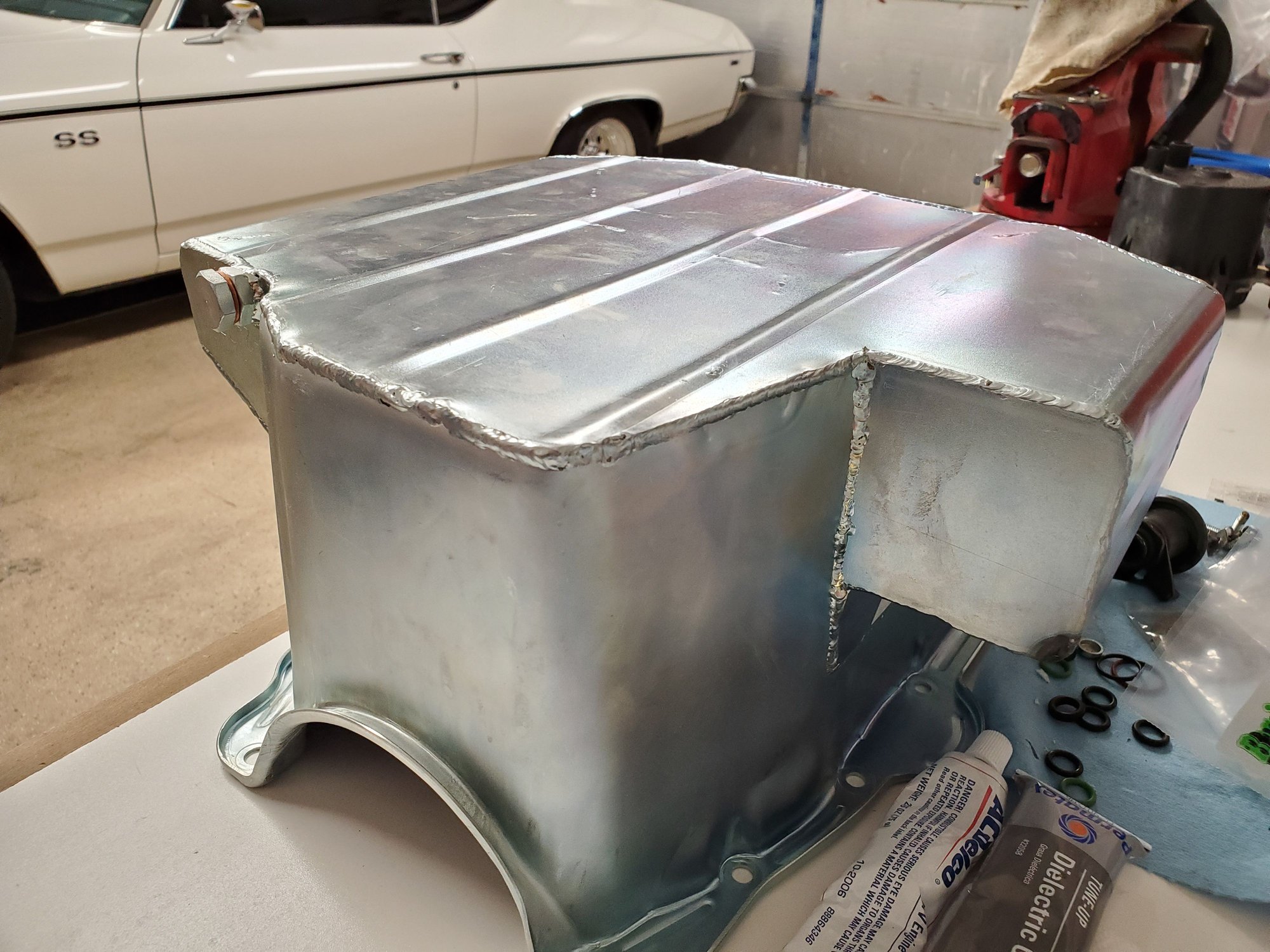

So the Canton Racing "Road race pan" was highly recommended as G-force related oil starvation seemed to be the most logical cause of my spun #1 rod bearing.
They sent the wrong pan the first time (2 piece seal version) delaying my install 2 weeks.
Now, one whole side of bolt holes are so far off I can't get close to installing the bolts:

Thanks everyone for the help. The 3rd pan arrived not much better than the previous. I was able to reshape it with a dead blow and 2x4's. I still had to tear drop 2 holes but got it on. I modified the OEM rail stiffeners which helped flatten the rail back down.

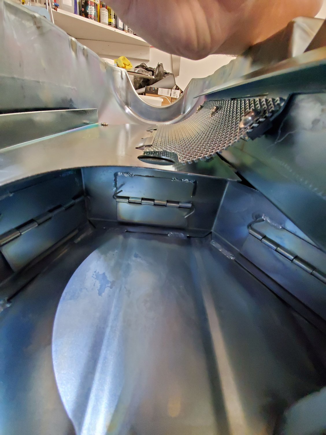

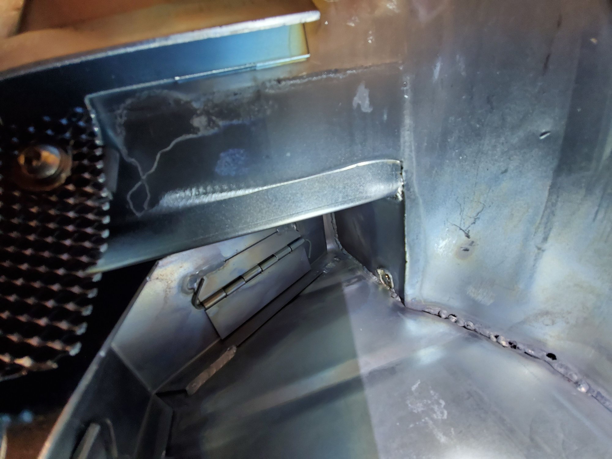

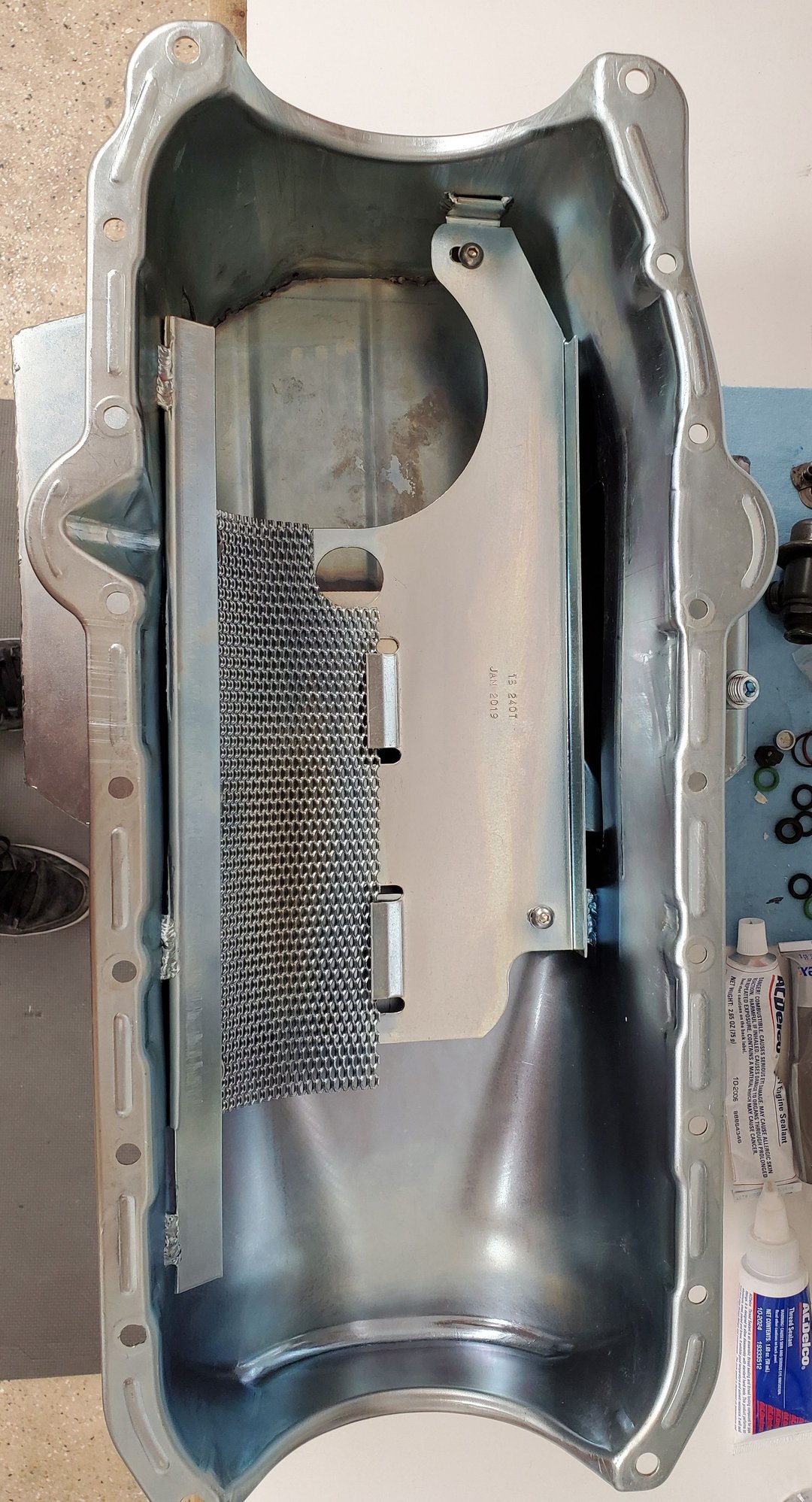

I'd heard that pan was a glorified drag pan. Got any pics of the innards? I've been road racing on a stock pan since 2013 with no issues, I just keep it full.
Old Oct 21, 2019 | 12:36 AM
Gen2-LT4's Avatar
Joined: May 2018
Posts: 144
Likes: 9
Come to think of it, I actually don't, but they are dragging their feet getting me an RMA# so I'll go take some right now of the first pan...

It has been reported before these pans, even with the baffling system, have been known to have windage issues especially with stroker cranks. Mine has this issue when filled up to its 6qt. Capacity. I always fill with 5.5 or 5.75 qts and it resolves the problem. I only like this pan because nothing had to be done to it to make it fit with the 3.875 crank.

I think people have had issues with using the built in crank scraper/tray. I am running a similar pan (the 244t, 3rd gen version) and took that stuff out in favor of a bent up factory tray. Seems fine.
