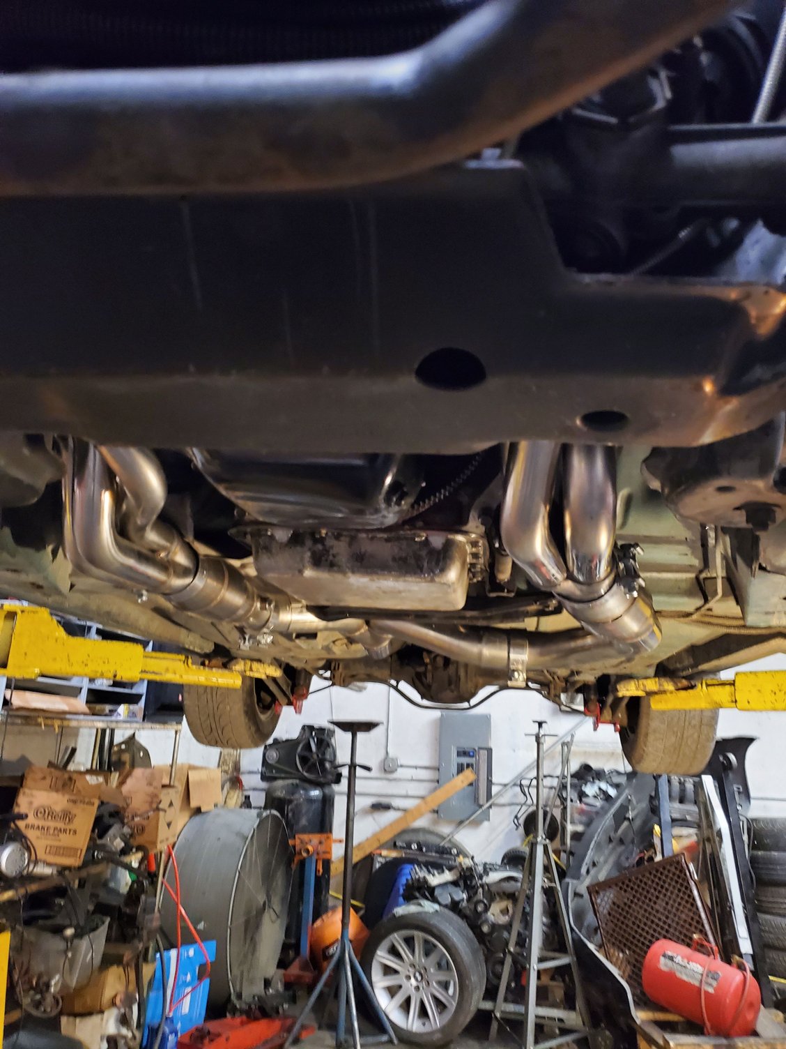

thus is how I did my cats, the passenger side can go right off the header which I’m told is ideal, but had to do the driver side further back to avoid interference with the frame

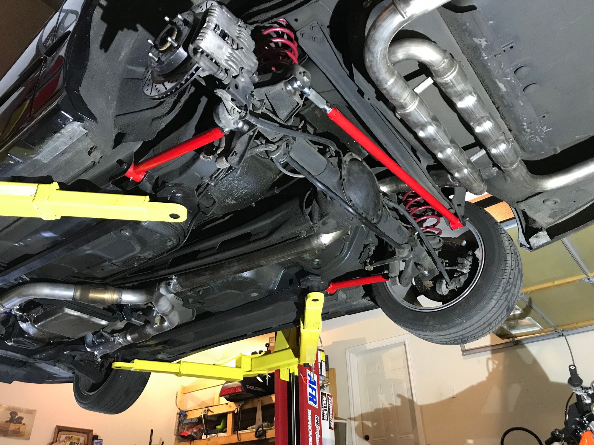

I bought the kooks catted y pipe mine are right off the header as well
Not my garage by the way. It's my neighbors I let him use my car trailer and he let's me use his lift.
It's still up on the lift if you guys want some more photos of position and fitment let me know and I'll go take some more.
