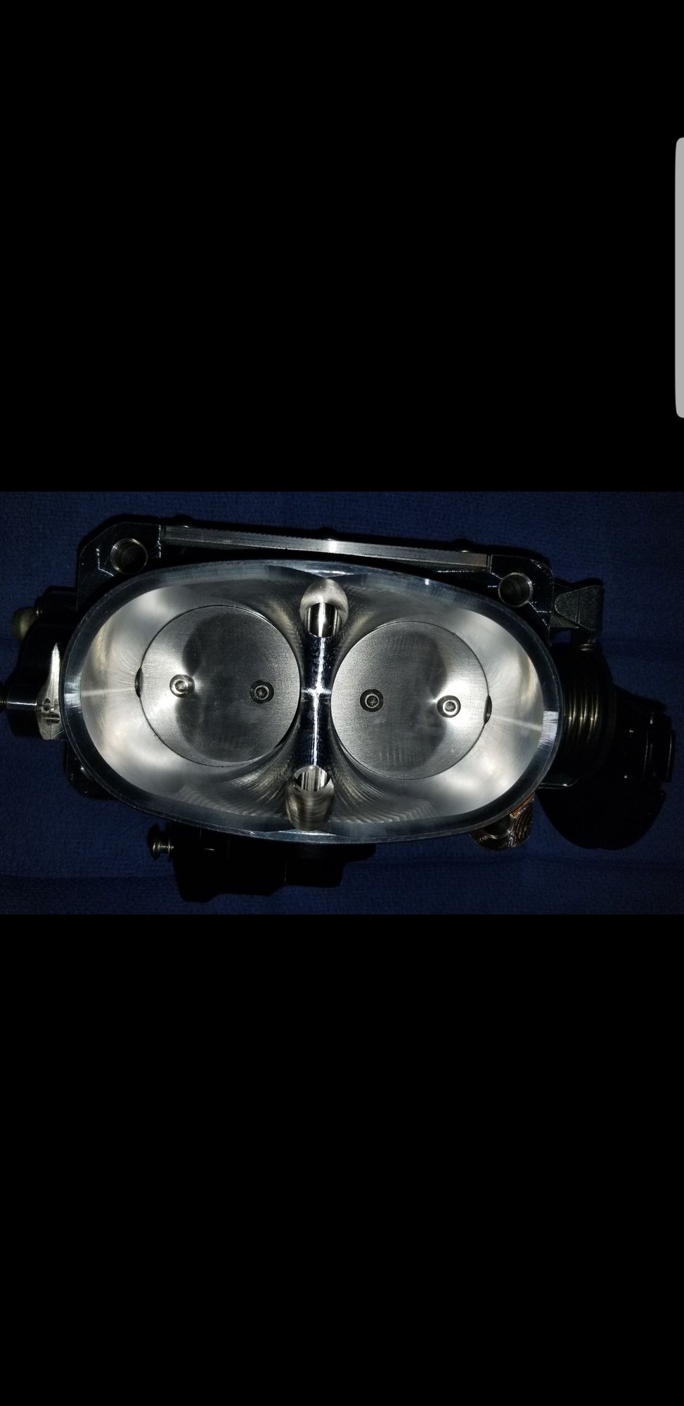

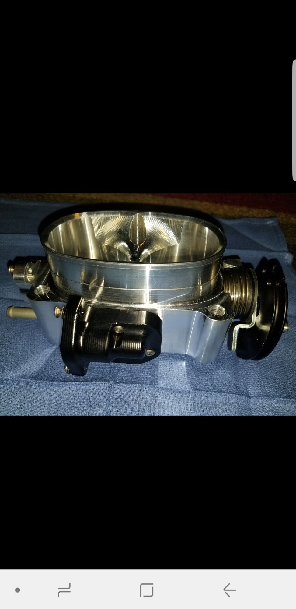

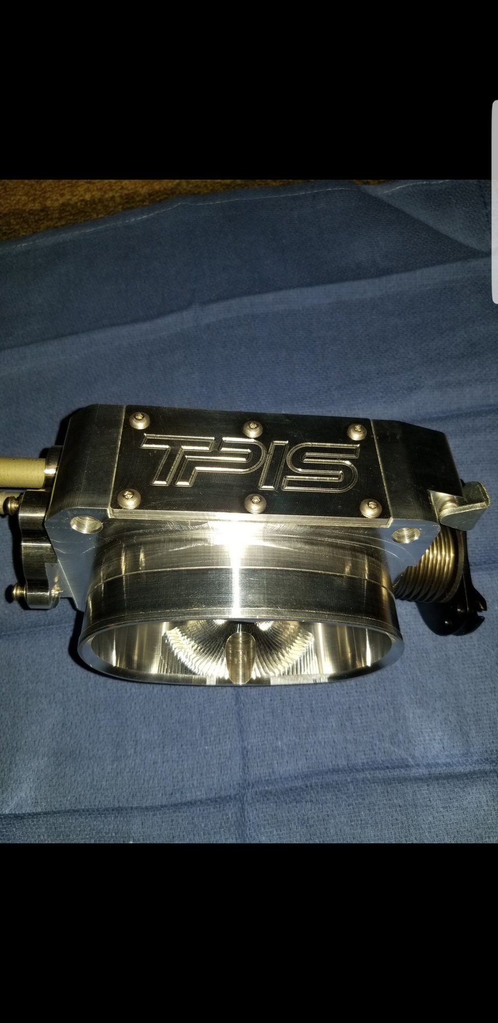

I really like my 52mm TPIS TB. Billet bottom piece to replace the ugly piece thats on the stock unit, the throttle blade shaft rides on roller bearings, and its got a built in airfoil. Nicest TB i have ever seen. TPIS units are known to not have idle problems.
But on a budget the stock 48mm bored to 52mm is an excellent choice also.
I plan on using my 52mm TB all the way to 600hp on a s/c 355.
