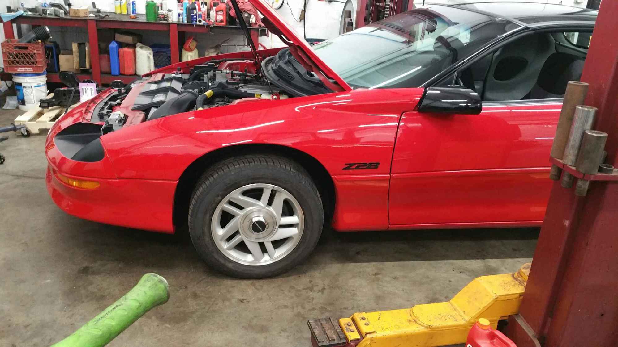

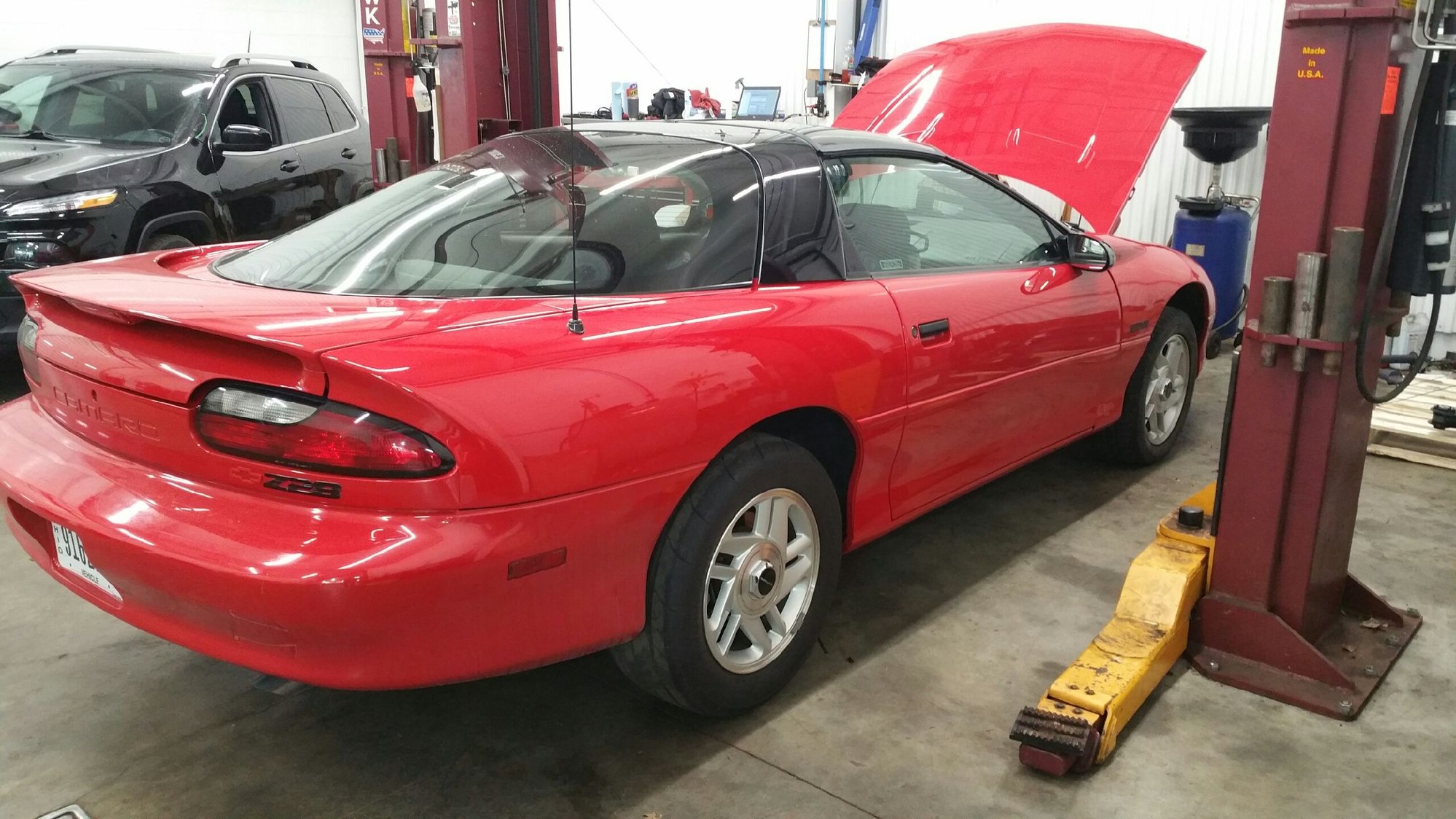

I literally just went through this earlier this year. I have a 94 Z28 that is just an occasional driver with 48k mi. I ended up going Bilsteins all the way around with 02 SS/WS6 springs (Moog 60116) up front and new rear springs (Moog CC635).
I can’t tell you how much better the car rides and takes bumps. It really is day and night. It went from an old to ride to a more modern ride.
