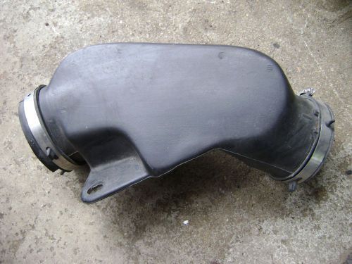

Just curious if a coupler from a non Ram Air car would work. Here is a picture for reference.
Whether it works or not that was great thinking. Looks like it might.

That may be actually be a common parts bin coupler - it looks like the one the stock intake on my '03 GMC Sonoma had. May be worth checking a scrap yard

I was in the shop this weekend and found this from my '03 Sonoma, 4.3L:
What's the diameter on yours? I should have measured the one on my car but didn't have time
