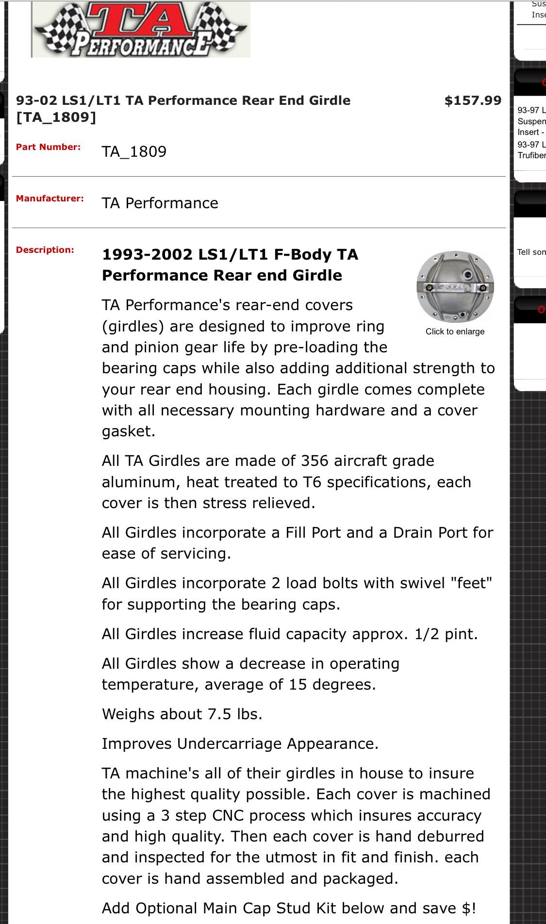

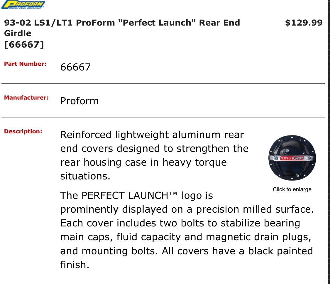

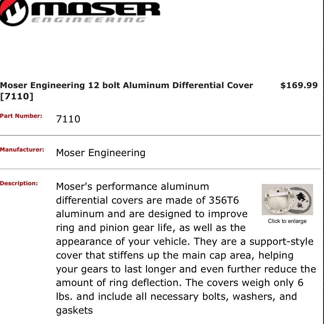

I did a full inspection of my car and the rear differential fluid needs to be changed. Figured I might as well change the cover.
Which one should I go with ? Does it matter ?
I found these three, I like the black one but that’s because of it’s looks. But is there one better than the other ?
Car is 94 Transam GT A4 65k miles. With lowering springs and shocks and other suspension upgrades done to the car.

I know that the TA one is made in Arizona, not sure about the others, I happen to have the TA and like it but I doubt there's much if any actual difference between them functionally.

I have the TA performance differential cover on 2 of my Bird's. Just be aware they are slightly bigger than stock and may not clear an aftermarket rear sway bar.
