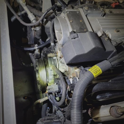

Hi, I am following up on my post. I found a vacuum leak to my egr valve. I assume that iswhere the - 32 - Exhaust gas recirculation (EGR) solenoid. - Cause: Wiring, poor connections, EGR valve, ECM error code originated.
I replaced the hose and my vehicle has not stalled or given me any error codes since replacing the leaky hose to my EGR valve. If it acts up again, I will edit this post to reflect that. If not, consider this issue resolved.

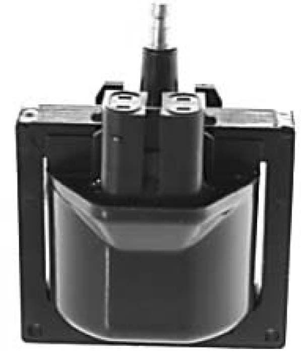

I found the problem. It was a bad coil. It is not always the opti-spark. $30.00 and back on the road. Diligence pays off.
