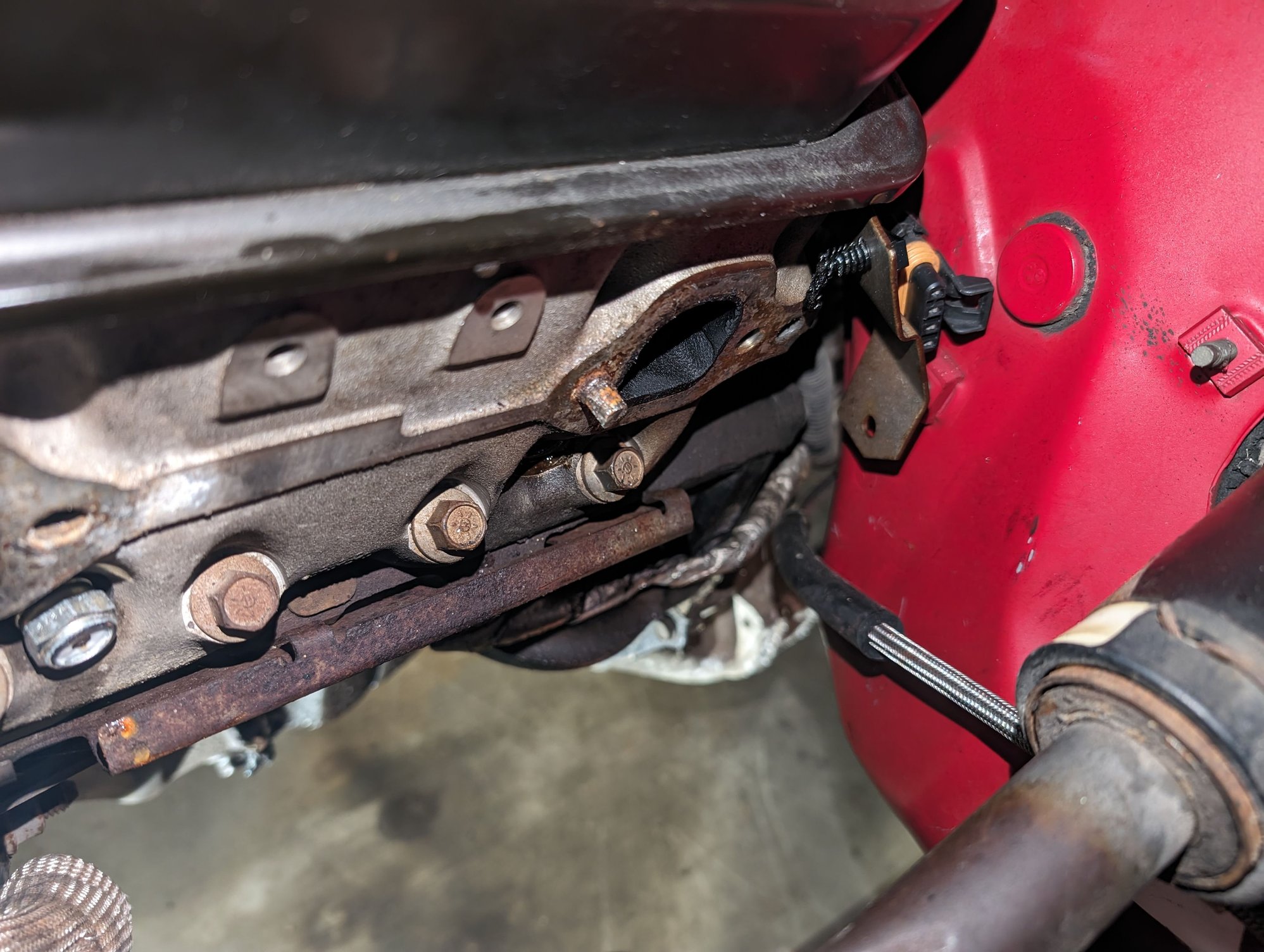

Got a broken exhaust manifold stud in 96 LT1 head. Only have MAP and butane available, but im being paranoid about the aluminum head. Have tried heating just the stud, but not working. Can i heat up the head directly or am i going to warp it with the handheld MAP torch?
Head still installed in the car, driver side #8 cylinder of course. Second to last bolt snapped. 1/2" or so of stud to grab with vice grips, hasnt worked by just heating the stud. But i also haven't gotten it red hot or tried the MAP gas yet, just being paranoid about the head for some reason. Is my paranoia founded or am i just being chicken?
Stud.

Definitely soaking it with PB blaster. Got a little bit to grab with vice grips, but so far it's just chewing up the stud. But i haven't been getting it hot hot because i didn't think ut was needed. But now that its not budging, i think i need to get it almost red hot but started making myself worry about warping the heads and now im all being a baby about it. I dont have a right angle drill, but do have a grinder and Dremel. So i could go to tap it out i guess, but real cramped area and all.
​​​​​​IM just thinking i need to heat the base of the stud more where it meets the head, just concerned ill fudge it up. Dont have the funds for a head job. Just need the headers on then y-pipe fabbed up and she's on the road.

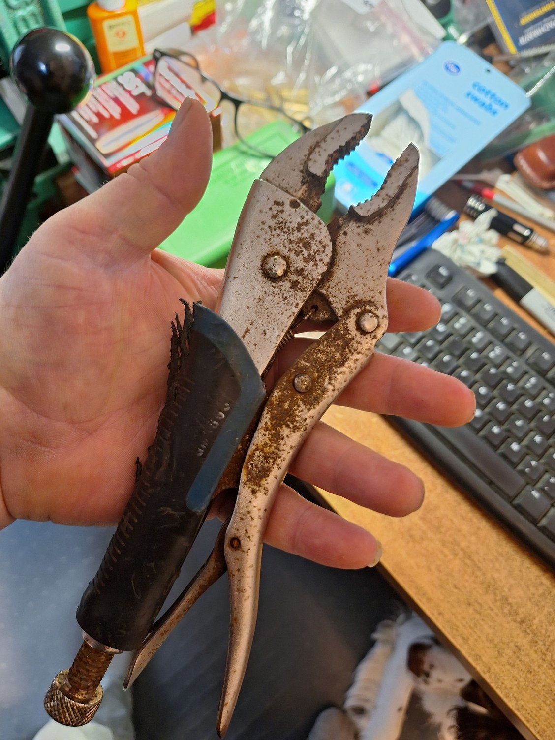

The vice grips shown in the picture looked too small for the job and the use of a bigger set would work much better but either way there's plenty of good advice given to remove the stud. My guess is that OP has already removed it by now.
Those were the first pair i tried. I bought a bigger pair, but its just the next size up. Maybe the large size would put more force on the stud? And no, have struck out every attempt.. just been super busy and forgot to come update the post.
Ones in initial picture are mini.

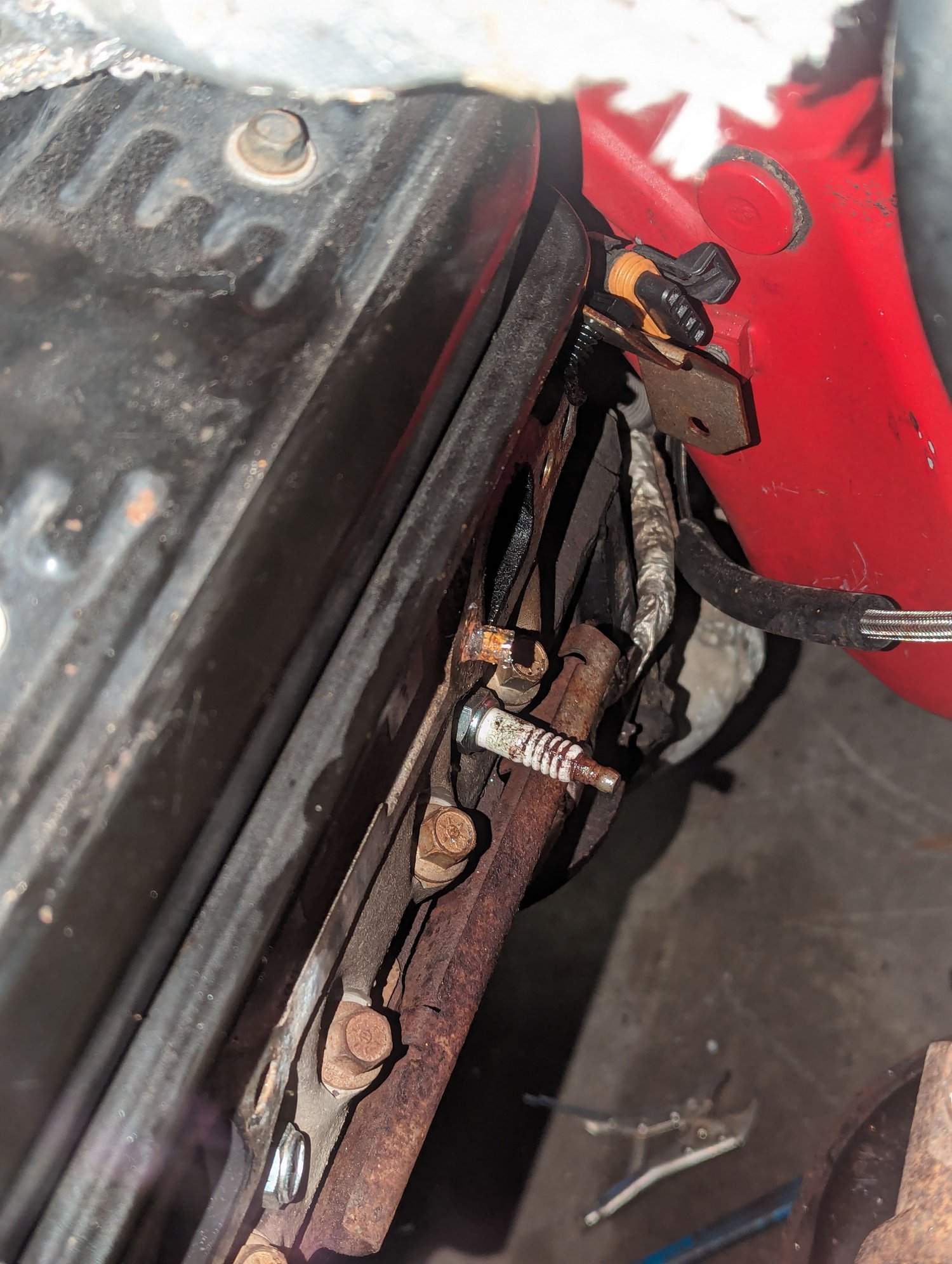

Im just pissed at it now.
Still got this eyesore as well. Ha!

Im gonna see if someone at work has a welder. That should work, i got all the drill bits and taps needed to rethread it, just dont have a right angle drill, would have to remove steering column to get my drill in there.
Gonna get a big pair of vice grips. Maybe even grin some flats into it, that might help prevent it from rounding off. Or at best, break it flush maybe? Ive had this happen twice before, but both times car was on a lift and still warm from driving earlier in the day. So those came out with minimal effort. This one had been sitting for awhile before i even bought it, and its almost been sitting in my garage for a year. 7ish months now.
