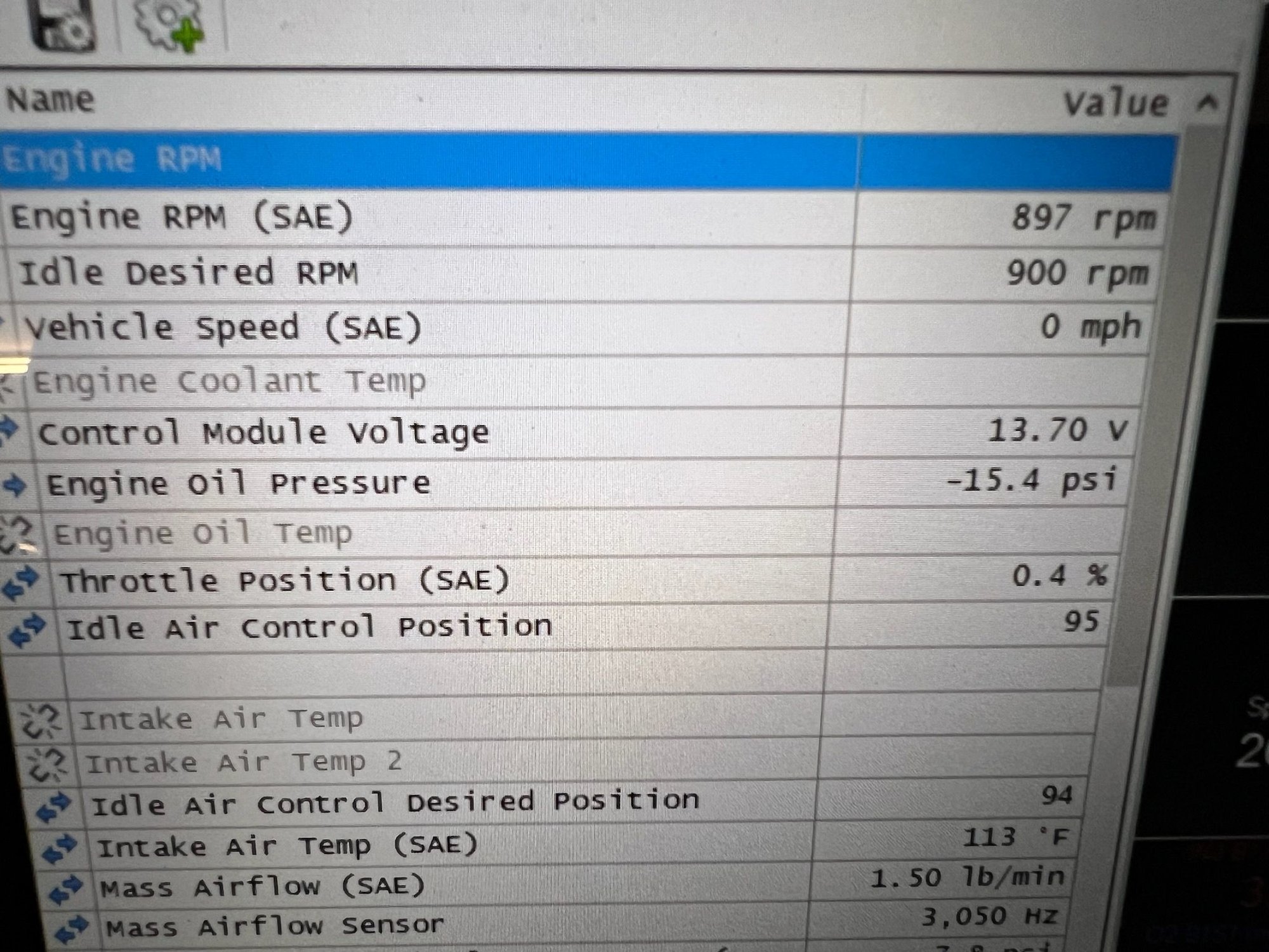

Old Aug 1, 2024 | 08:18 PM
Sophia_LT1's Avatar
Joined: Jan 2022
Posts: 20
I have an update. I've been driving the 383 for the past few weeks on and off; the idle issue has only appeared 1x since drilling a 1/8" hole. This is a noticeable difference from before the hole.
Below are the IAC counts from a data log. They ranged between 90-100 (95 in picture). Im going to drill a little bit bigger hole and test again; I think I am shooting for counts in the 35-40 range. I think it is on the right track though!

RGSS's Avatar
Posts: 303
Likes: 11
You could also adjust the throttle stop to open the throttle body blades and lower your IAC counts. Watch for the TPS voltage though.
Old Aug 10, 2024 | 02:08 PM
BALLSS's Avatar
Joined: Apr 2008
Posts: 4,985
Likes: 112
You can slot the screw holes on the TPS to "rotate" it to get the volts right. IMHO kinda a hack way of doing it
Best to dill the size hole you need but take BABY steps as 1/64 bigger makes a good drop in !AC counts. IIRC mine is 11/64 on my 383 but my TB is a stock rebore to 52. Never drill without being able to monitor IAC counts at each step
Old Aug 10, 2024 | 07:56 PM
Sophia_LT1's Avatar
Joined: Jan 2022
Posts: 20
I appreciate that! Im going to do a 9/64" hole next, then Im gonna data log again. I just havent had time and the weather has been junk lately. Im working it in baby steps; the 1/8" hole helped a lot so far! I don't think I need much more.
