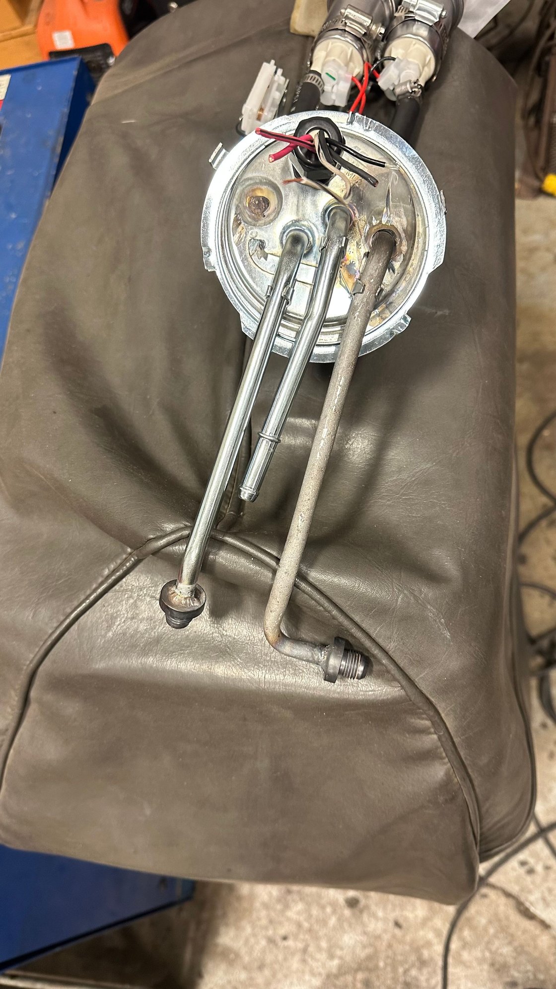

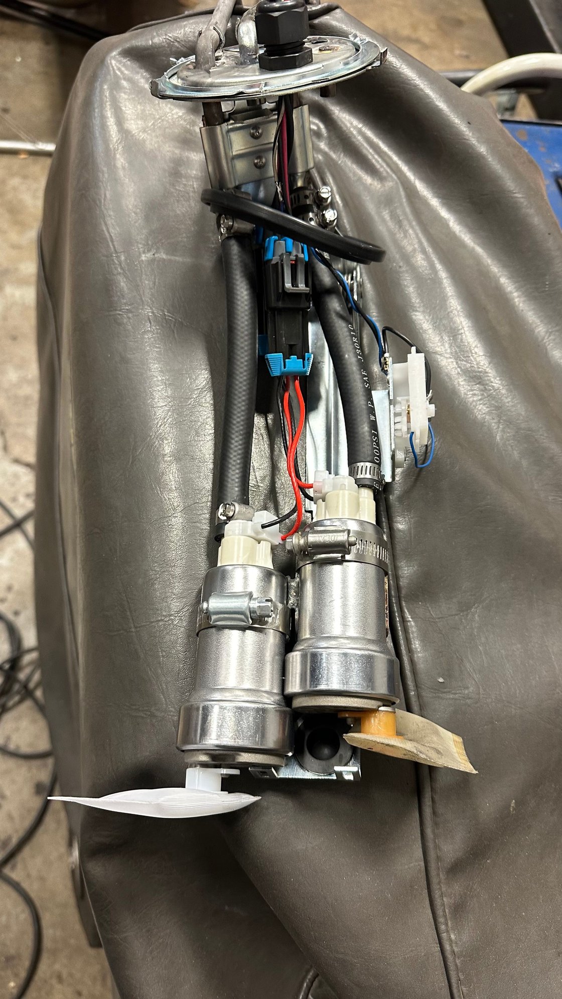

I ended up fitting a Aeromotive 340 pump into the original hanger and bucket.
Thanks for all of the great ideas!
