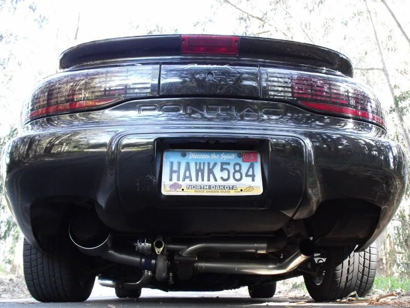

Originally Posted by SnakeEaterTA
Aside from his being an LS1 car you are exactly right. Engine itself was completely stock. He may have had some longtube headers but again it just didnt really pickup until the upper rpm range.
My friends LS/ss'camaro with the same t67/.81 innercooled sts made 530rw with a custom cut cam. On race fuel and forged internals Leading Edge Performance who built our cars maxed his out at about 680rw.. its definitely a capable setup but the motors got to be built for it. Guess all thats in the past now 😞

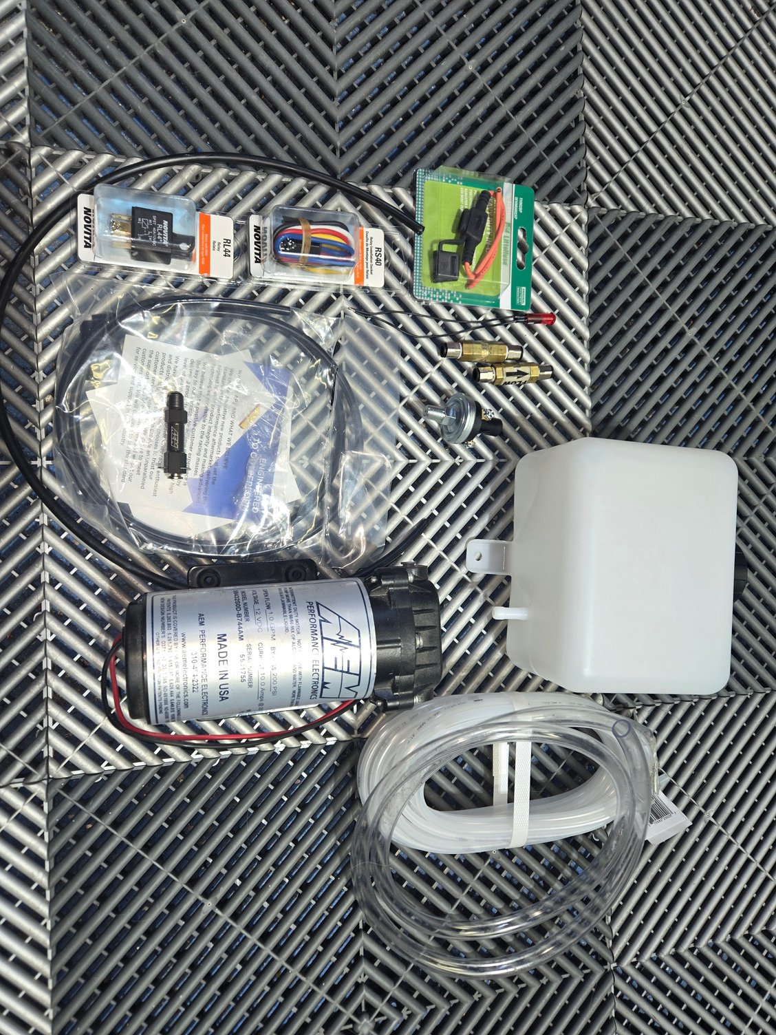

Default Update
Because water meth systems have become so expensive i decided to make my own sourcing parts.  This is a fraction of the cost of a new kit and has the important parts where it matters most.  Will turn on at about 5psi boost.

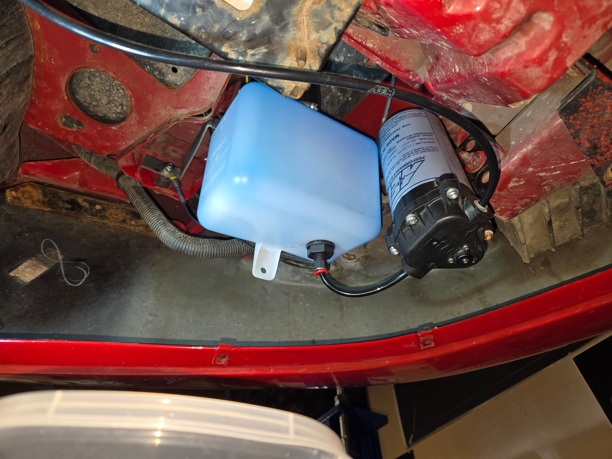

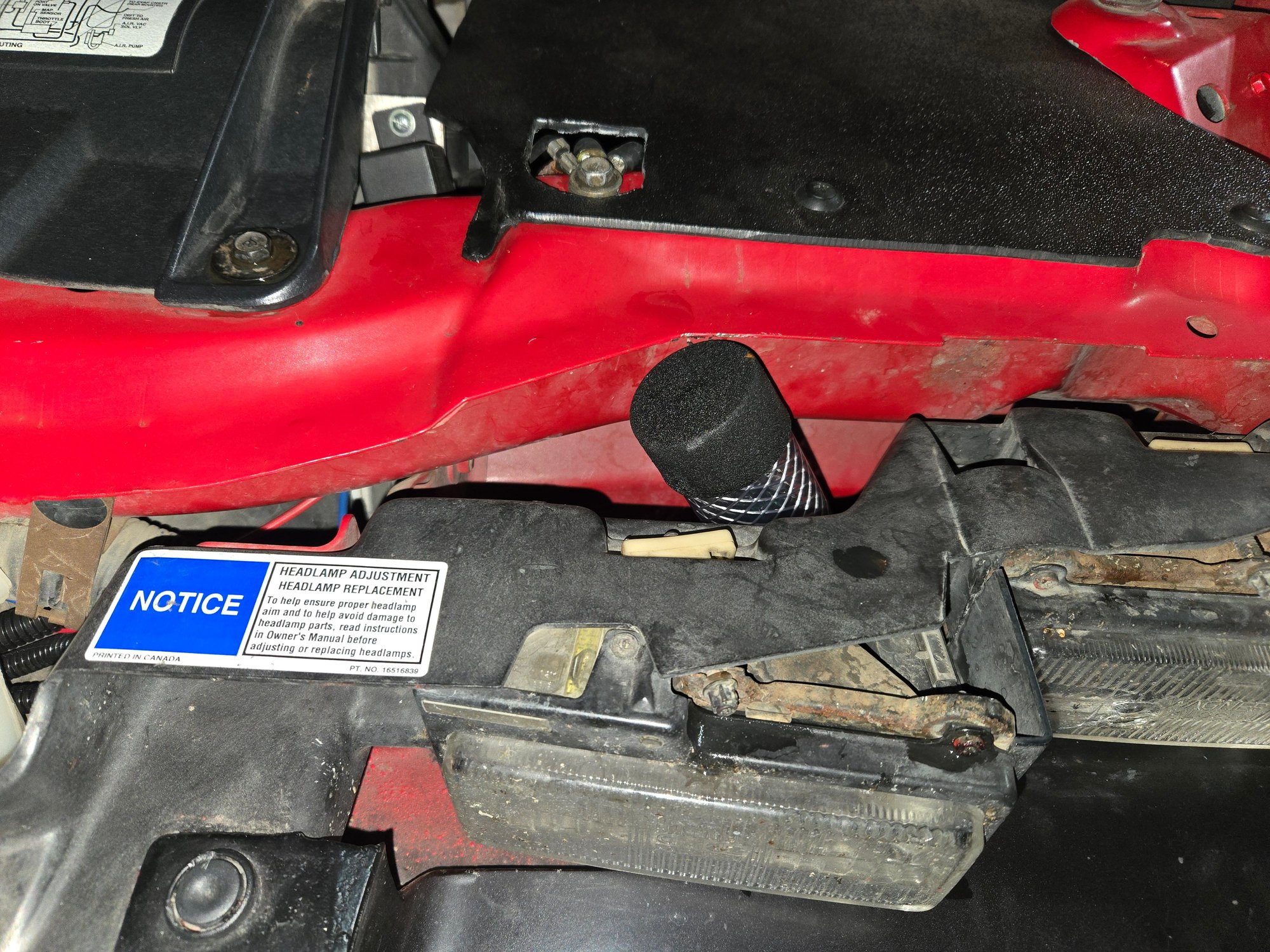

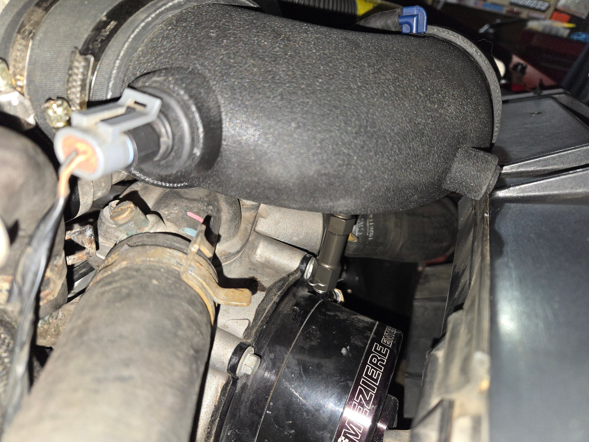

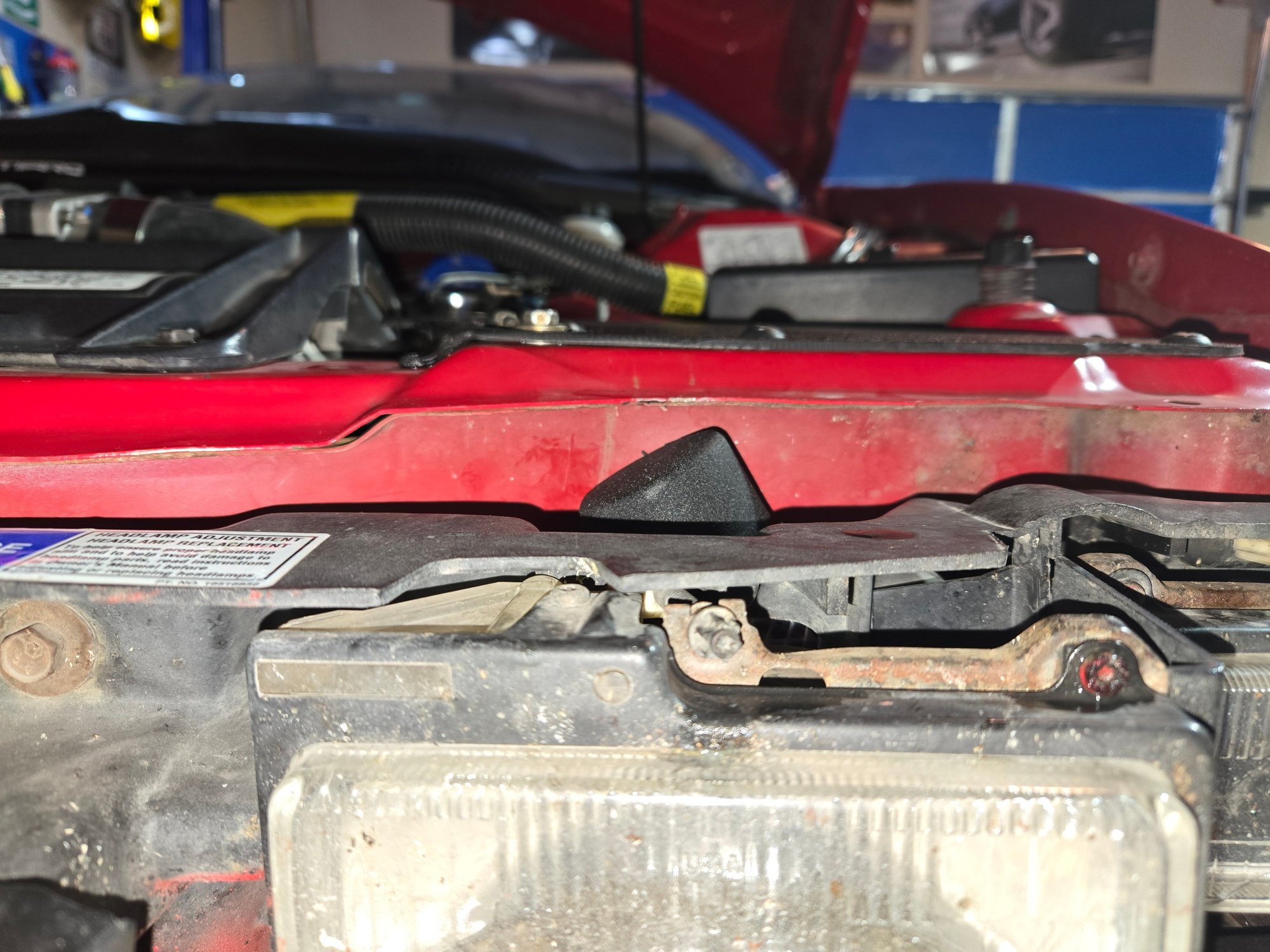

Aem v3 nozzle
Aem v3 nozzle
Fill barely visible
Fill barely visible
Different angle of fill tube
Tank and pump mounted near turn signal underneath car.

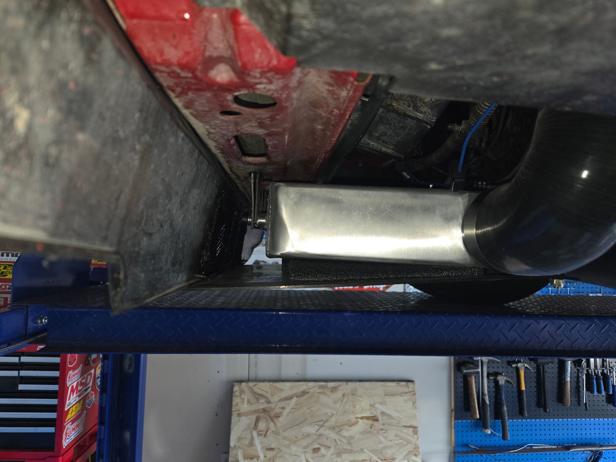

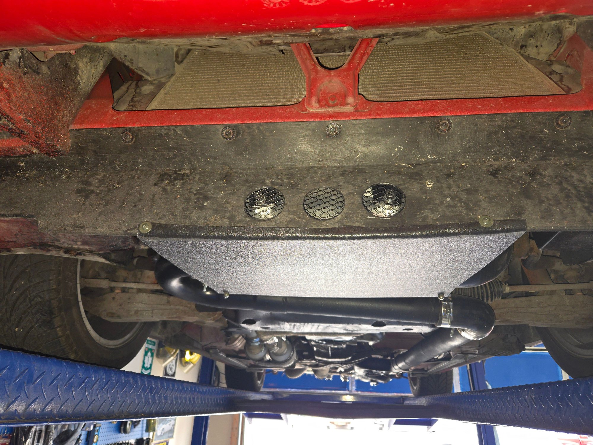

The intercooler closed in the plastic plate i made.   A few holes drilled in the splash gaurd with mesh epoxied in to keep rocks and debris out.  This works very good at cooling the intake charge
