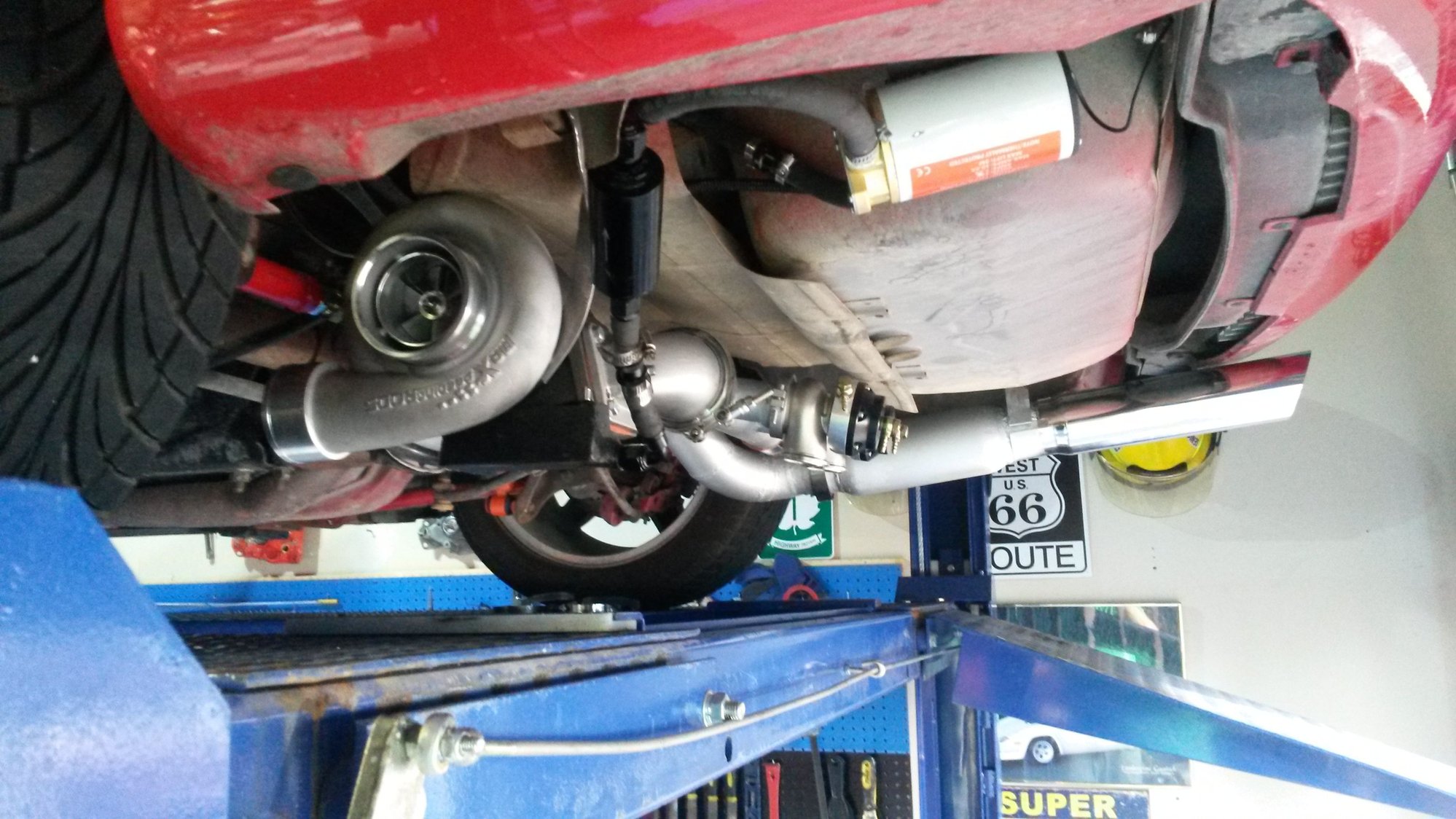

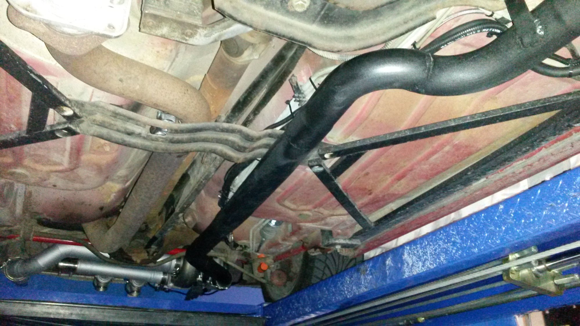

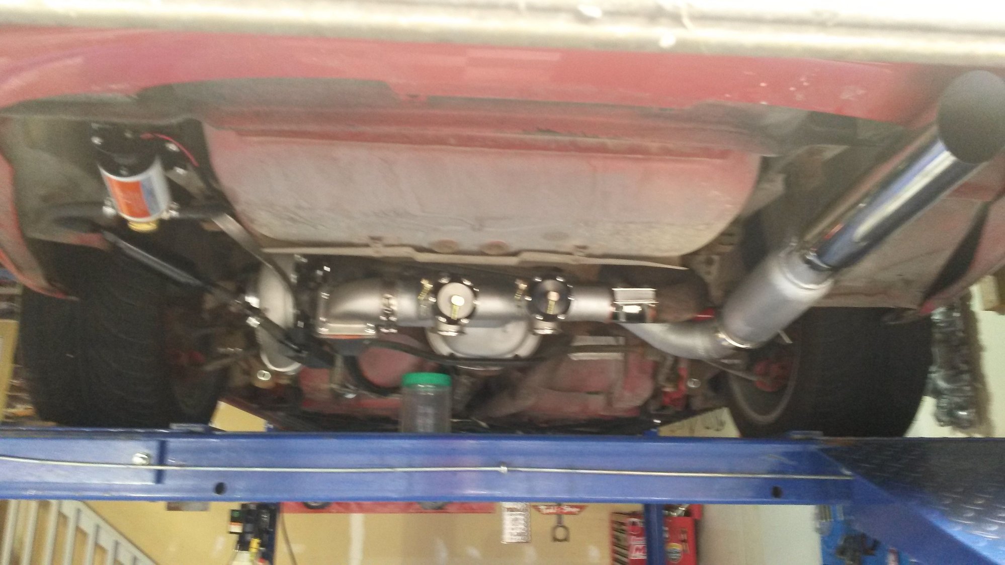

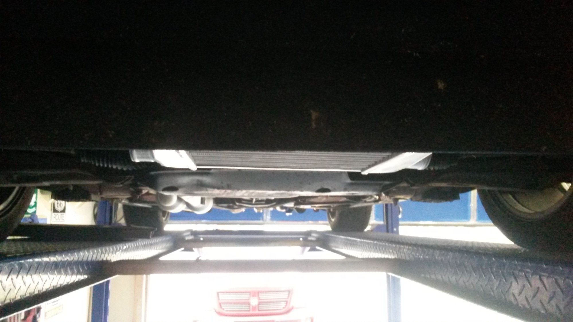

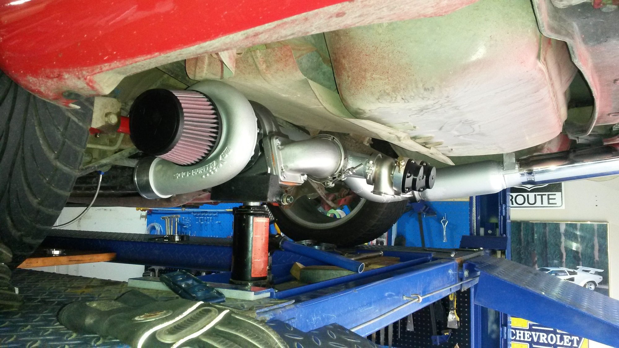

Here are some pics of my current project. I ran it a bit in the fall before the snow flew and it seems to boost up pretty quickly. Still some things to do but its getting there.
Lots of ground clearance

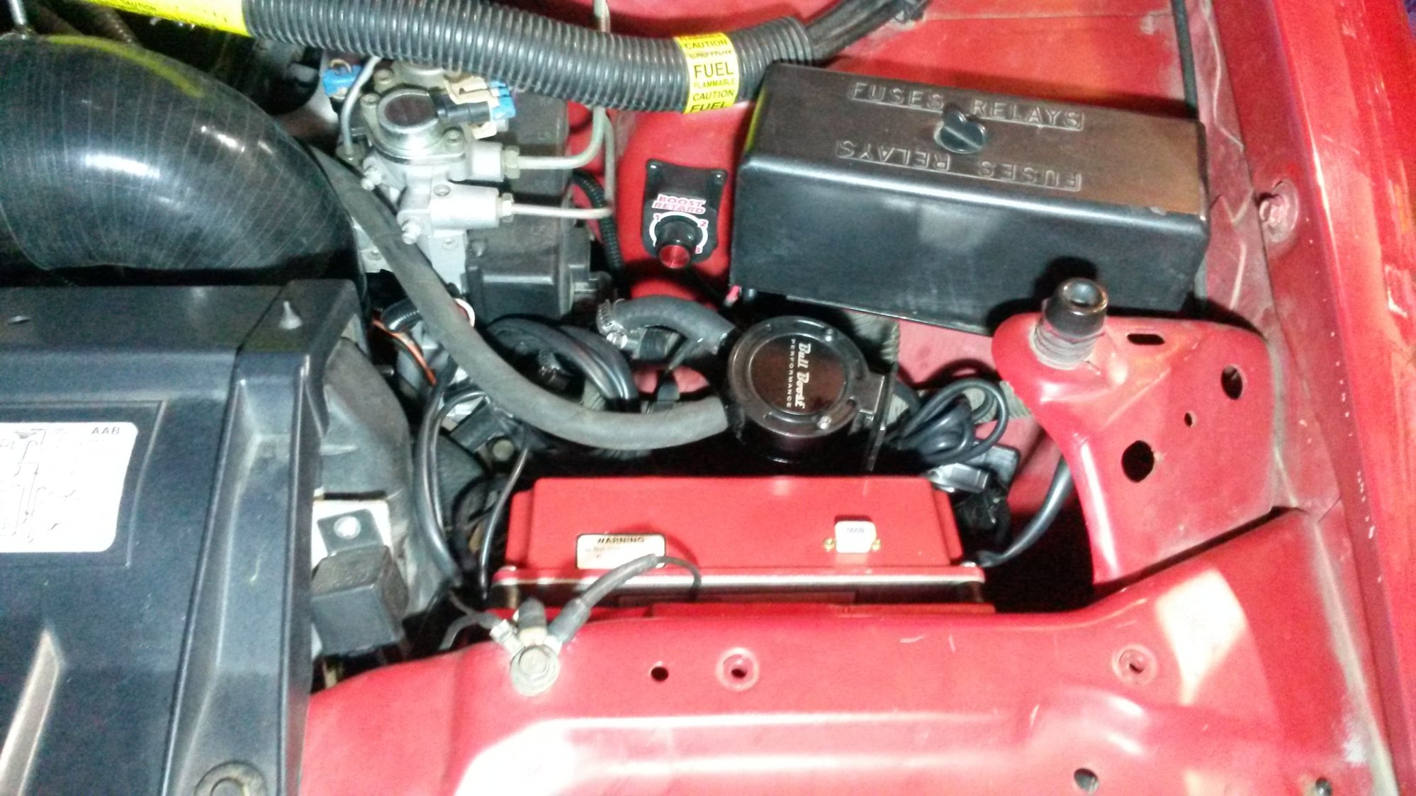

msd 6btm

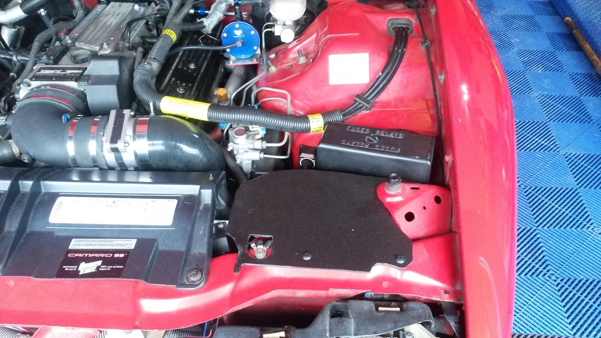

msd 6btm, and catch can. Made a cover for this so it looks cleaner just not in this picture.

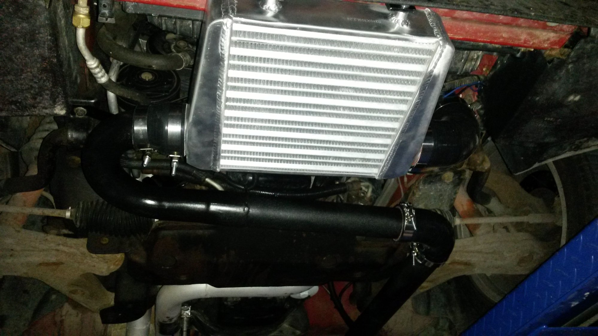

intercooler mounted so front cover didnt have to come off.
intercooler mounted so front bumper cover didn't have to come off.

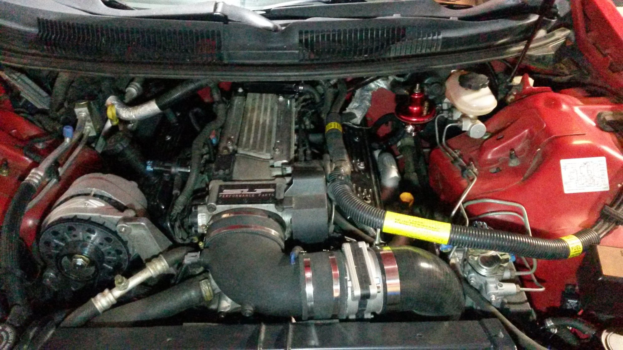

The fmu can be seen in the engine pic its just not hooked up yet.

how is the clearance under the K member?
Old Dec 20, 2024 | 05:06 PM
stingr's Avatar
Joined: Oct 2007
Posts: 286
Likes: 18
It goes no lower than those high flow cats on the other side.

If you can, probably be wise to move the gate to the elbow right before the turbo.
Old Dec 21, 2024 | 01:16 PM
stingr's Avatar
Joined: Oct 2007
Posts: 286
Likes: 18
I ran a setup like that one time. The reason I run two gates is because of how I set these up. I found when i did it the way you are suggesting in the past on a rearmount setup I had to run a crazy high spring pressure in it to keep it from opening to early. With that said I also ran a smaller a/r on the turbine at that time. This seems to work better overall in this setup.

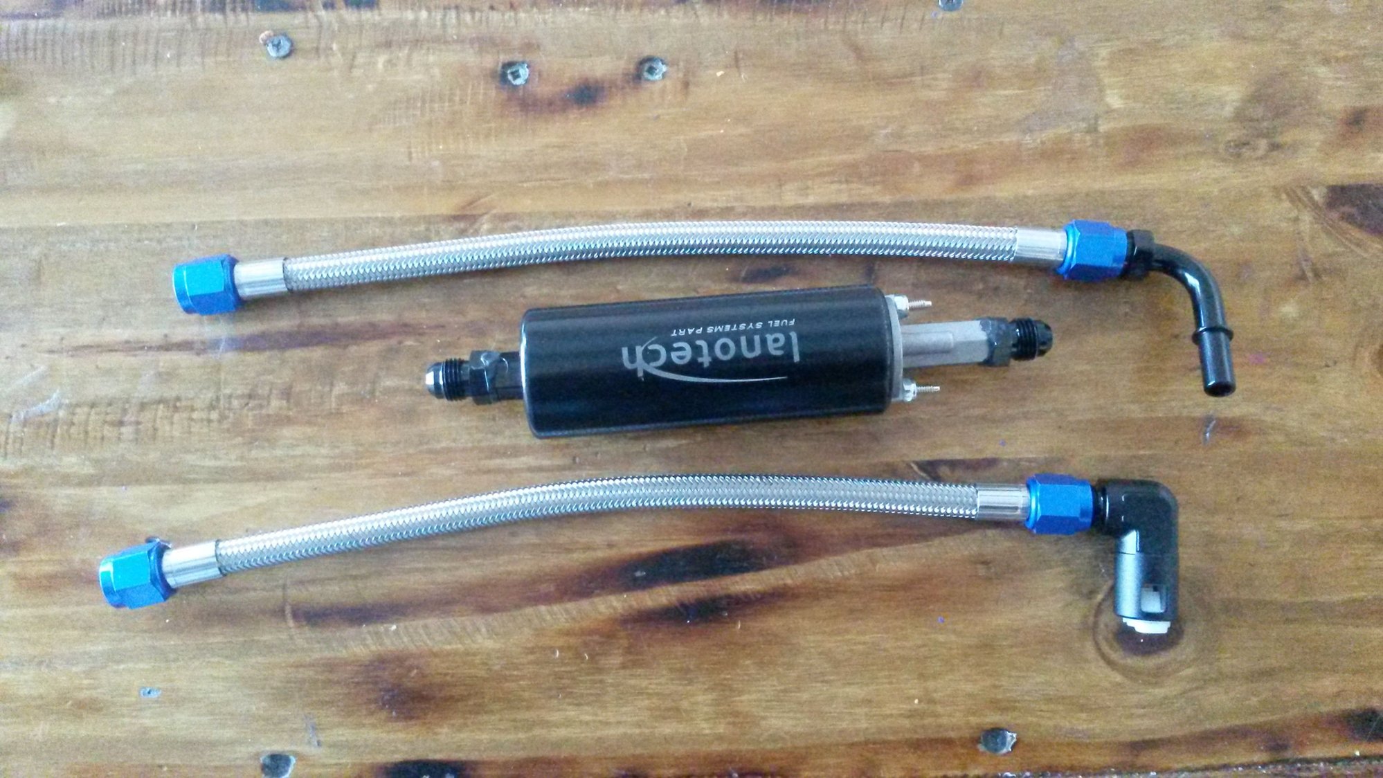

here is a pic of the cover I made and also the vortech 6:1 FMU
255lph inline walbro style pump with fittings and lines to attach it inline before the fuel filter

I took the car out for a quick drive today to burn in the exhaust wrap I recently put on. It felt really strange and doggy. The car made no boost at all. I got it home and check for lines that maybe popped off. I pulled the air filter on the turbo and the wheel is completely frozen stiff. I'm betting a bearing failed. Whats weird and sad about this is this turbo doesn't even has 100miles on it and it has plenty of oil going to it. It boost great in the fall when I put it away. I know its a cheap turbo and I've used cheap turbos before but wow this is really disappointing on how sort lived this one was. At least it was cheap!

just an update I told maxpeeding rods what had happened and after a few pics they sent me a new turbo. Great customer service. Based on how I was treated I'd say the service is as good or better than any automotive companies I've dealt with

Youre more brave than I. What size turbo? That intercooler setup, did you ever scan for temp readings? I'm trying to picture the angle you could max tilt it for best cooling. But that location wouldnt work here in PHX. Where are you located?

the turbo is a 67/75. If I remember correctly but I could be off on that without having it directly in front of me. Ya in Phoenix that might not work with an air to air. However in Alberta where it rarely hits 35c in summer I'm not to worried. I only ran this a bit in the fall before we got 3 feet of snow on the ground so I haven't data looked at all yet.

the turbo is a 69/77 If I remember correctly but I could be off on that without having it directly in front of me. Ya in Phoenix that might not work with an air to air. However in Alberta where it rarely hits 35c in summer I'm not to worried. I only ran this a bit in the fall before we got 3 feet of snow on the ground so I haven't data looked at all yet.
