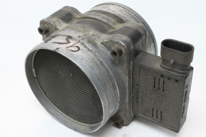

This problem can occur when the honeycomb piece is removed from its upstream position relative to the MAF.
The honeycomb is there to smooth the airflow as the MAF can get confused by air turbulence. I know it looks like it is nothing but a flow reducer, but it serves an important purpose. I believe reinstalling the honeycomb will correct the problem.

Is this the honeycomb filter in the MAF itself or is there an additional in the Intake?

It is part of the MAF, and is located just upstream from the element that measures the airflow. You can see it in the attached picture.
It is secured by a circular clip, and is often removed in the name of increasing airflow. Some cars seem to tolerate its removal, others do not.

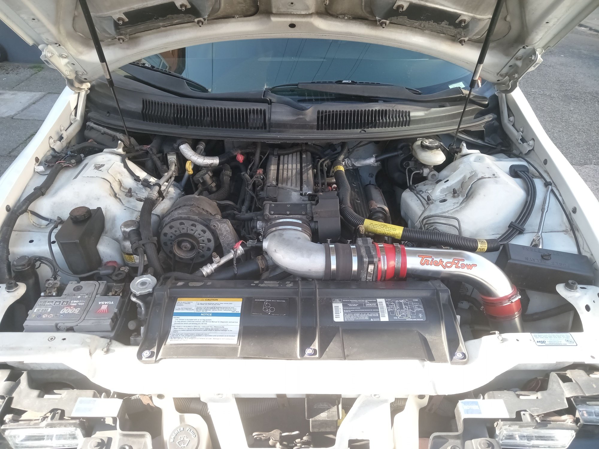

Ahh I've left mine in.
Thats the cold air setup I have, may not make a difference but the car is in here UK not the states.
