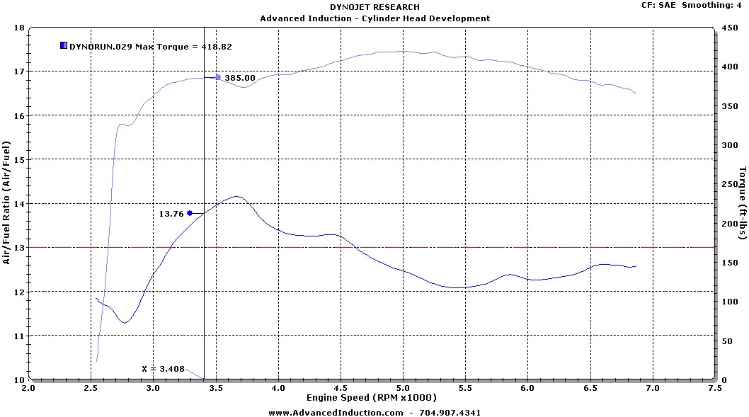

I don't know about the SP conversion. I did well with the stock ported intake.
http://www.advancedinduction.com/Dyn...55-RPM-SAE.jpg
Here is a graph of my torque curve Vs. A/F. If not for the early lean spike it would have gone over 400 RWTQ much sooner than it did.
http://www.advancedinduction.com/Dyn...355-RPM-AF.jpg
My intake was $425 from AI. I know the SP conversion is well over $1,000
My set up is designed to safely rev to 7600-7700 RPM. My only limitation is the stock PCM, but I will have a F.A.S.T. ECU installed very shortly. I know that Rick Abare (another AI customer) revs well ino th 7000 RPM range and we have the same intake.
Turbo_6: Your cam is a lot bigger than the one I have and you have ported AFR 220's. You definately need to ditch the stock computer, and get it in the "sweet spot". I am sure you will make power to 7300-7400.
I don't agree with your statement about loosing 30 RWHP with an LT-1 intake because of heat soak. I tried to heat soak mine on the dyno so I could get a feel for the real world performance and I never lost more than 5 hp.
I also don't agree with the fuel distribution "issue". Consider this... the fuel injectors are directly infront of the port on the head. I don't see how the fuel will "fall out of atomization" in that short of a straight distance. I could see this if the fuel was injected at the TB inlet, but it's not. I am not a professional, I could be wrong on this, but I just have not seen any evidence to show otherwise.
