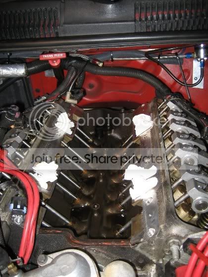

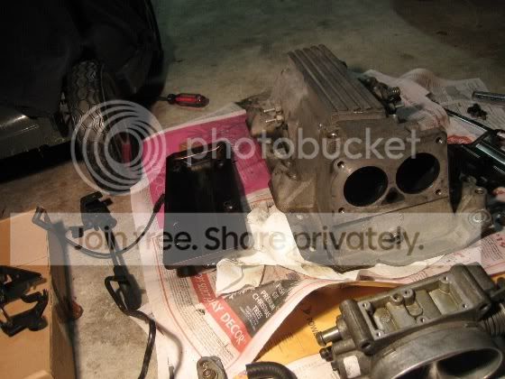

The car has been sitting since I ordered the new GMPP Lifter Kit and Gaskets. I decided to be proactive and actually pass the time (sucks without having a car) by doing something somewhat useful until the parts got here.
So the lifters came in the mail today -- so I've got them soaking. I'm going to try to get everything installed and start buttoning it back up tonite.

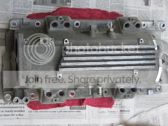

I decided to join the 'Rattle-Can Brigade' and paint a little bit on my intake manifold. I also did my best to do a thorough cleaning of everything while I've got it apart.
Here is the motor as it sits now. I haven't pulled the lifters yet, I'm going to tackle that after dinner.

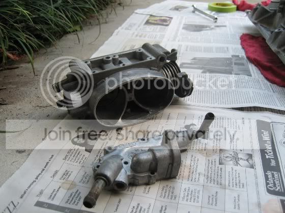

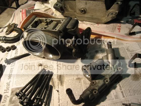

Here is the intake off the car and throttle body before:
And here is the intake and throttle body after:
A close up of my red hot painting skills:
And decided I might as well throw on the EGR blockoff plates while I've got the intake off completely:

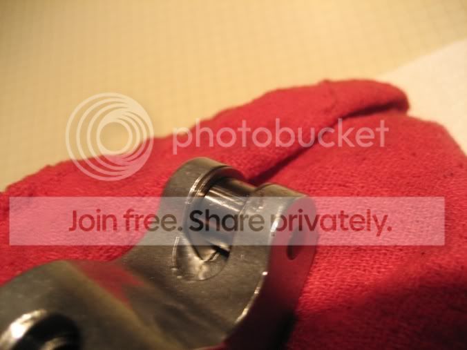

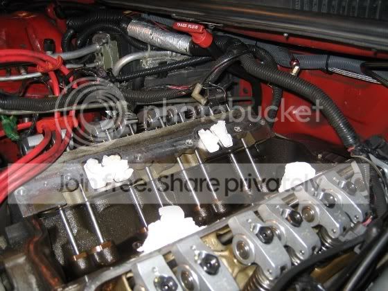

So I got all of the lifters back in, all of the guides and guide retainer (spider) back on. The guideplates for the pushrods are back on as well. When I was putting the rockers back on -- I found something. I'm thinking this might be the culprit. Opinions?

Originally Posted by 96slow6
i could see were that roller would squeek. my concern would be how did it jump off the valve seat enough to pitch side ways and bined hard enough to do that? Was it way loose?
I was having noise from the rear passenger side that I was intending on readjusting to zero lash. At this point, I think that it is possible.
So now, I did some googling on GM 1.6 Roller Rockers (because I've got the LT4 Hotcam Kit). There was a recall on the roller rockers on the '96 LT4 Vettes and they replaced them with GM Part # 12557779. Which is actually individually priced 1.6 Roller Rockers.
Does anyone see why this wouldn't work with mine?
